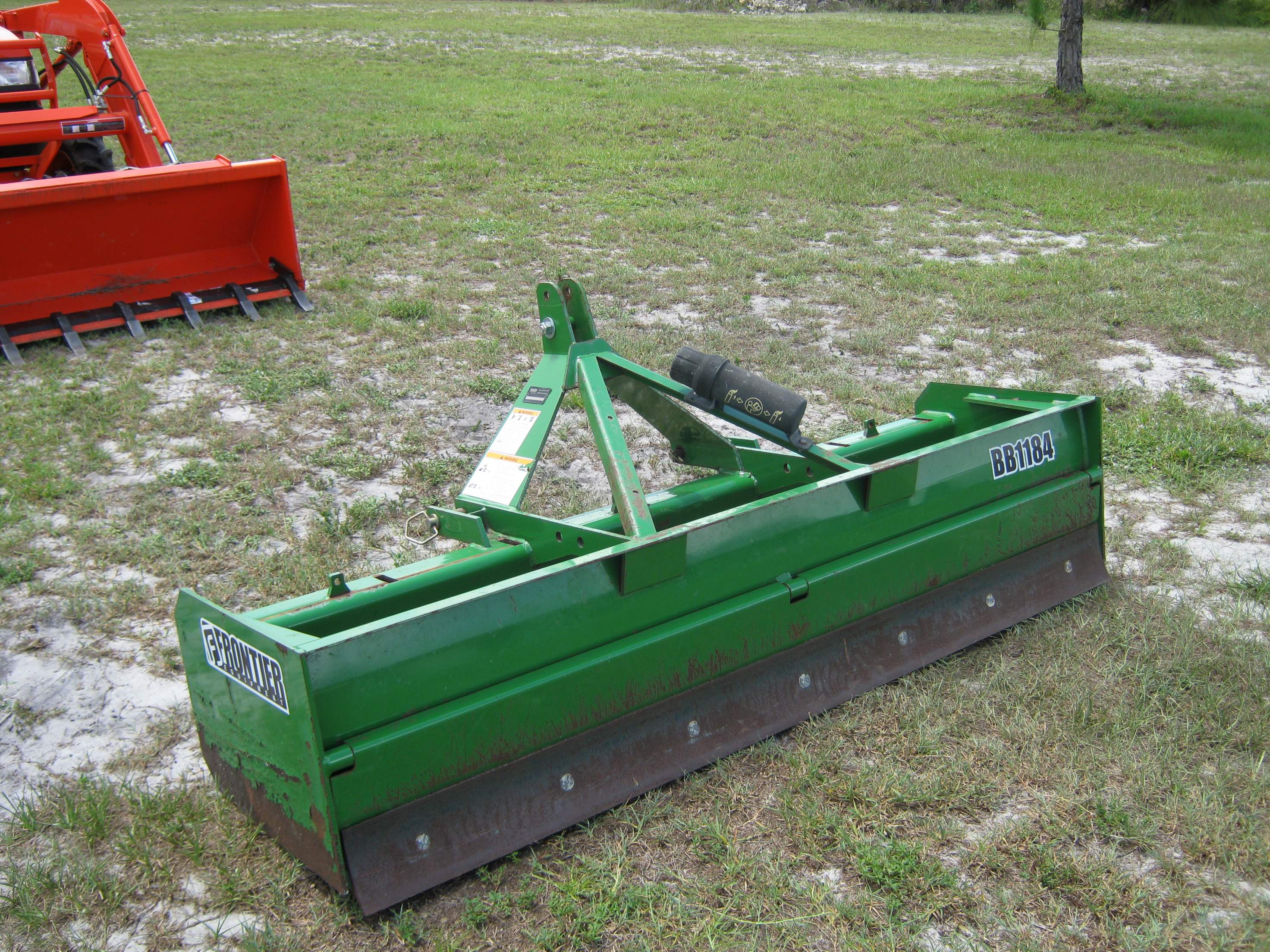

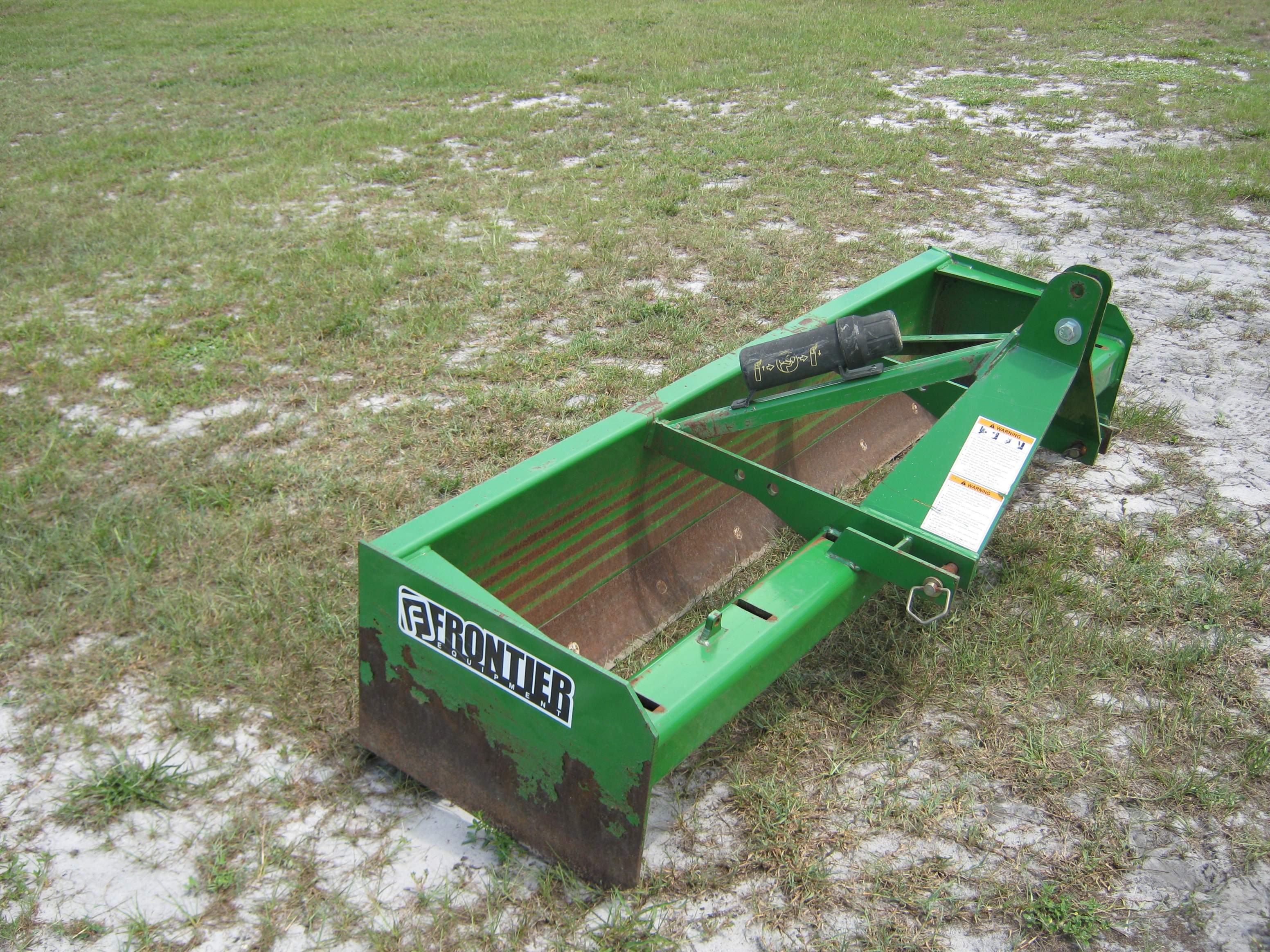

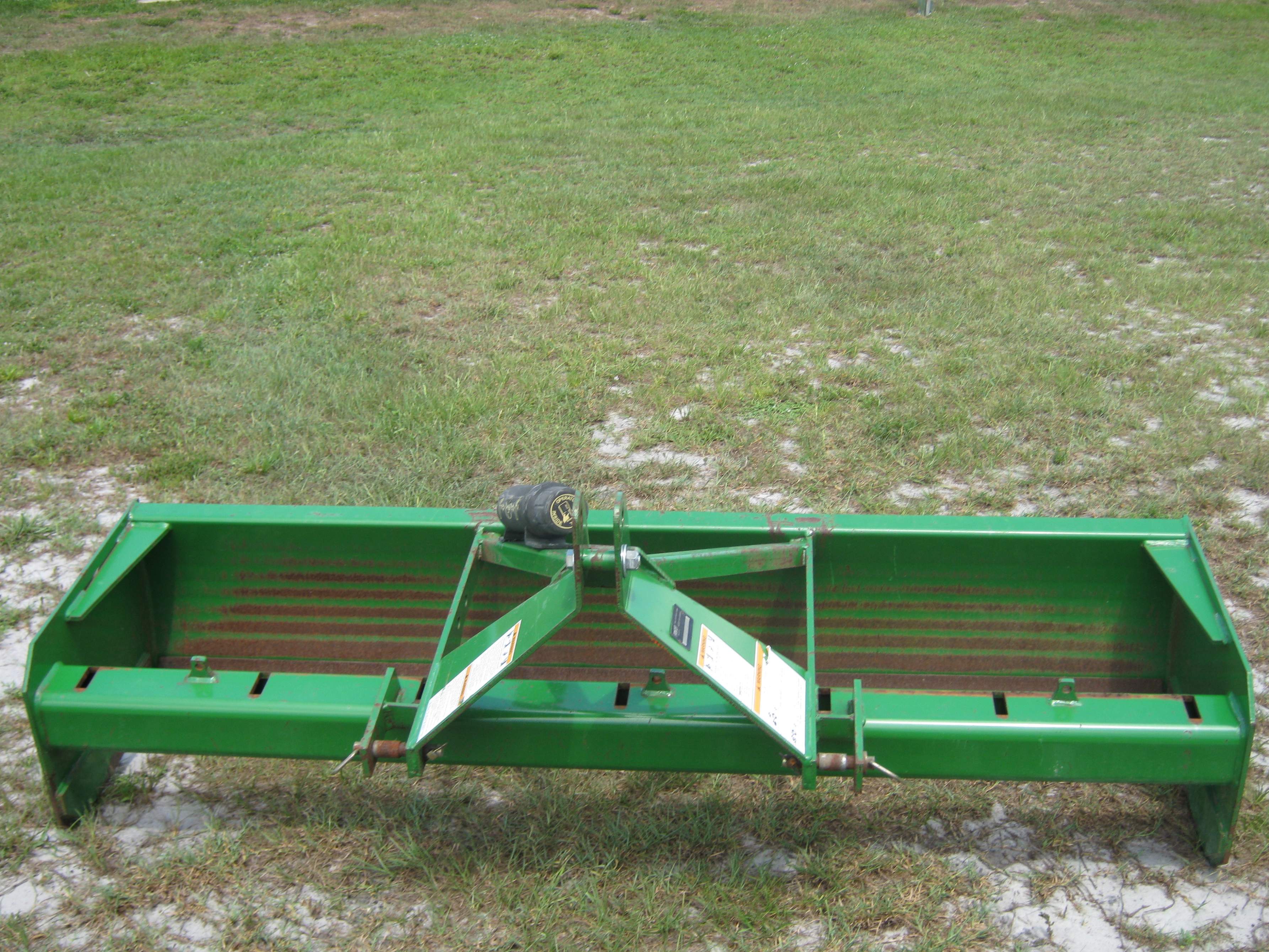

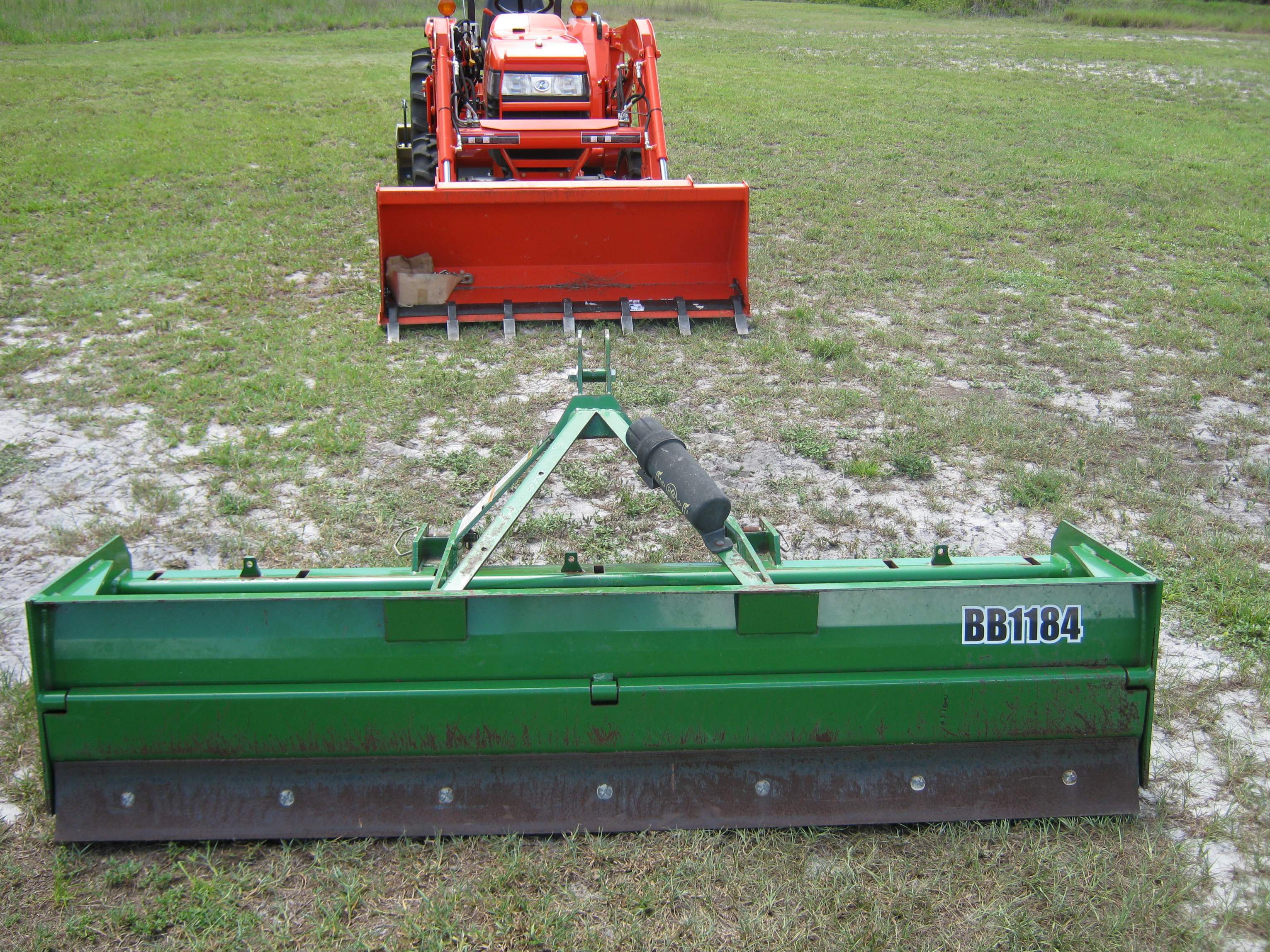

What model Frontier ?
Every Frontier BB I ever saw was made by Woods unless new ones are made by someone else.Heres pics of one I use to own(Woods).
I think your tractor could handle it,even though you don't state in what type of terrain you'll be working in.Also will 6' cover your tire tracks ?

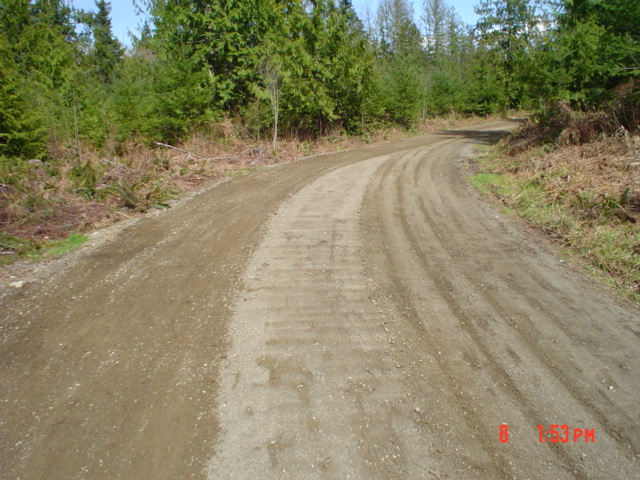

I use a 6ft box blade mainly to grade our road. If it fills fully with gravel then I have to go into 4wd, just gets a bit to heavy for my Kioti CK35 HST. Think you could use the 72 inch one, if it bogs you down then don't let it fill as much with clay/dirt. I would think you are probably better off with the 60 inch though in the long run, i suspect it would be wide enough to cover your tracks. :)
