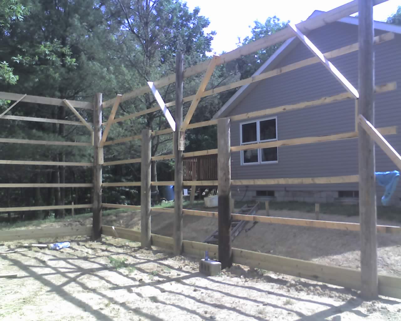

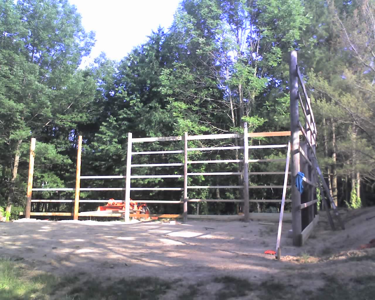

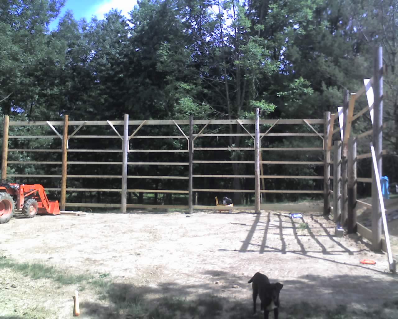

We finished. Looks good too, the hole slab of virgin clay is level to an 1/8 of an inch. The box blade worked perfectly.
I think I am gonna keep it.
Pictures as promised. To put the pile of dirt in perspective, I am 6' 4" and standing on top of it.

Good pics, glad it worked out for you. Remember to keep those pics coming. :)

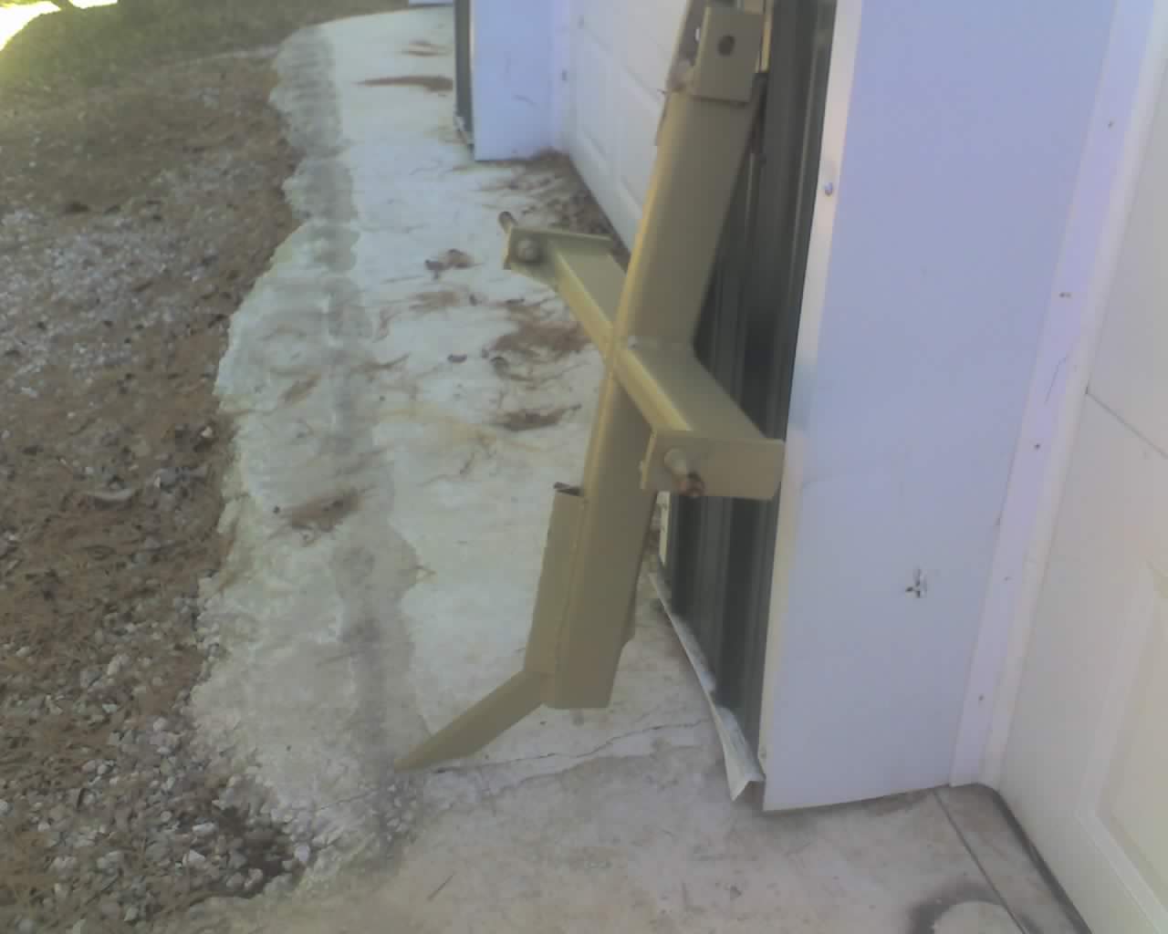

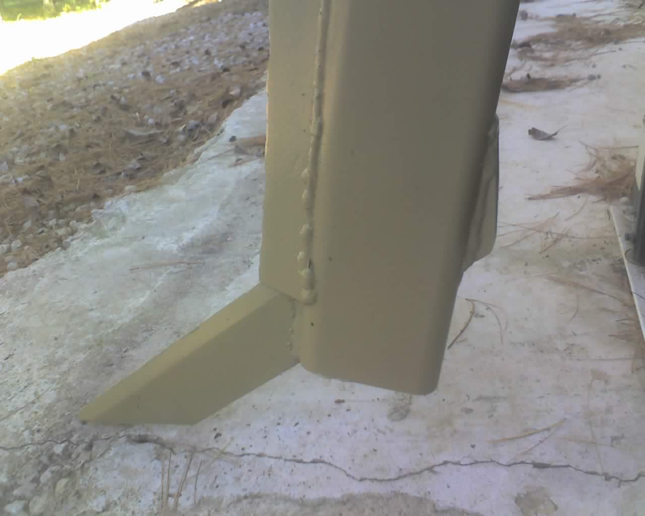

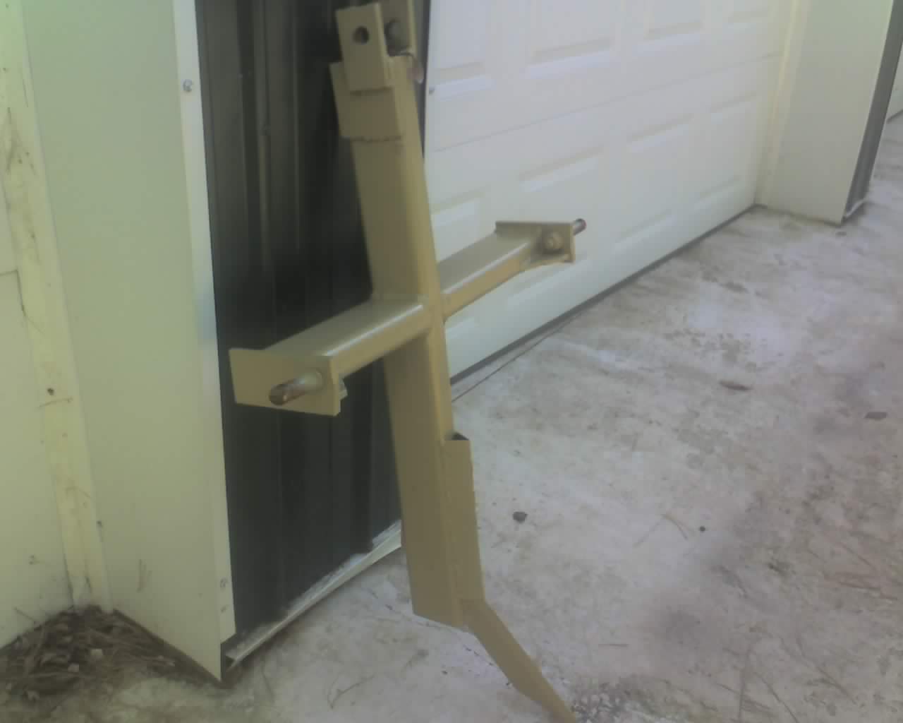

The second one (subsoiler) would probabalt do you the most good.
I made one when I installed my invisible dog fence. Cost me nothing cause I had all the scrap steel to make. If you are handy with a welder, have a decient shop and some scrap steel, it only took me a few hrs to make.
2x4 heavywall tube for the main beams and 1/2" x 3" plate sharpened one edge, and welded on for the angle. (I actually made it portrude through the 2x4 allthough I dont think it was needed.)
looks nice!
