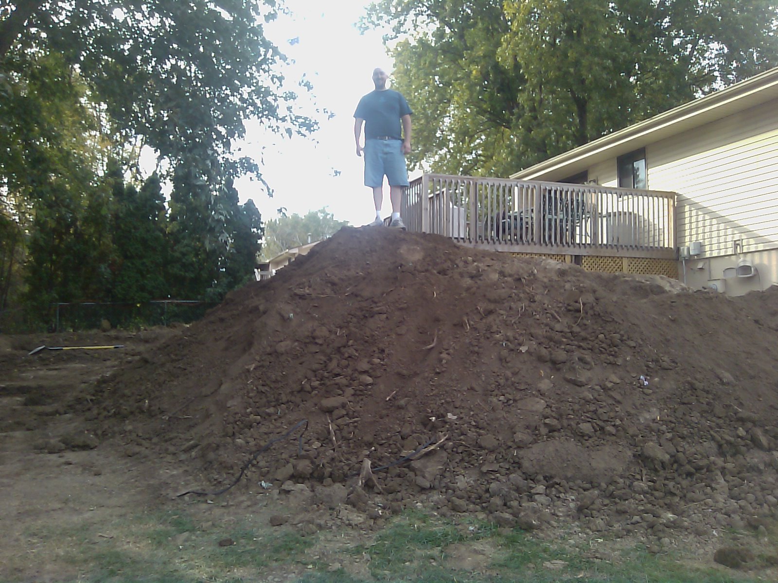

Thanks for your help so far guys. I don't have any pics yet as it is not finished. It was WAY more than 4 inches. 4 inches was the low side, it was more like 20 inches on the high side. We worked on it for about 5 hours. We are close to finished and we have an unbelievable pile of dirt. We also had a couple problems neither of them tractor related.
First as I am sure you are all wondering. 72 inch BB worked flawlessly for the most part. I was able to fill the box all the way and drag it around. No real problem with power or stalling, I even broke a tooth off. Ran 1500 RPM most the day in low 4-wheel
The first problem we had was the site where they building is going used to have an old maple tree, a big old maple tree. We keep hitting huge roots, I was taking it slow so I wouldn't break anymore teeth or twist the 3pt. We actually worked for 7 hours but because of the root removal the tractor itself only logged 5 hours and that includes some chain work pulling the roots out.
The second problem we had is once we got about 6 inches deep the clay was wet, and stuck to everything. The biggest issue with this is it would stick between the inside blade and back blade on the bottom of the box and make like a dirt skid taller than the blades keeping the blades from touching the ground, thus no cutting.
Anyhow we are done for today and going to let the last bit to remove dry out some then scrape the last 1-2 inches tomorrow. I will take pictures then. Again thank you all for your advice and assistance so far.

We finished. Looks good too, the hole slab of virgin clay is level to an 1/8 of an inch. The box blade worked perfectly.
I think I am gonna keep it.
Pictures as promised. To put the pile of dirt in perspective, I am 6' 4" and standing on top of it.

Good pics, glad it worked out for you. Remember to keep those pics coming. :)
