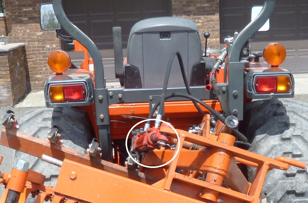

2RC Modified is a product produced locally by several quarries here in NE Pennsylvania. It consists of crushed Pennsylvania bluestone with sizes ranging from 3/4" down to stone dust. It packs down to a smooth almost concrete like surface. it is used by the state DOT and many municipalities as road surfacing material. It wears well and is fairly easy to apply. The stone surface can be seen in several of the attached pictures.
The York landscape rake does angle hydraulically, although it isn't obvious from the pictures. The angle cylinder is circled in the 5th picture. The top and tilt kit is what makes the implement so versatile.
Tilting the rake allows me to put a good crown on the road which is necessary to shed water on the steep portions of the roadway.
Yes, at just over $15K ,the project wasn't cheap. It took 95 tri axle loads at between 20 and 23 tons per load. The property owners who share the road contribute to an association which paid for the project. We saved almost $10K by doing the work ourselves.

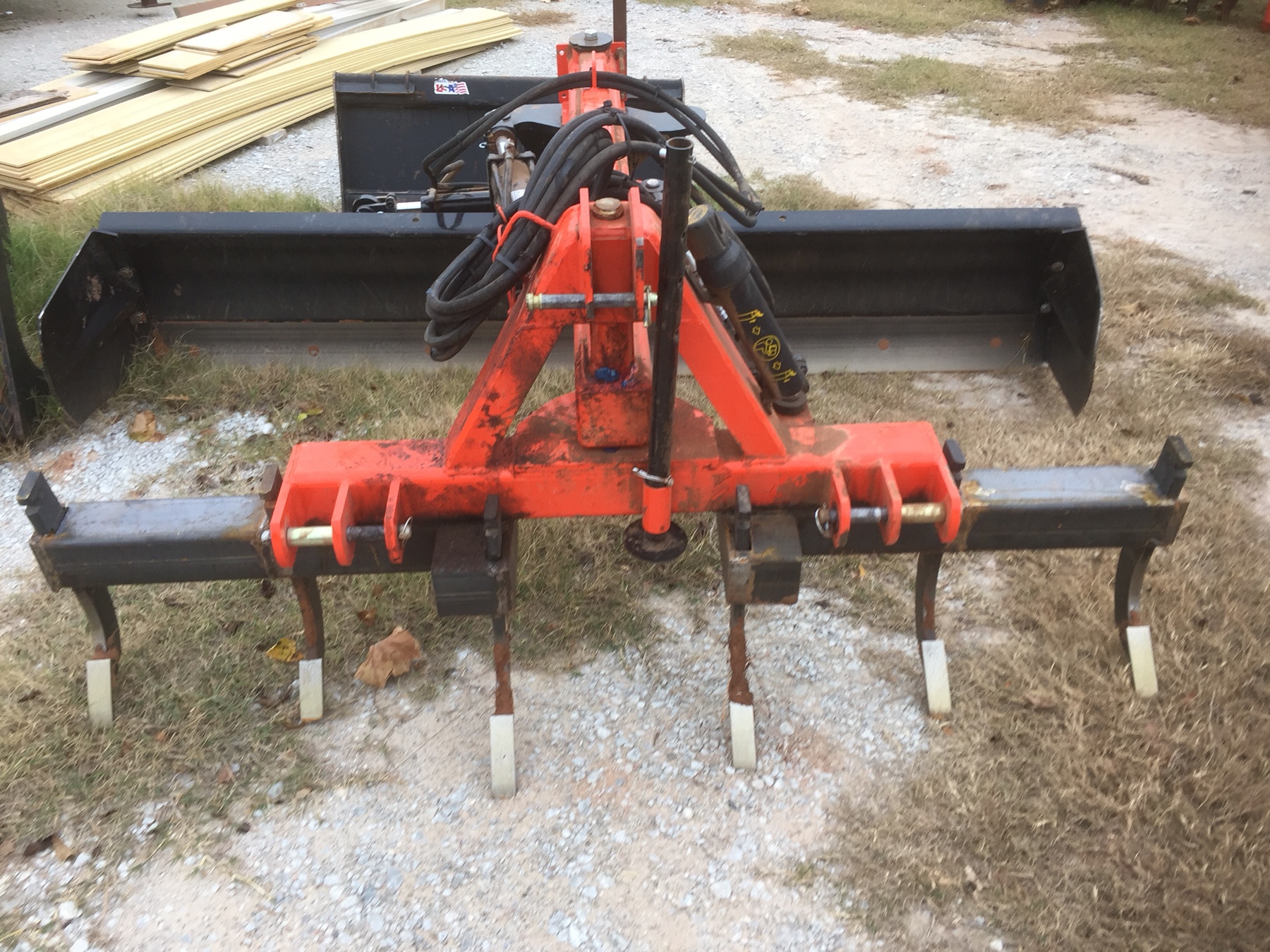

I purchased plates that easily bolt and unbolt on to the ends of my grader blade. Works great and provides most of the function of a box blade.
Actually added a setup to use the teeth from my box blade and now rarely use the box blade.
View attachment 544112 View attachment 544113 View attachment 544114 View attachment 544115 View attachment 544116
Ah... now it all makes sense.
Without the 2nd group of pictures I could not see that the rake could be angled.
What you call modified gravel, is often called 3/4 minus in other areas of the country.
With that rake, you are able to maintain a significant crown, which few understand the importance of.
Thats a neat idea, a rear blade and box blade in one.

I sure do like that set up.
The hydraulic top link allows you to lift the rake high enough to pull material off the top of a pile and level it completely without using the FEL. I find this to be one of the more useful features of the rig.
