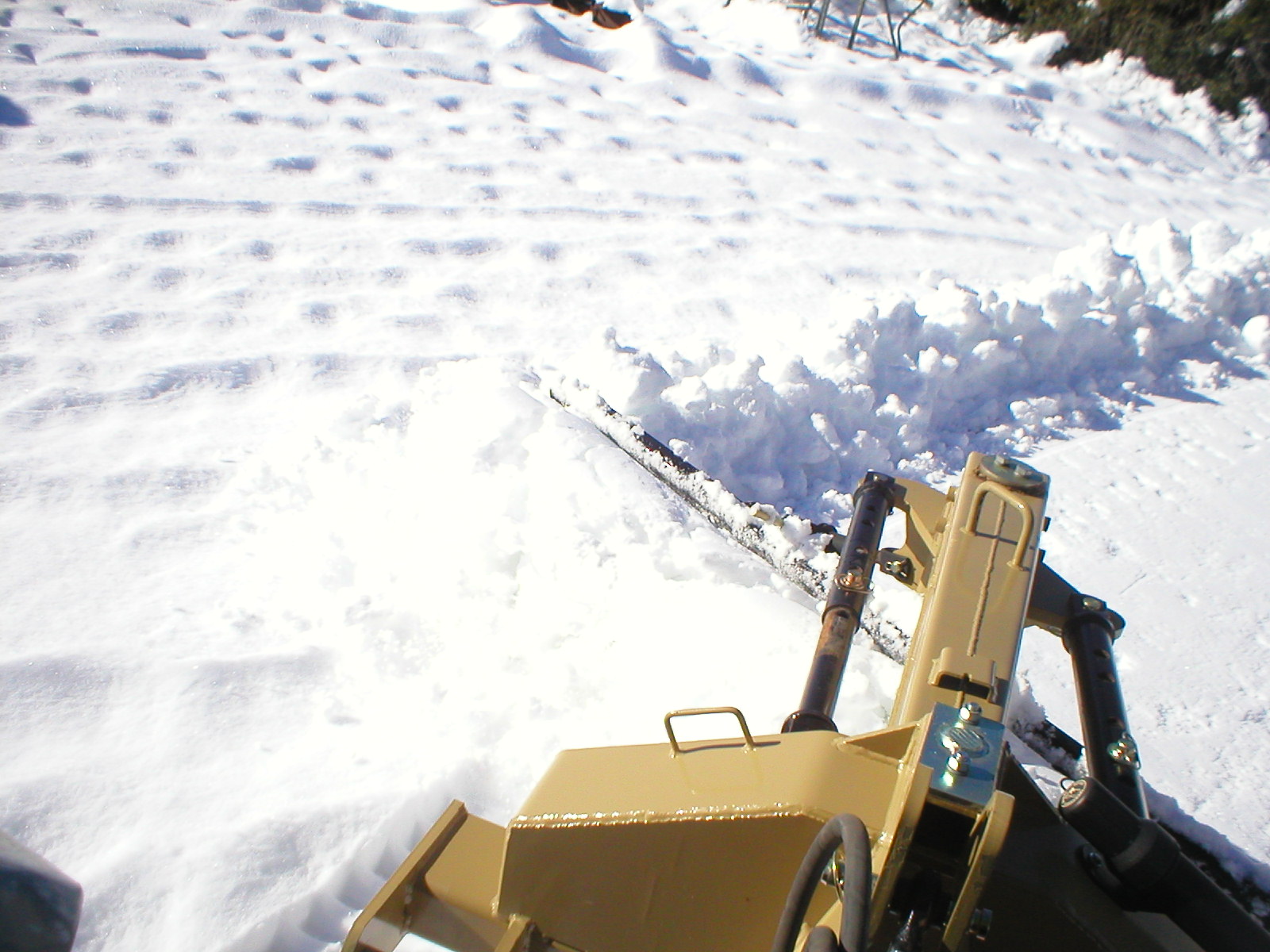

I have both;six ft.box blade(medium duty) and a seven ft.(medium) rear blade.Both have their place in drive way maintenance but the box blade wins out for me.It does a beautiful job on dry materials.
I do use the rear blade some for pulling material back onto the road ways,but winter snow removal is its primary function.

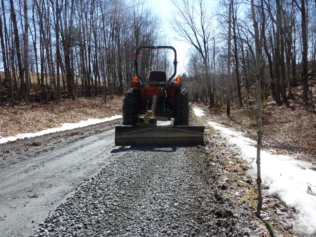

I am looking to get a blade to put on the 3 point hitch of my tractor. I have a Kubota MX4700. I am going to be maintaining a drive way that is 3/4th mile. The drive is dirt and gravel. I would like to cut some ditches on the sides for drainage, be able to level and smooth. Also what size should I get. Any advise is appreciated.
You have a fair amount of road to maintain there. :cool: Depending on your budget, but there is a good reason to have several. I use 4 different types myself.
For general all around maintenance of your road, pretty hard to beat a land plane grading scraper. (LPGS)
For ditching the edges and creating a good crown, tough to beat a good rear blade.
For moving a lot of dirt, taking care of washouts (hope not;)) and what not, a box blade works well.
For just going out and making the road look nice and doing some light grading, a landscape rake works very well.
Really anytime that you are doing grading, best to have something that is 100+ pounds per foot of width. 125lbs-200lbs per foot width is optimal.
For your MX4700, I would look at 6' LPGS, 8' rear blades, 6' box blade and an 8' landscape rake.
If you want to "get by" with only a single implement, then the box blade is your most utilitarian implement.
Good luck with your research and decision.

If your drive is 3/4 mile dirt and gravel you will most likely end up with more than one dirt implement before your done. Mine is a mile. I used a rear blade for 10 years of maintenance. It will do everything. Then I added a land plane grading scraper which was a fantastic addition but it is not a do-all implement like a blade. It is, however, my most used and favorite road tool now.
If ditching is really important to you my preference would be, hands down, a rear blade with tilt capability like the LandPride RBT series. A box blade will do it but you have to have one wheel in the ditch and the angle you can get is limited by you 3pth geometery. You need a lot of blade extended beyond your tire to ditch. A wide blade will do that but you don't want more blade than the tractor and operator can handle. Another option is to get a blade that is offsetable as well as tiltable (again like the RBT series) so you get more blade on the ditch side to work with. This is what I mean by offsetable.
If you have a big budget there are some great blades a available that make the RBT look primitive. I just used it as an example.
