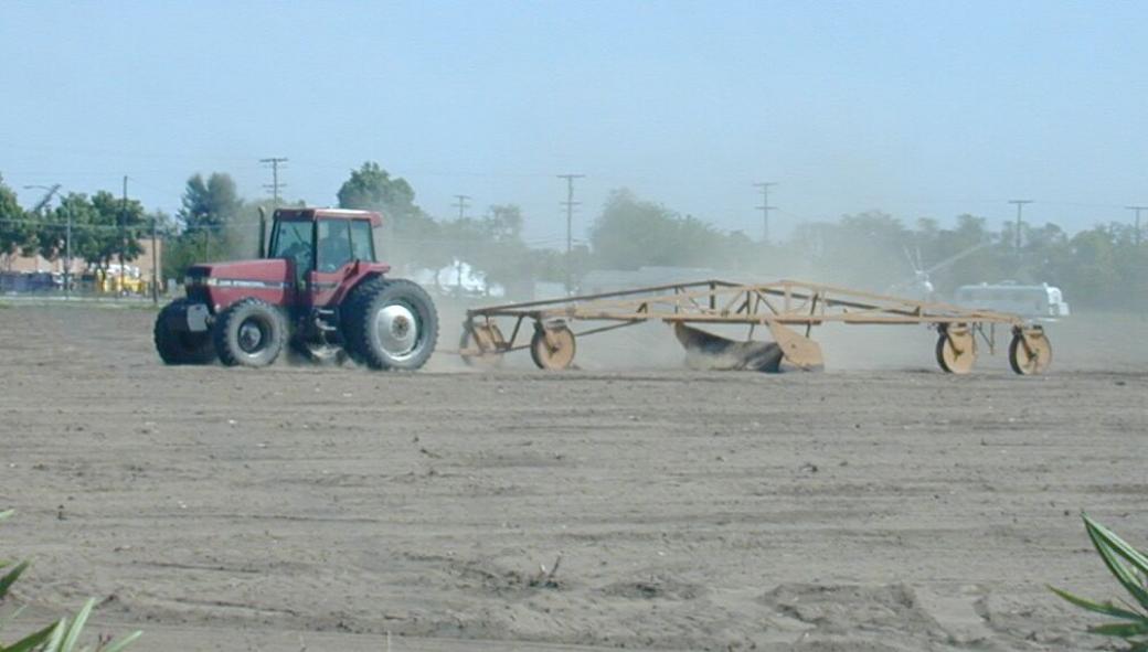

sorry for this dumb question is the term "grading scraper" and a "land plane" used synonymously on this site?
They often are, which can confusing because there is already an implement called a land plane.
Bruce
   / Box Blade vs. Grader Blade #22
Actually, yes a grading scraper and land plane are commonly used terms for the same implement. I have done my best to adopt the term "land plane grading scraper" (LPGS" and many have gone to that term, but not everyone. :(
Assuming that you are talking about one of these.
   / Box Blade vs. Grader Blade #23
Bruce
You are correct. If people are going to use the term "land plane", when talking about a 3pt implement, they should probably say "3pt land plane" if they are actually talking about a LPGS. All the more reason to adopt the "LPGS" term in my opinion.
Just my :2cents:
   / Box Blade vs. Grader Blade #24
I have a mile long, straight as an arrow, dirt/gravel driveway. I use the following to maintain the driveway - - Land Pride RB3596 - rear blade to plow snow in the winter,,, Bush Hog RO720 - roll over box blade to grub out pot holes and move dirt/gravel on the driveway,,, Land Pride GS2584 - land plane grading scraper for final grading, smoothing and minor gravel spreading.
My driveway becomes as hard as concrete in the summer and the rear blade simply does not provide the control necessary for adequate maintenance. Plus I've found that to provide proper control the rear blade would probably have to weigh around 1200 lbs or more. Otherwise, the rear blade simply bounces down the driveway like a jumping jack. The LPGS is the ultimate implement for grading, minor material spreading and smoothing.
