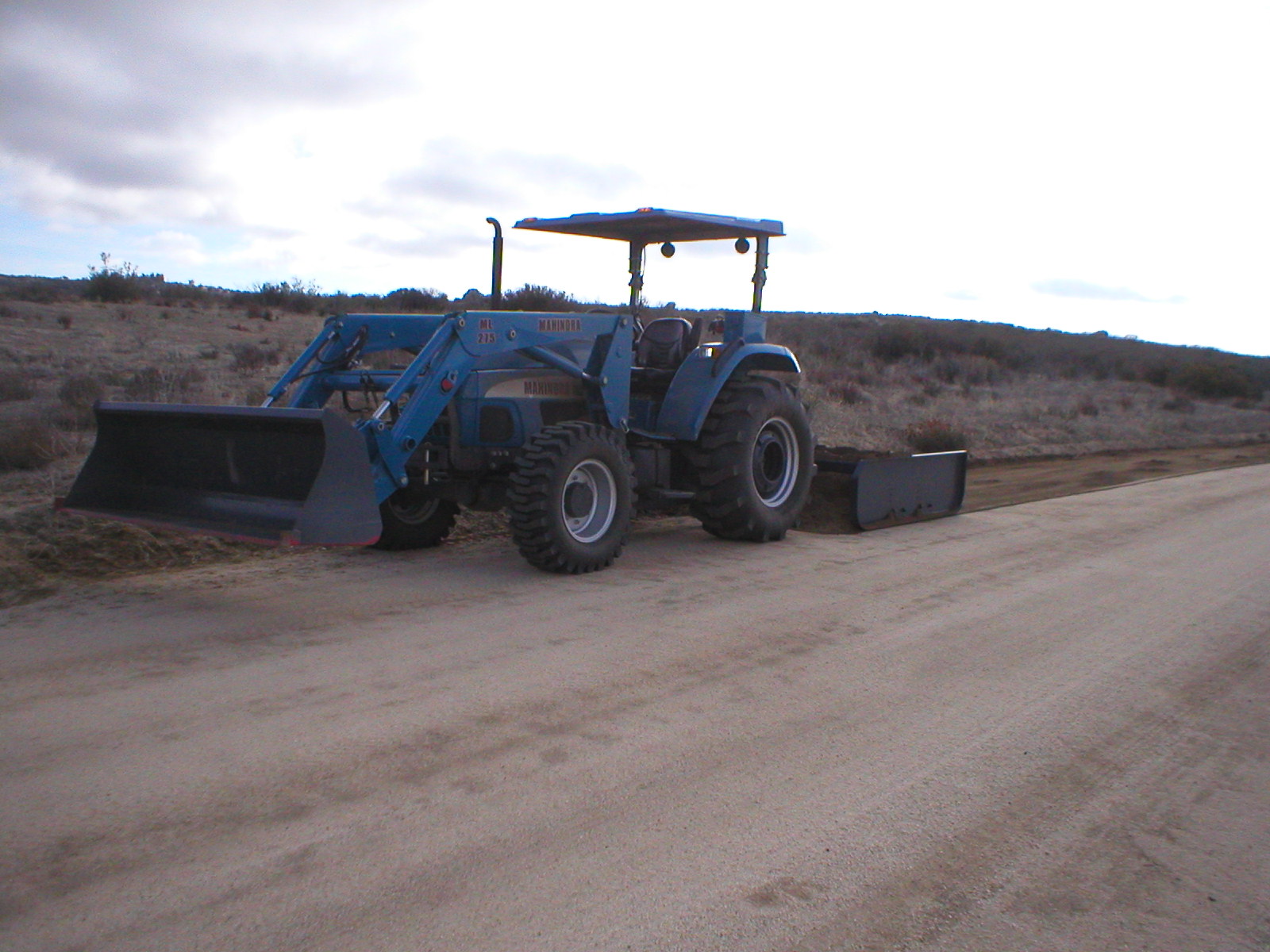

I'd like to know more about how it works...how does it work better than a box blade? Got any other pictures of it? Say... with dimensions and angles?:D
   / Box Blade VS. rear angle blade VS. FEL for dirt driveway #27
3RRL said:
Wise guy.:D
Do you still have that grader for sale Brian?
I'll bet you could sell that to someone here after they see some of your finish grading on your road.
Odd that you ask that question. Just today I bought the 2 that a local dealer has had for, well since time began. I felt bad for them, they are in the industrial end of equipment and have no one to sell them to. (except me) I have tried to help sell them for them with no luck, so I bought them to help them out and will try to sell them myself. I have a 5' and 7'. I think that you should buy the 5' for Loretta and let her finish grade your road. I'll even paint it black and Honeybee Yellow.:cool: :D
   / Box Blade VS. rear angle blade VS. FEL for dirt driveway #28

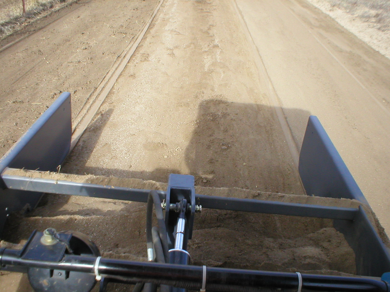

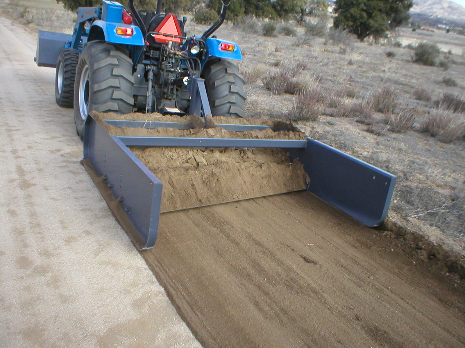

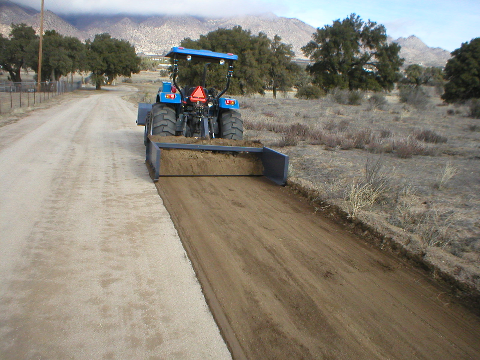

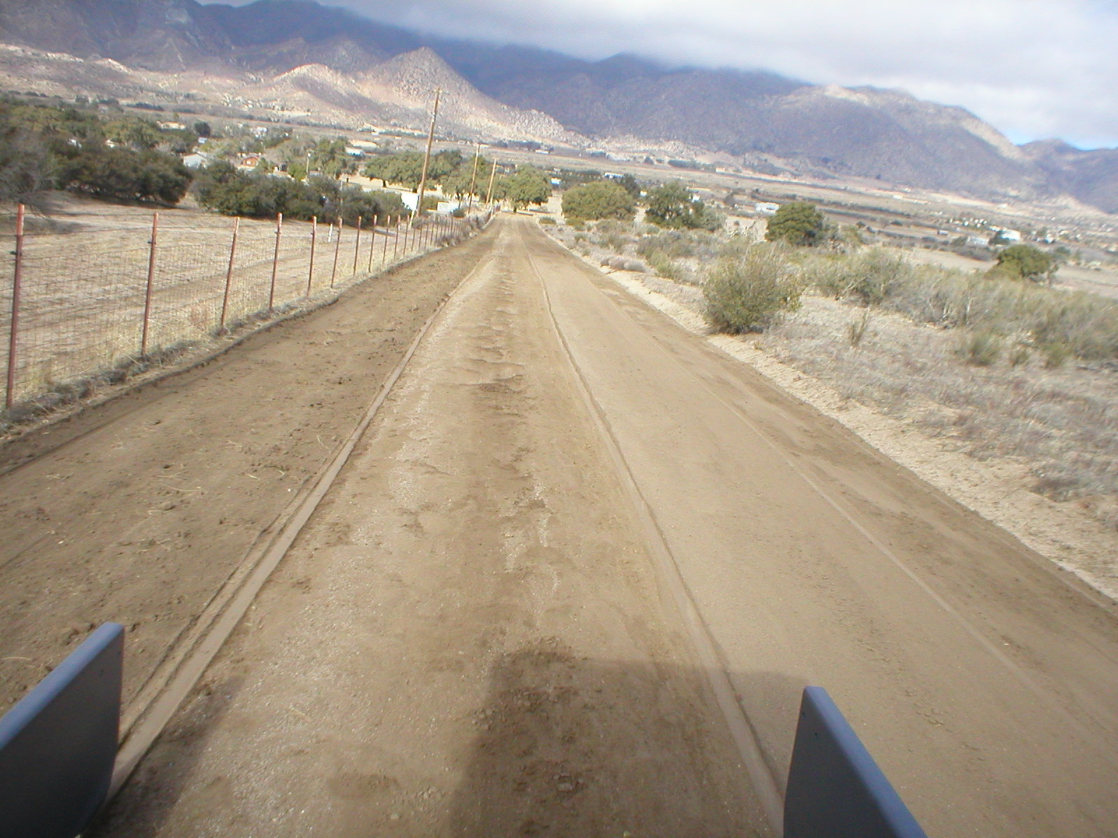

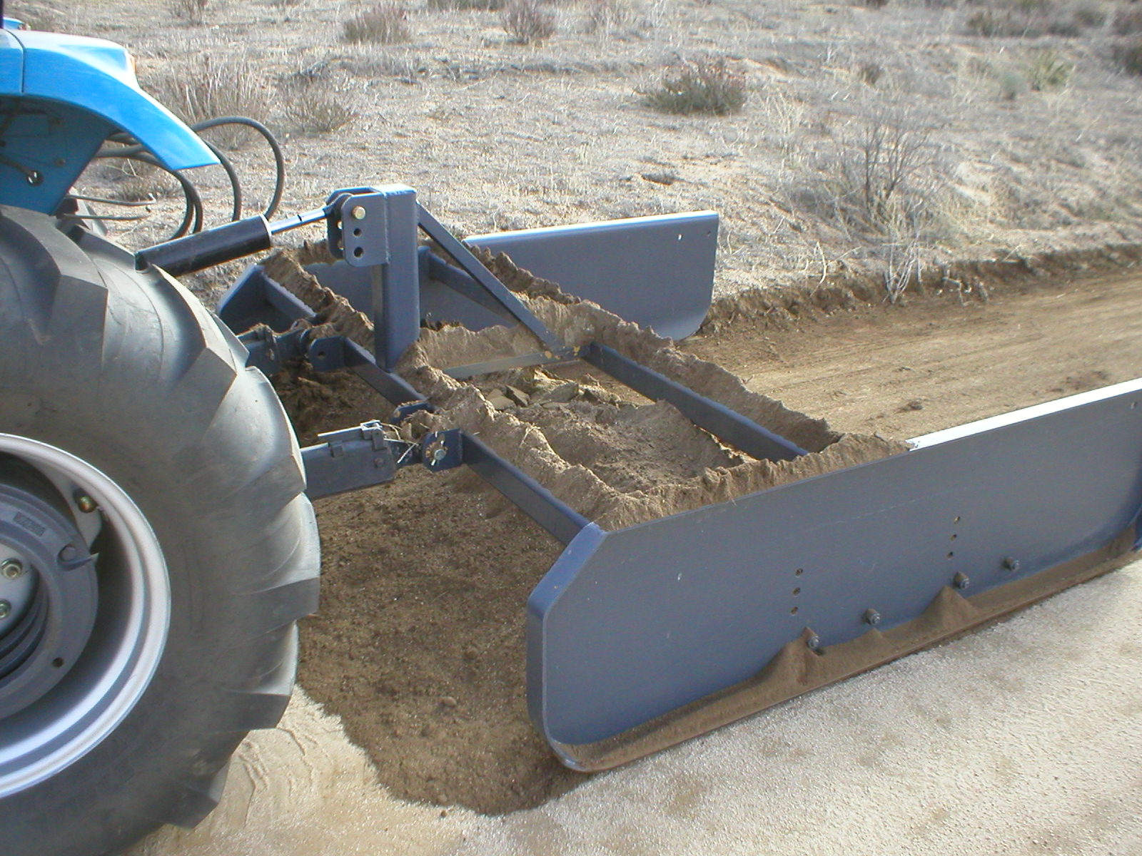

Here ya go. Mine is considered a 7 footer. Actual width is 89". 24" sides. 84" long. Two blades extend 1" below sides at about a 20-25 degree angle side-side. Weighs in around 1400-1500lbs. I pull it with my 75 horse 7520 Mahindra that weighs just under 14000lbs with the loader and road scraper. A couple of reasons that it works better than a box blade is that it has 2 blades on an angle, long sides to help keep the blades from moving up and down as much as a 2' box blade will. The angled blades work great for removing wash boarding. This thing is like pulling a 7' square down the road, instead of a 7' x 2' rectangle. Shear size helps smooth better.
I currently have a 5' and 7' for sale.
