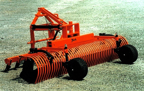

I don't have one with a rear blade... but here's one from York with a rear rake... /forums/images/graemlins/wink.gif
