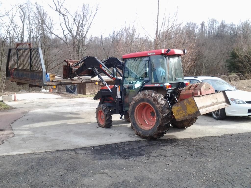

I used rear wheel tractor (ag) weights. Chained them to the center. It is raining so I do have a lond distance pic, look hard.

Jerry, Could you tell a difference when you added weight?
The angle of the shanks or cutting edge should pull the scraper in regardless of weight.
Chuck
/ Box Blade weights #8
It made all the difference in the work. In hard packed soil and with our high density of rocks it didn't want to cut any without the weight.

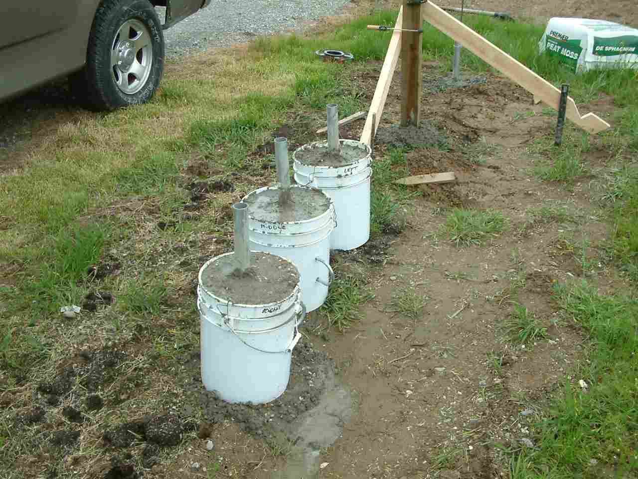

Same here, but filled with concrete instead of sand (see attachment). Used two 60-lb sacks of mix in each 5-gal bucket. Makes a big (positive) difference in BB performance, especially when stripping weeds/turf from a landscaping area.
I put a piece of chain link fence post in each weight extending about 10", each end so it has better support from the box blade frame. The post also gives me a way to grab onto the weight.
I chain the weight to the BB via the U-bolt.

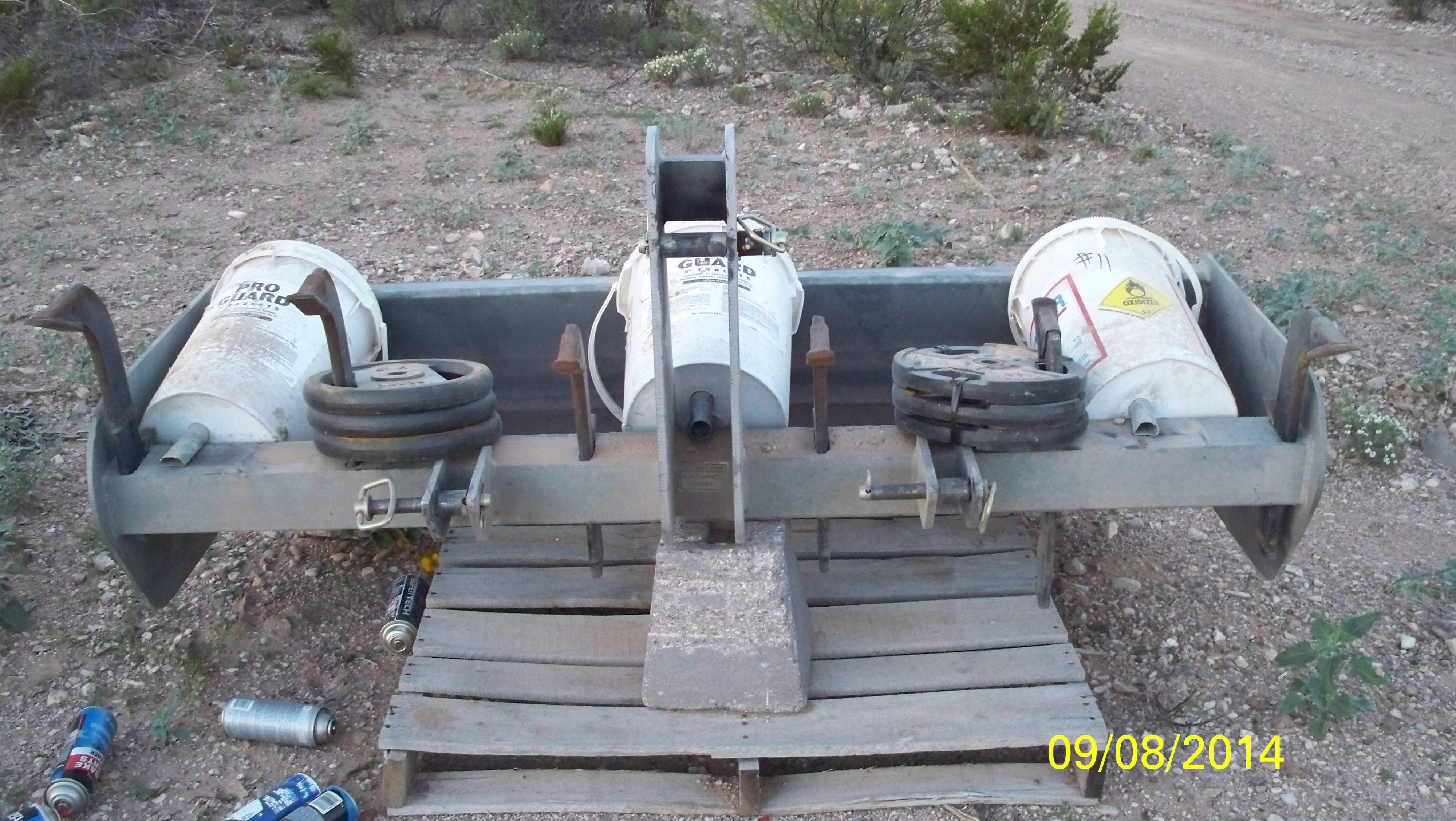

I went with the buckets, now the box blade works. :thumbsup:Vacation pics and box blade wieghts 010.jpg
This set up with the buckets and the barbell weights gives me 510#'s each bucket took 2 sixty pound bags and the weights are 25#ers.

At work, we have a 5.5' BB with half of a small forklift/tow motor counter weight. Nice ballast on the back of the L4310.

Very good point... that's why one of the projects on my to-do list at work is rebuild/upgrade the 3ph attachment points on the BB pictured above. Aside from nearly 30 years of abuse (it was purchased new with the other tractor, a 1986 L2850) adding the weight as well as putting it behind a larger tractor (L4310) has taken its toll in the last few years. But the added weight does help a lot.
