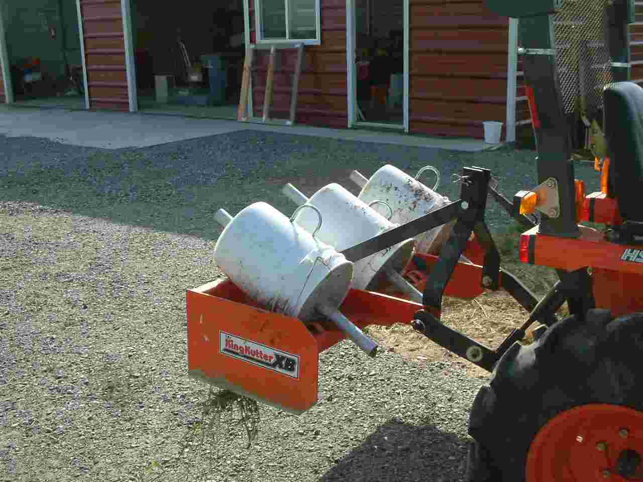

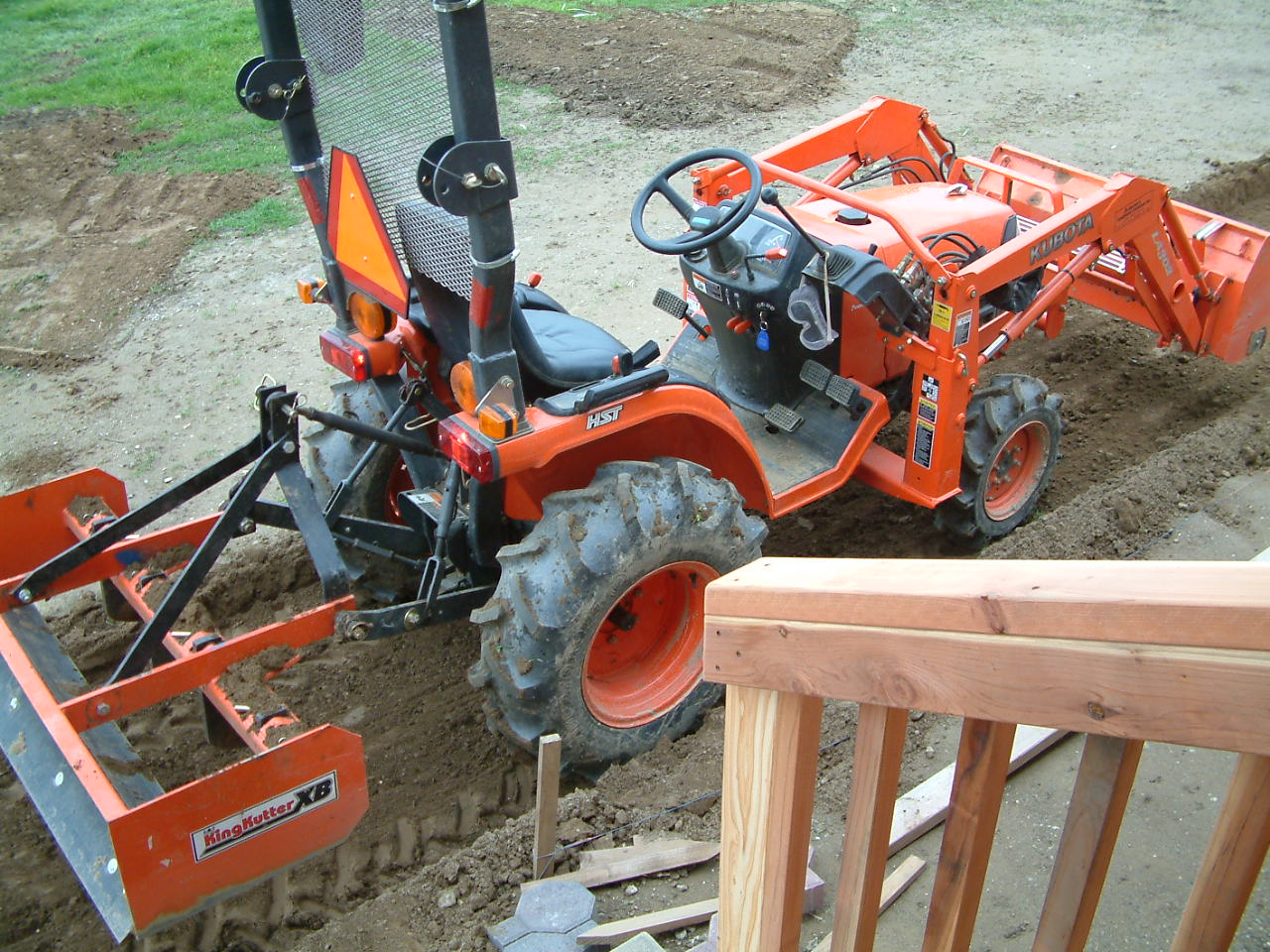

Since a box blade is boxy, you can use it to scoop up dirt from high spots and fill in low spots. The scarifiers (aka rippers) can be adjusted up and down to get more or less bite.
I use by 4-ft King Kutter box blade to excavate for paver block walkways.
Since the BB only weighs about 240 lb, I built three 120-lb concrete weights to get better performance.
