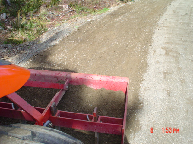

Hi Ron, welcome to TBN.
I have a CK35 HST and use a 6 foot box blade. Most of the road and driveway is fairly flat but do have a couple of inclines. I have had to use 4 X 4 if the box gets full of wet gravel but other than that is works great. I bought the 6ft used and a 5ft would work fine as well covering the tire tracks. :)

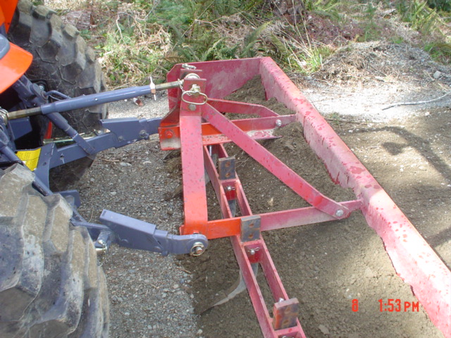

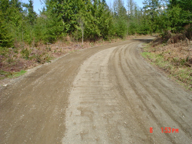

Ron, if you have a mile of driveway to maintain, I would seriously be considering a land plane grader blade.
/ box blade width #15
Yep, those work very well too.
[ame=http://www.youtube.com/watch?v=OIed2lzfQ-g]How To - Tractor Land Plane - Gravel Road Maintenance - YouTube[/ame]
