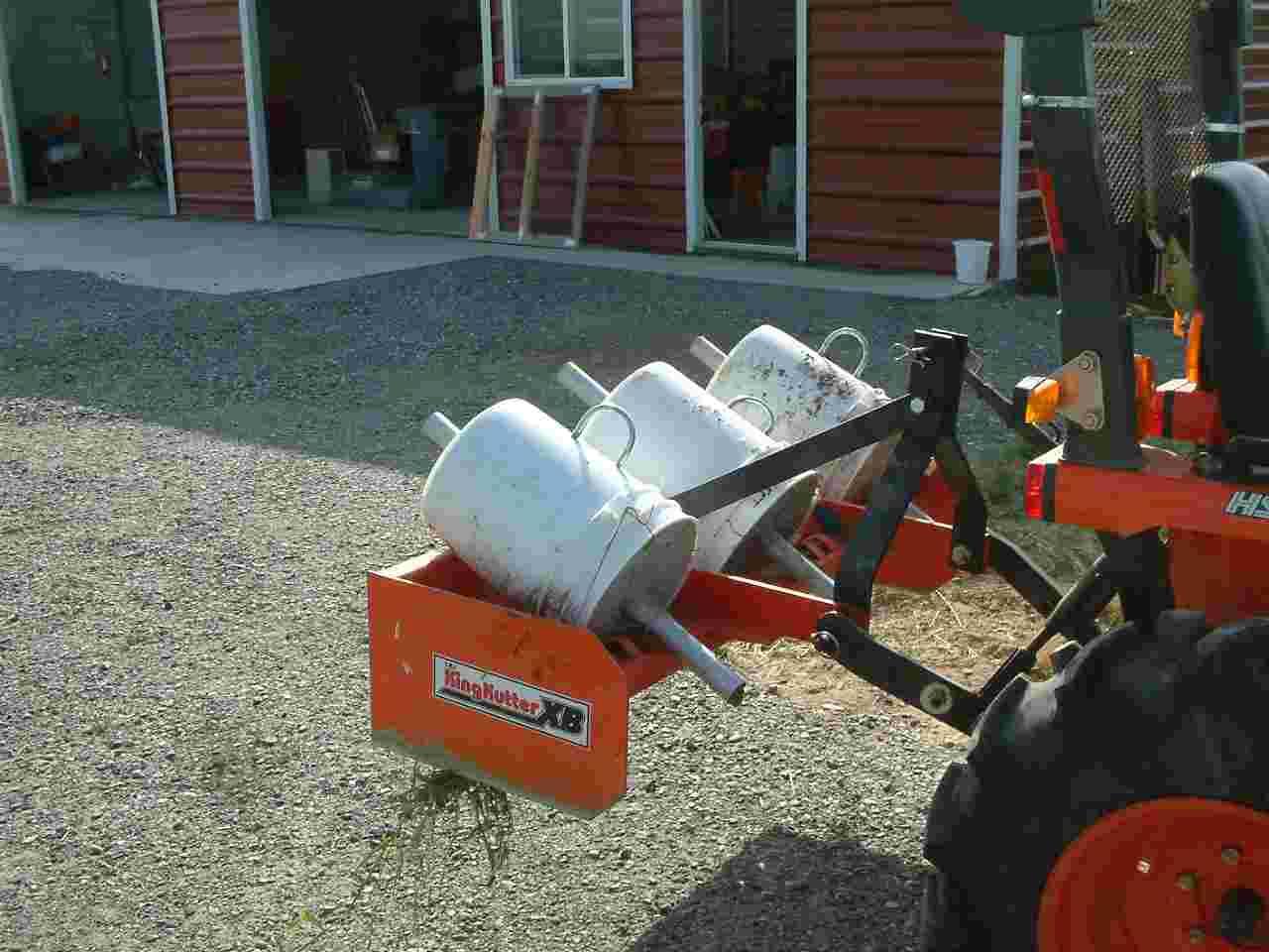

I do about the same thing as Tom H. I have two old 5 gallon buckst that I fill with rocks (iron stone). I put them on my KK 48" BB. The blade wieghs about 300lbs. I bet I add at least 150 to 200 extra pounds.
Attached is what another TBN member did. Three 5 gallon buckets full of concrete. Each one runs about 100 lbs.
