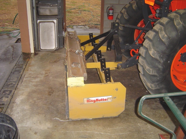

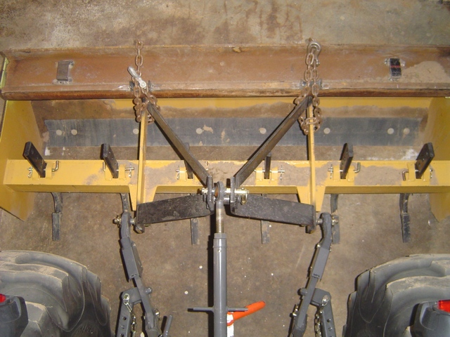

I also use railroad iron on my ballast box blade. Railroad track comes in different weights, (weighed by the yard), and the standard size is about 150 pounds per yard. Pretty dense stuff. I use a 6 foot piece, (300 pounds) on my 6 foot box blade. The box blade weighs around 500 pounds...making for a total weight of around 800 pounds. It makes a difference. I did some additional welding to the supports, (since it probably was not designed for too much more weight), and added angle iron to make a tray of sorts to keep the rail from bouncing off. You can bust a gut manhandling that stuff, and it's a good way to get hurt bad if it falls or rolls over on a foot, etc.
