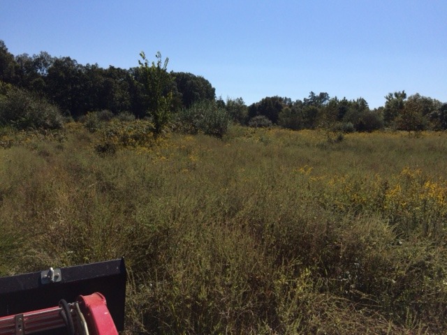

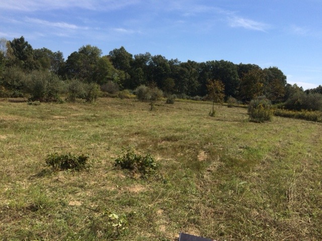

I have a boxblade and plow. The areas was grow up bad,it hasn't been touched in over 20 years. It was part of my wife's family farm and we wanted to get it back in the family. I plan on clearing the old pasture, about 12-14 acres, and on the other side it was about 8 acres of orchard and garden. I'll probably put some food plots out next year, but figure I'm 2 or three getting it all cleaned up.
Here is the area I'm talking about, doesn't look that rough in the picture,but you can hardly mow it for the ruts.
The first pics after I mowed it and the second is before.

I'm sorry I wasn't clear enough. The area that is so rough is about 2 acres.Part of it is the road coming in and the rest must have been where they staged their logs. There is still a couple of big ones laying there rotting away. I have a Frontier 4' boxblade and a good disc. I have a few small trees to cut first and then I'll try them both to see which one works the best.
