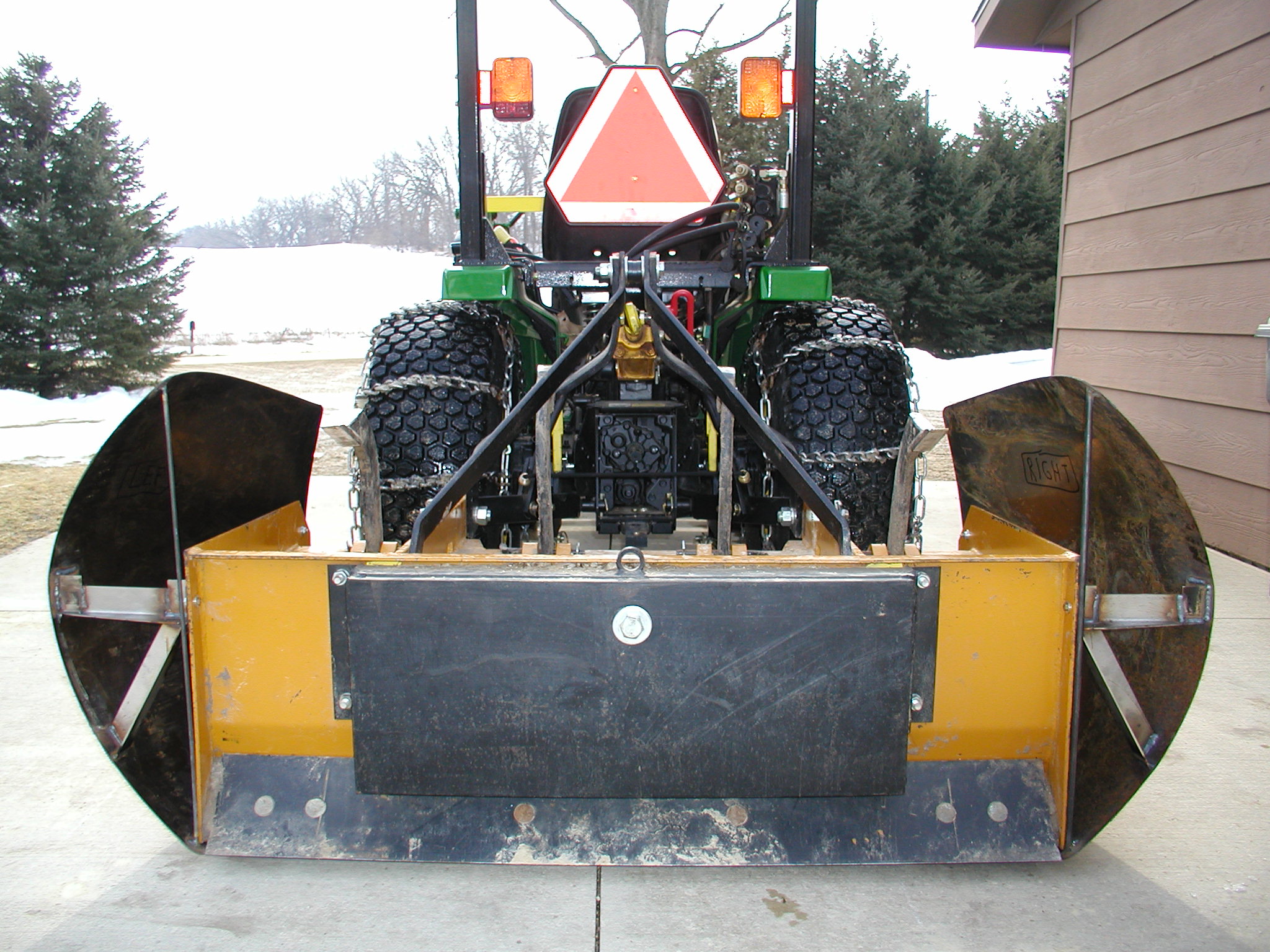

I built a couple of stainless "wings" that bolt to the sides of the BB, I use that contraption when we get very deep snow, to form half-pipes for sledding and snowboarding. With the loader bucket full of snow and carried one foot off the ground (leaving one foot of snow), and the boxblade lowered to about six inches off the ground and of course it fills right up, the pipe is formed as I drive along. Overnight it freezes and the next day the pipe is useable. Here's a pic:

Now that is cool!! Of course we only get that kind of snow once a decade, but that is awesome. Very creative.
