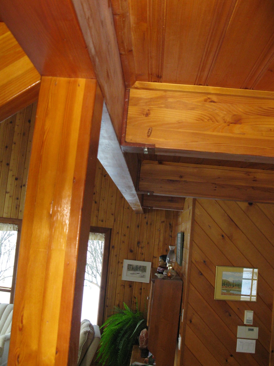

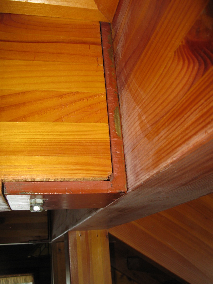

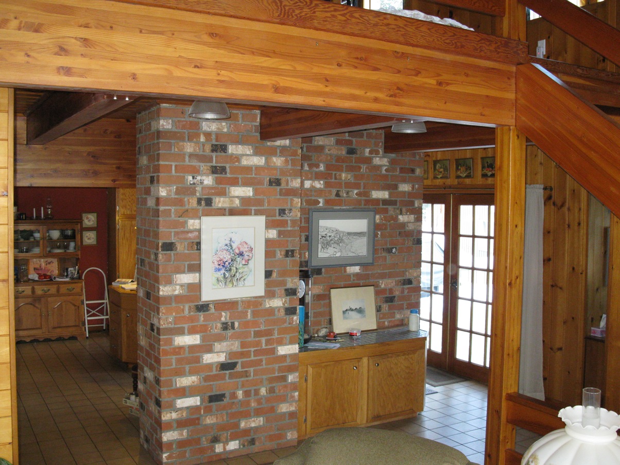

Here are photos for the beams in our house, which was built in 1981. As already mentioned, it is good to over-design structural members like these. The plates appear welded from 1/2" thick x 4 1/2" steel.

In most cases my concern would not be with the steel but with the connection hardware (lag bolts) and whether it can transfer the loads.
Although this is an old thread, it's still an interesting discussion.
That's a valid concern about the connection sdkubota. In this case I'm not concerned. I was fortunate to meet one of the carpenters who helped build the house. The owner was a professional builder who raised his family in it. The lumber came from a small mill a few miles from here. That includes all the moulding, tongue and groove, etc. You can tell by the plain design fo the moulding.
One exception is the top roof 2" x 12" fir joists which are 28' or 30' long. Although the maximum span is 14' he insisted they be one continuous piece. They were shipped from a Vancouver mill.
The steel plates connecting the beam are "Z" shaped and thus hung from the supporting beam. The beams are 5" x 13 1/2". The stair stringers and 3' wide steps are 3" x 13". They were built by a neighbour who still lives in the area.
A few years back we replaced the lower roof's cedar shakes with shingles. We added 1/2" plywood to the 2" x 4" strapping that held the shakes. I asked the roofer how the roof looked. He said: "It's solid, real solid". They are 2" x 12" for the 16' span.
It is a different story today. Most small mills have been forced out by government and big mills and the best lumber is exported. It is still possible to get good lumber from some very small, private mills.
