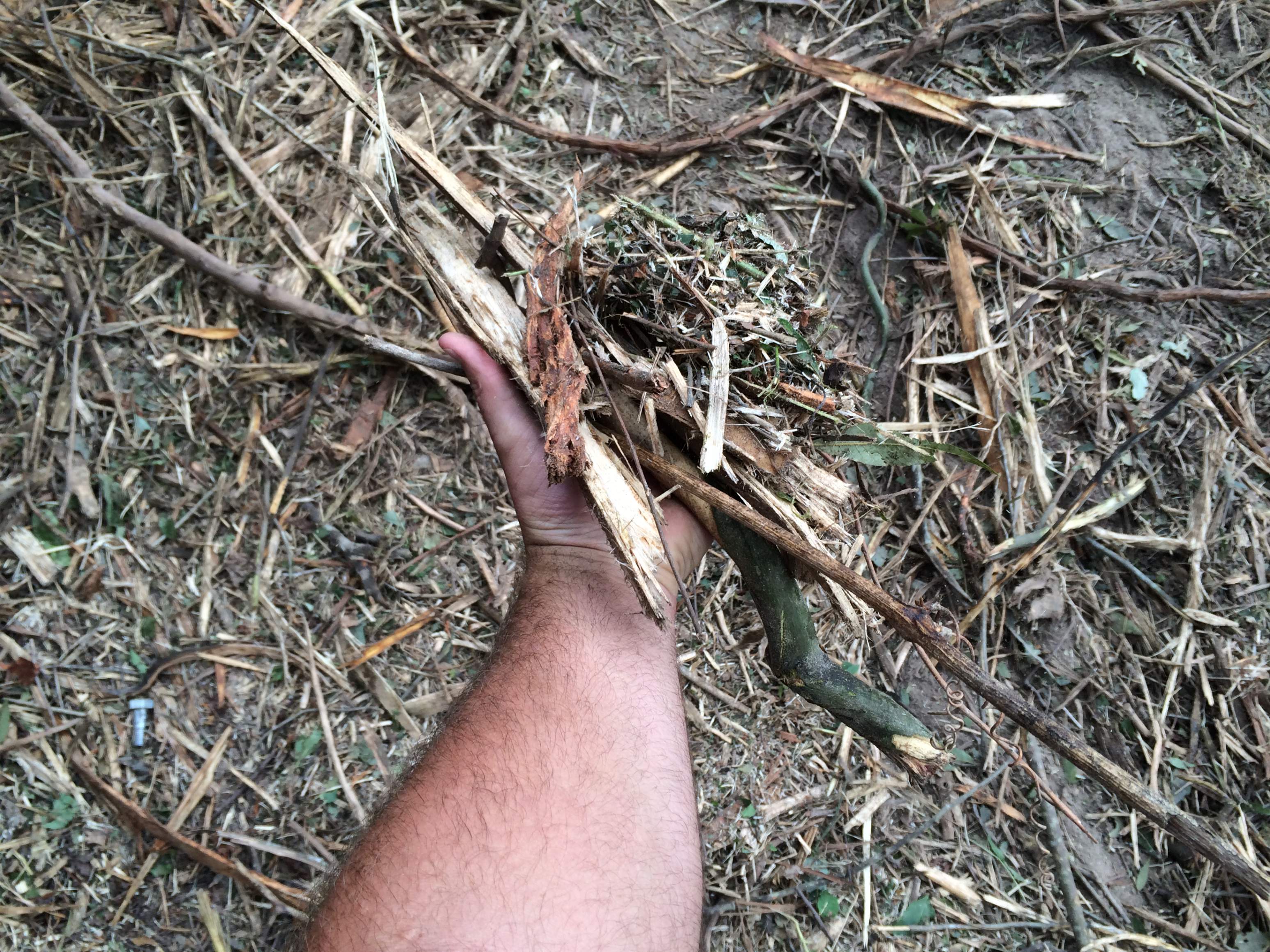

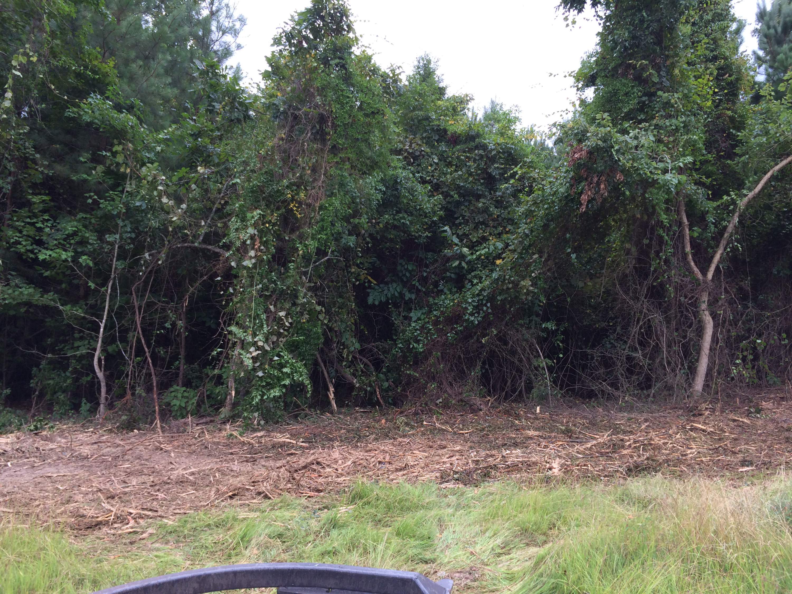

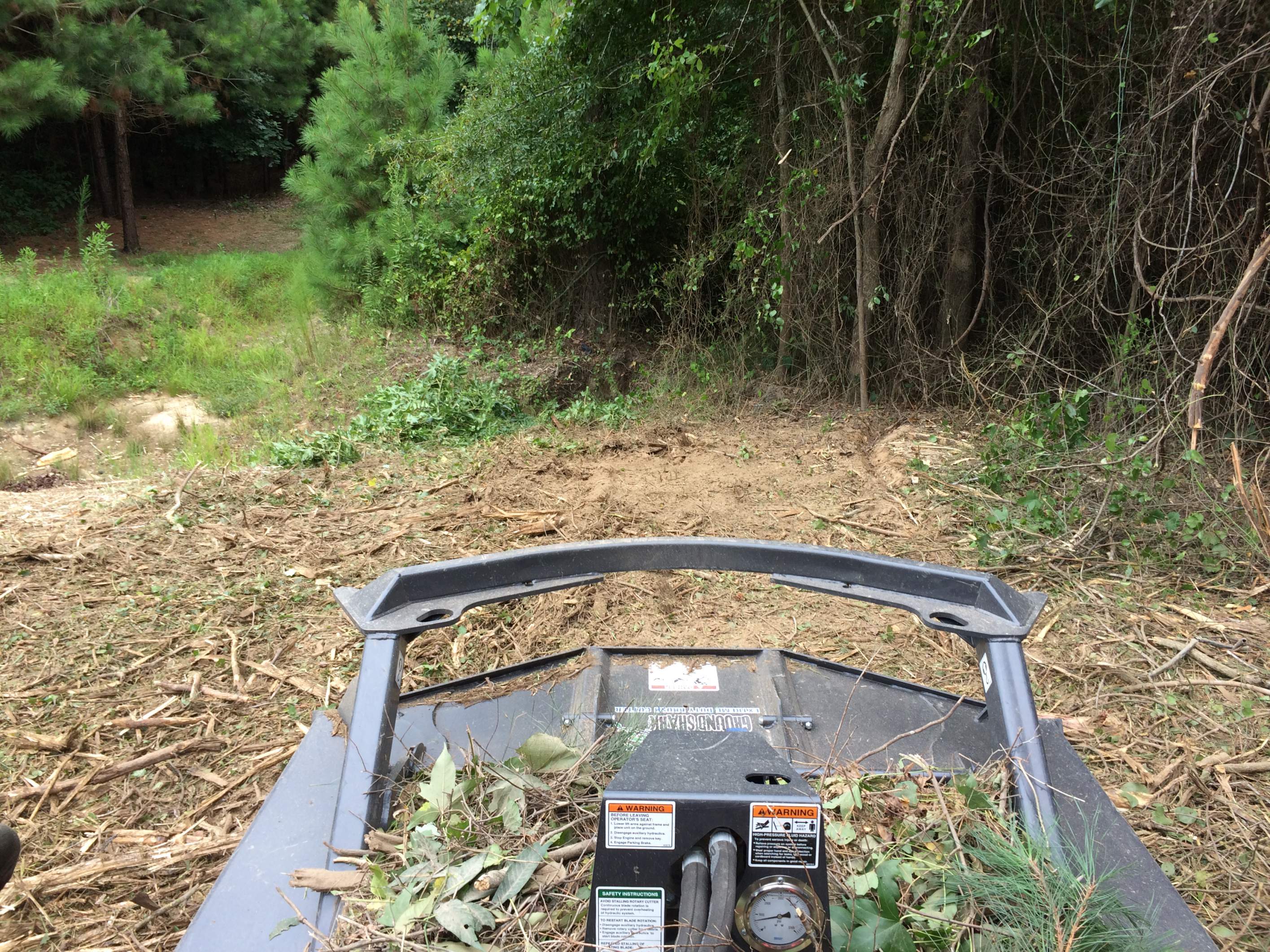

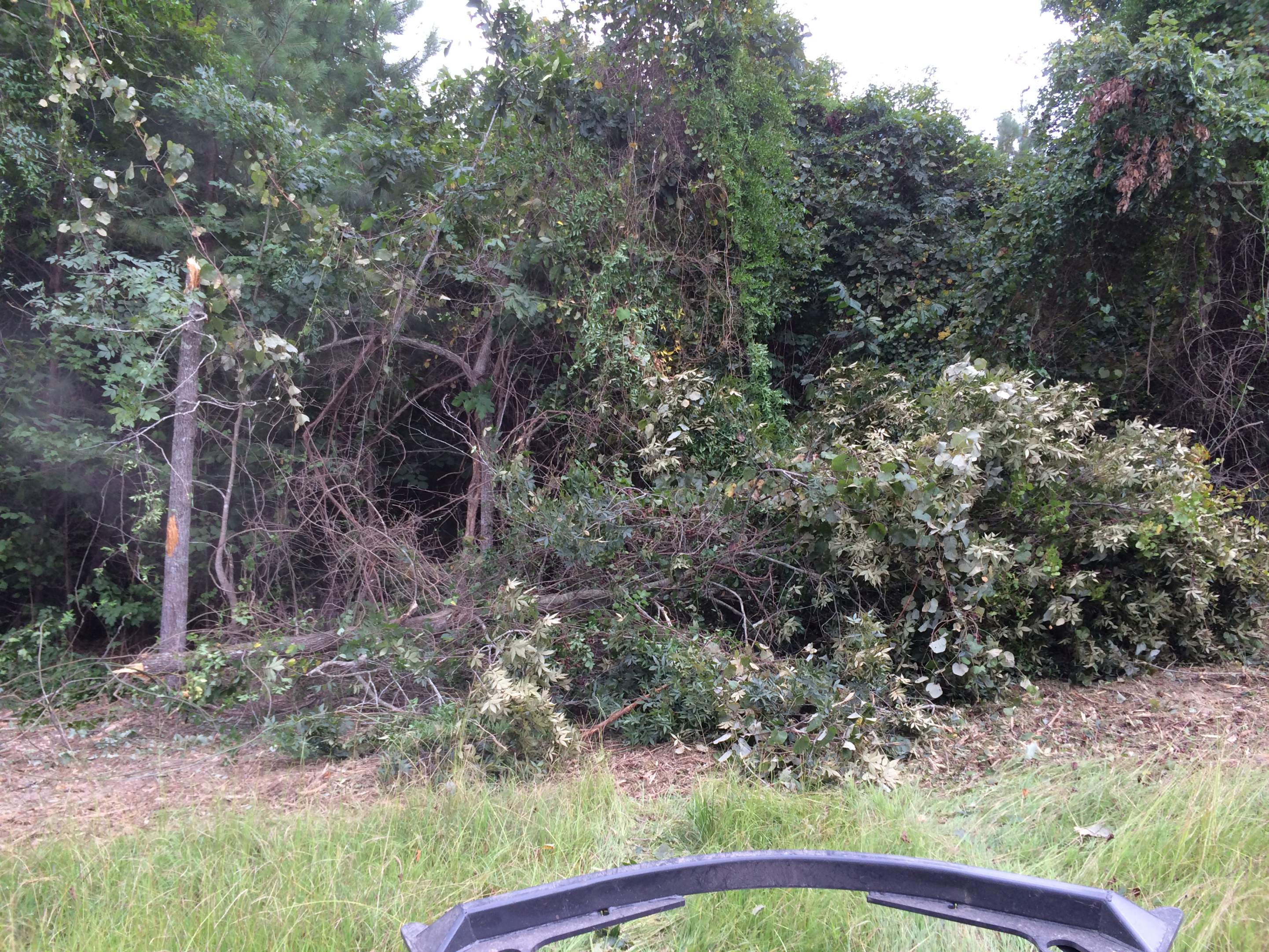

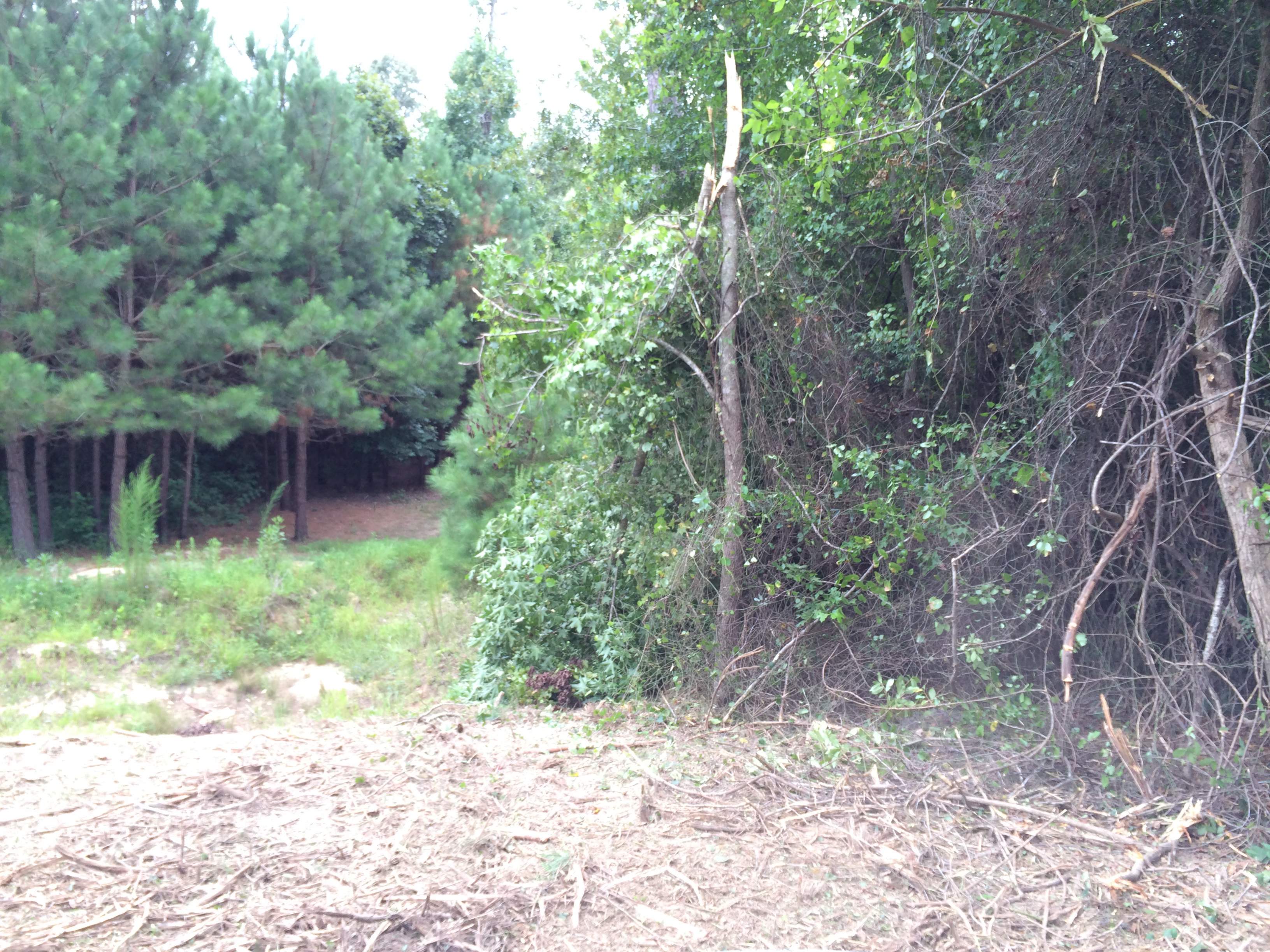

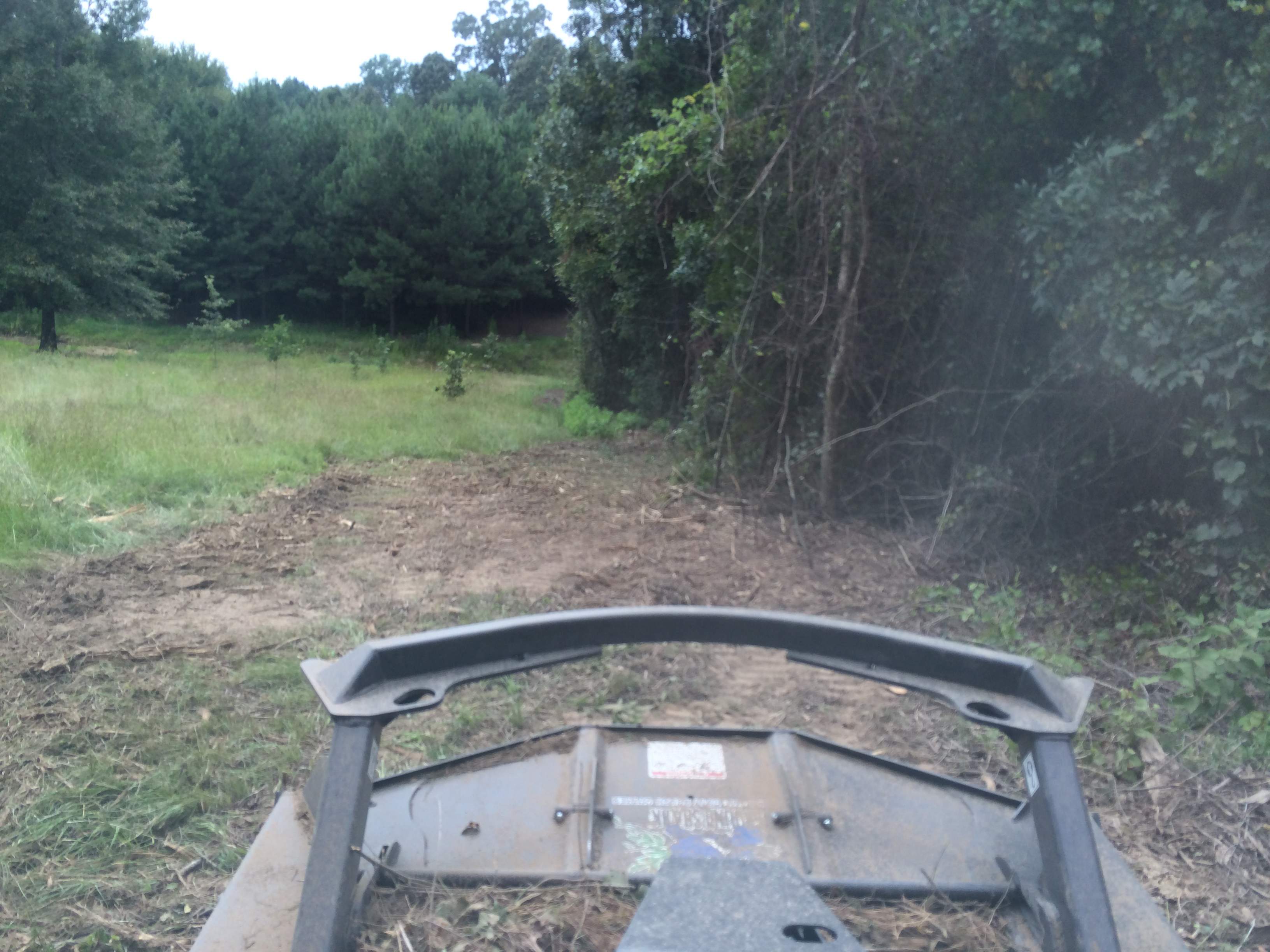

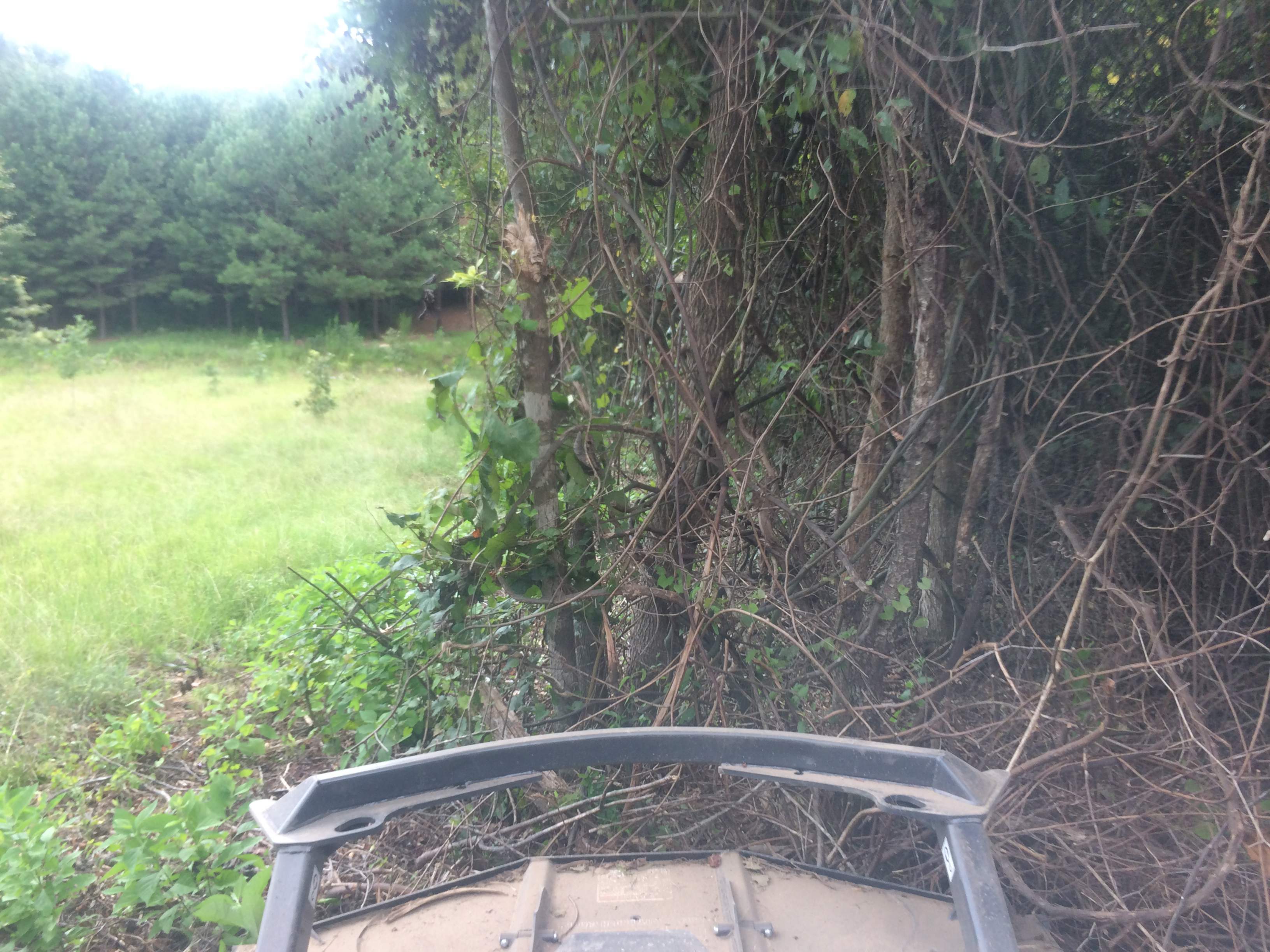

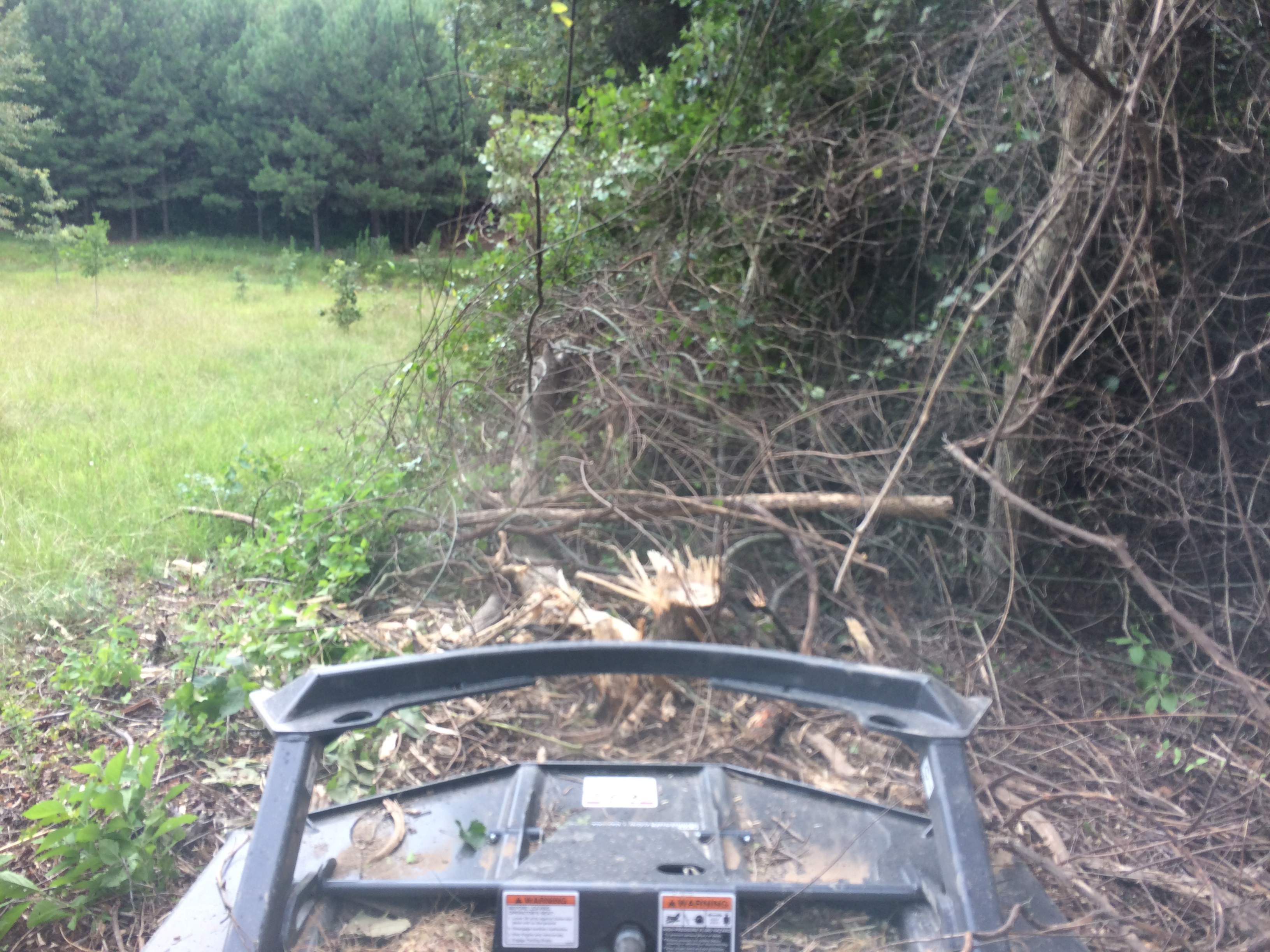

I got my Ground Shark in yesterday, it's a beast!
Here's a decent sized gum, took 4 minutes to cut and process it.
Didn't time these, but still, it does great!

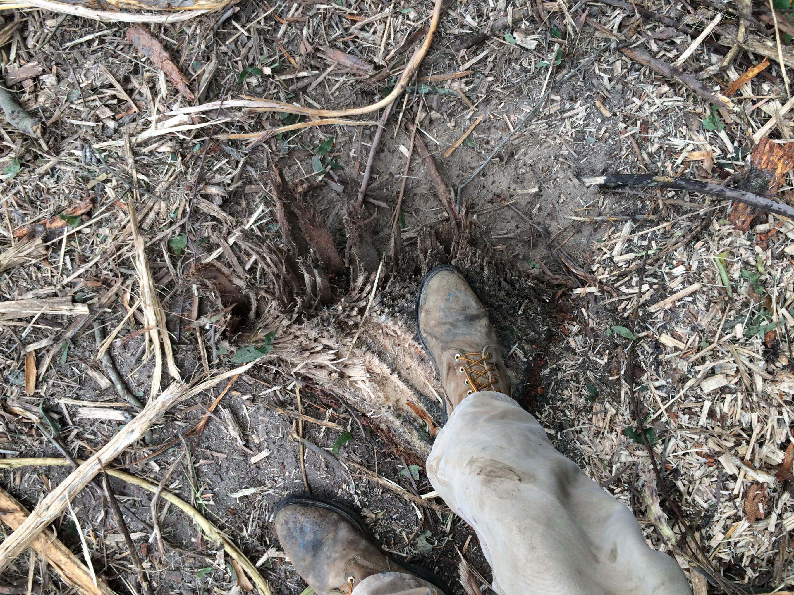

Here was the biggest hickory I took down. Size 14 boot makes that a 16" stump, roughly. This tree took 16 minutes to process. The blades were dull going into this tree, I'm curious how much difference that will make.

Am I reading this right, you just got the Ground Shark but when you did the Hickory tree the blades were already dull? Let me know since I am deciding between a Diamond mower and the Ground Shark.
/ bradco ground shark #19
I had an "issue," or perhaps "conflict" is the better word, with the safety chain that fouled the blades pretty well. I took care of that issue.
The knives are nearly as sharp as chipper knives, roughly. The mowing in the video didn't appreciably wear the blades.
