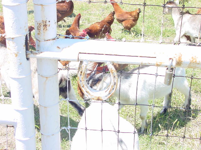

   / braided rope horse fencing #13
This is a picture of one of my gate latches. It's an early one and the little lock on the end is a homeowner misadventure cure of a problem that doesn't exist.
A couple of things to notice about the gate. First and most importantly is the gate is just a tad bigger than the opening. Around livestock I always do this unless there's a compelling reason like the gate is part of system to move animals from pen to pen.
I always try to set it up where if the animal works the latch open or someone doesn't latch it the animal has to pull the gate towards themselves and then walk around it.
Another reason for that logic is if you're entering a pen and the animal is dangerous you have the gate between you and it. And if you're leaving in a hurry bringing the gate closed behind you is a natural and good thing. Something you can't say if the gate passes all the way through.
Anytime there's the option of that gate being left open, say like between stalls or pastures I try to use one hundred and eighty degree hinges so the gate will lay flush against the fence and not be out there to be in the way. And with a hundred and eighty degree hinges the easiest way to ruin them is to run them over which you will do with the gate not stopped at the latch post.
Most folks look at the two horse shoes and thing "that's cutesy". What they don't see is they are there for a purpose. First thing is the back one is welded to the gate frame. The front one is welded to the slide bolt. Soooo if you put a padlock over them cutsey becomes the locking mechanism. If you're a homeowner you can look out at the gate to the pasture. If you see one horseshoe then chances are the latch is closed. If you see two horseshoes side by side then you can be positive it isn't latched.
Horses and cows undo latches by worrying them. When this latch is inside with the animal I weld a little tab so that the horseshoe on the bolt has to be lifted all the way up and then intentionally slid sideways to get it open.
I've had some customers prouder'n bad parents about how their horse could undo latches. I've never had a customer call me and tell me their horse was smart enough to undo mine.
These are just some simple rules on gates and livestock I've come up with. At the Ft Worth Zoo the gates I did there open out to latch together to make a pathway between pens across the railroad tracks.
Another customer had a system of working her cows where she wanted what she'd been told was the impossible. The gate was to lay flat against the fence ninety nine percent of the time. But occasionally it was to be closed. And every now and then it was to go the other way to catch another gate to allow cows to move through another pen.
It took some doing but I figured out and installed a working two hundred and seventy degree set of hinges for that gate, pipe, fourteen feet by five feet with a horse panel welded to it. And it worked and works still.

   / braided rope horse fencing #14
Harv, thanks for all the great info. I really like your thinking about making the gates larger than the openings. It sure does make sense for those areas where you do not need the gates to swing both ways.
My question was not so much about how to keep the fence itself from leaning, as I think I have a pretty decent handle on that (shorter post spacing, longer posts deeper into the ground, more concrete, mix the concrete, and clean out the holes well), but rather on how to keep the fence, especially the woven springy types from stretching out and eventually looking more like a giant slinky than a nice straight fence. I know that hot wire would be one way, but I really do not want to use hot wire. I just don't like it... I know that it works well, and is cost effective and many people just love it, but it is not for me.
Please keep those pictures coming, your work is certainly something I am interested in seeing more of. Thanks again for the help.
