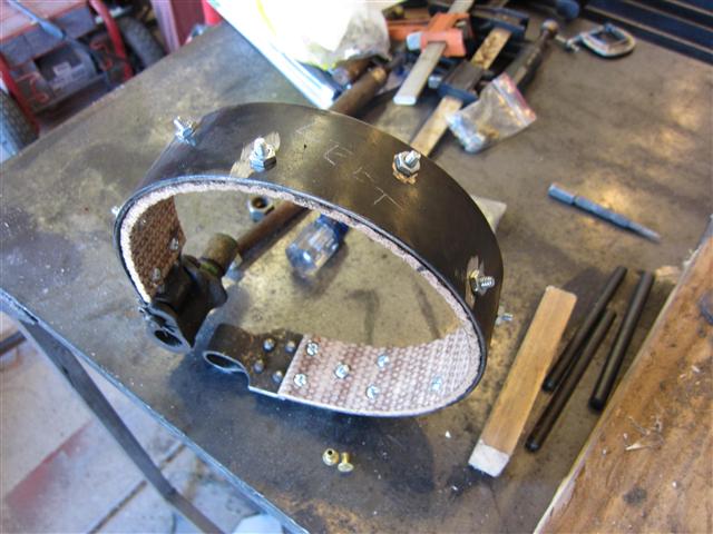

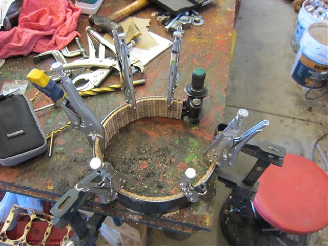

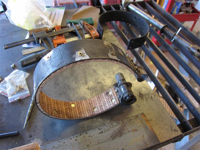

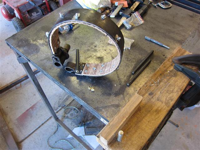

I just relined the brake bands on my 1945 Oliver 60 Row Crop tractor. Found out that very few places will do that type of work here in CA because of air pollution regulations.
You can get the material from McMaster Carr (lining material and rivets). Use a bunch of vice grip pliers to clamp the linings to the band. Used the holes in the band as drill guides to drill holes in the lining. Ground the point off a 3/8" twist drill to make a flat bottom counterbore and drilled the lining.
Attached the lining to the band with nuts and bolts. Replaced the nuts and bolts with rivets, one by one. Used a transfer punch to set the rivets.
