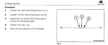

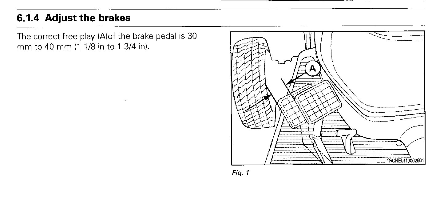

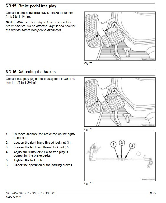

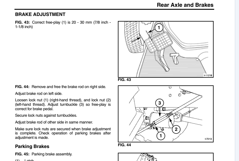

I remember watching a youtube vid a while back, a [AFFILIATE=1, nofollow=true, newwindow=true, title="Kubota"]kubota[/AFFILIATE] bx channel guy, and he was constantly hitting the brake (even level ground) as he would easy of the hst pedal. Somebody even commented on that, and he kind of responded that it's a habit for him. I was thinking he outta break that habit.
Anyways, I would try Hube's way first, completely loosen the linkage, and then check to make sure the brakes don't work at all. If that's the case (hopefully), the linkage just needs to be adjusted.
