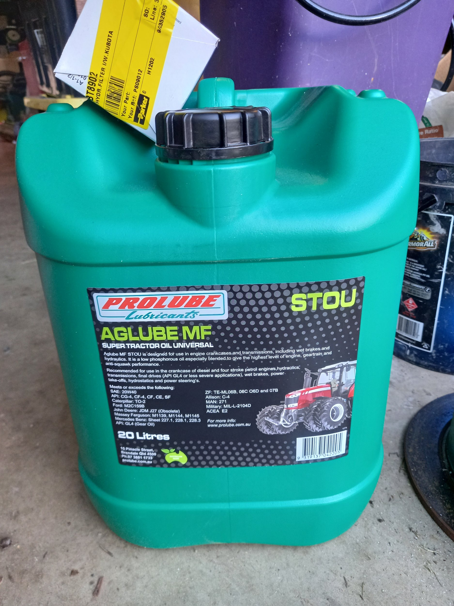

#12
Hey bought this today should be the same as OEM 20w 40.
I'll change it on the weekend all 11 litres .
Also I have backed off the brake adjusters.
While it up on jacks I will lube everything and see how it goes.
Thanks to everyone for your help and advise I really appreciate it .

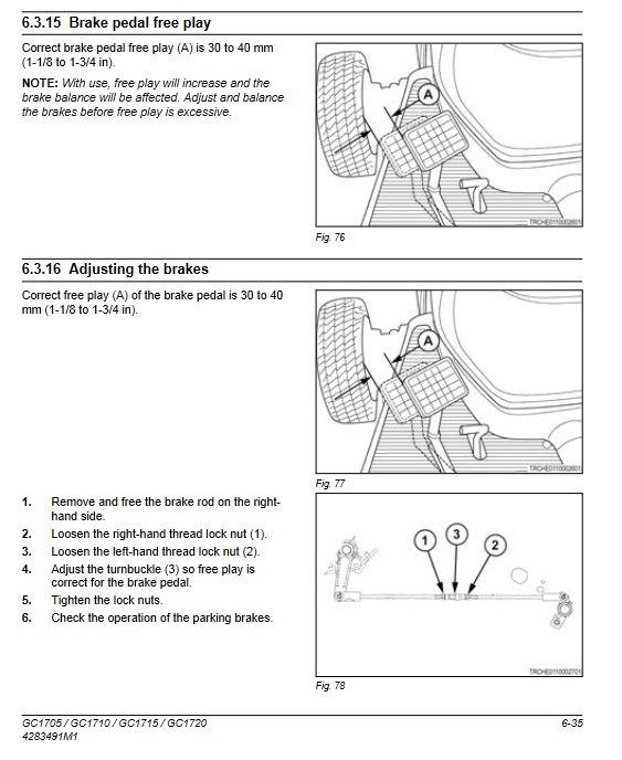

   / Brakes locking up GC2400 #15
For what it may be worth..... This is for GC 17XX series which seems to be about same as GC24xx series....
Not mention of spring in my manual other than brake parts diagram shows it does exist....

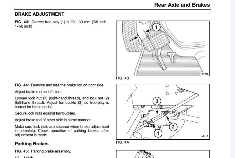

   / Brakes locking up GC2400 #16
on 2400 correct free play on pedal is 20-30mm
cant find spring info, may have been dealer telling me what to look for. but if you can manipulate spring easily one handed...its worn

Hey thanks for everyone's advise , I think I know why.
Did for Hyd oil change and filter and also pulled out the intake filter which broke while pulling it out, broke because the inner oring jamed it in.
Anyway was looking at my service book this arvo and is said the last hydr oil change was at 250hrs and now it has 724hrs. Maybe I didn't record the last change but everything is easy to use that tells me that old oil was worn out.
Hopefully after abit of driving around the brakes will be perfect.
