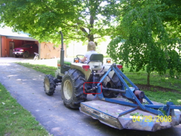

I think what you may need is a lower link stabilizer. One on each side which connects to holes you should have in you lower link arms and to mounting pins under the rear axle housing. They will help with the scraping when u turn. Here are a couple pictures. Not real clear but all I have right now. I put a little red square in the one photo around what I'm talking about.
