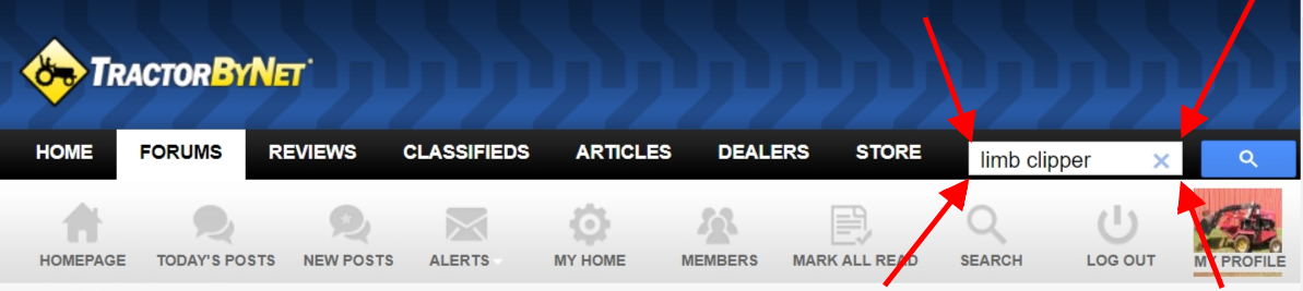

You evidently didn't use the Custom Search at the top of the page:
Lots of threads here on TBN: Search Results - TractorByNet
