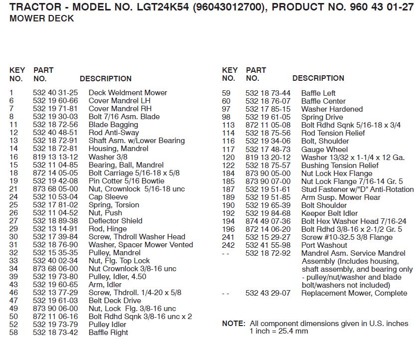

Could you reference those numbers on a diagram please so we know that we are looking at the same thing.
Sure Tom. See below.

Wow. This thing is really kickin my butt. I've been wrestling the deck out from under and reconnecting the belt a couple times every mow. To your point earlier, there is no side to side play in any of the mower blade pulleys, nor in the idler arm pulley; all 4 are brand new and tight. The other 2 idler pulleys, if that's the correct term, one (#52 toward the right side of the deck as you look down at it and facing forward), has just ever the slightest bit of play - almost negligible. The other one, #39, that the tensioner arm pivots on/about, is snug.
Every time the belt jumps, it jumps off the DRIVE (#12 or #11) pulley.

11 or 12 pulley doesn't seem to fit with this diagram. Normally these will launch a belt at the flat idler on the tensioner. Hence a good place to put an extra guide.
   / Brand new mower deck belt keeps jumping off
#34
Ah, ya got me there. #11 and/or #12 is the drive pulley under the clutch & engine. I can get that schematic but thought it was self explanatory.
