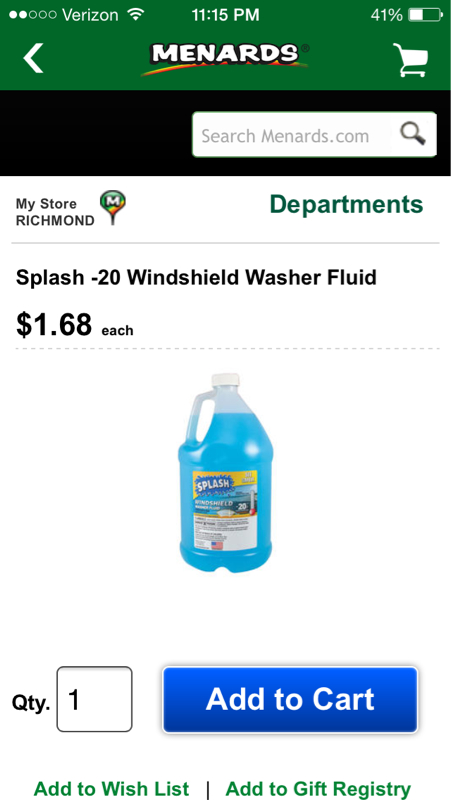

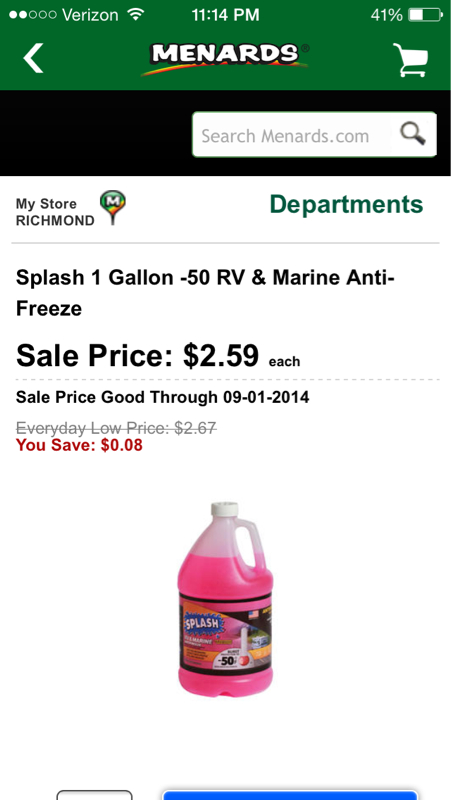

So how much is a gallon of rim guard? I too saw the $3 RV antifreeze at TSC today. I see the antifreeze is good down to -50. How much water could I add to it and have it at about -20. I need 72 gallons in each tire and still at $3/gal that adds up quick.
   / Brand new tractor - should I load the tires myself? #13
If you have a Menards nearby you can get it even cheaper.
