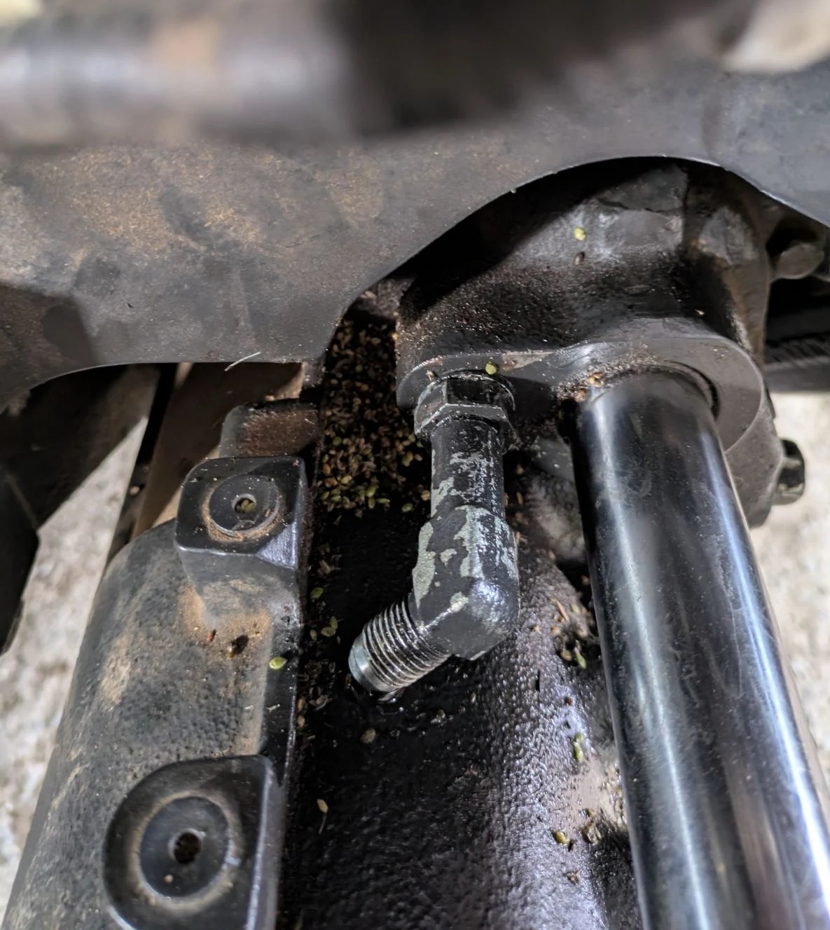

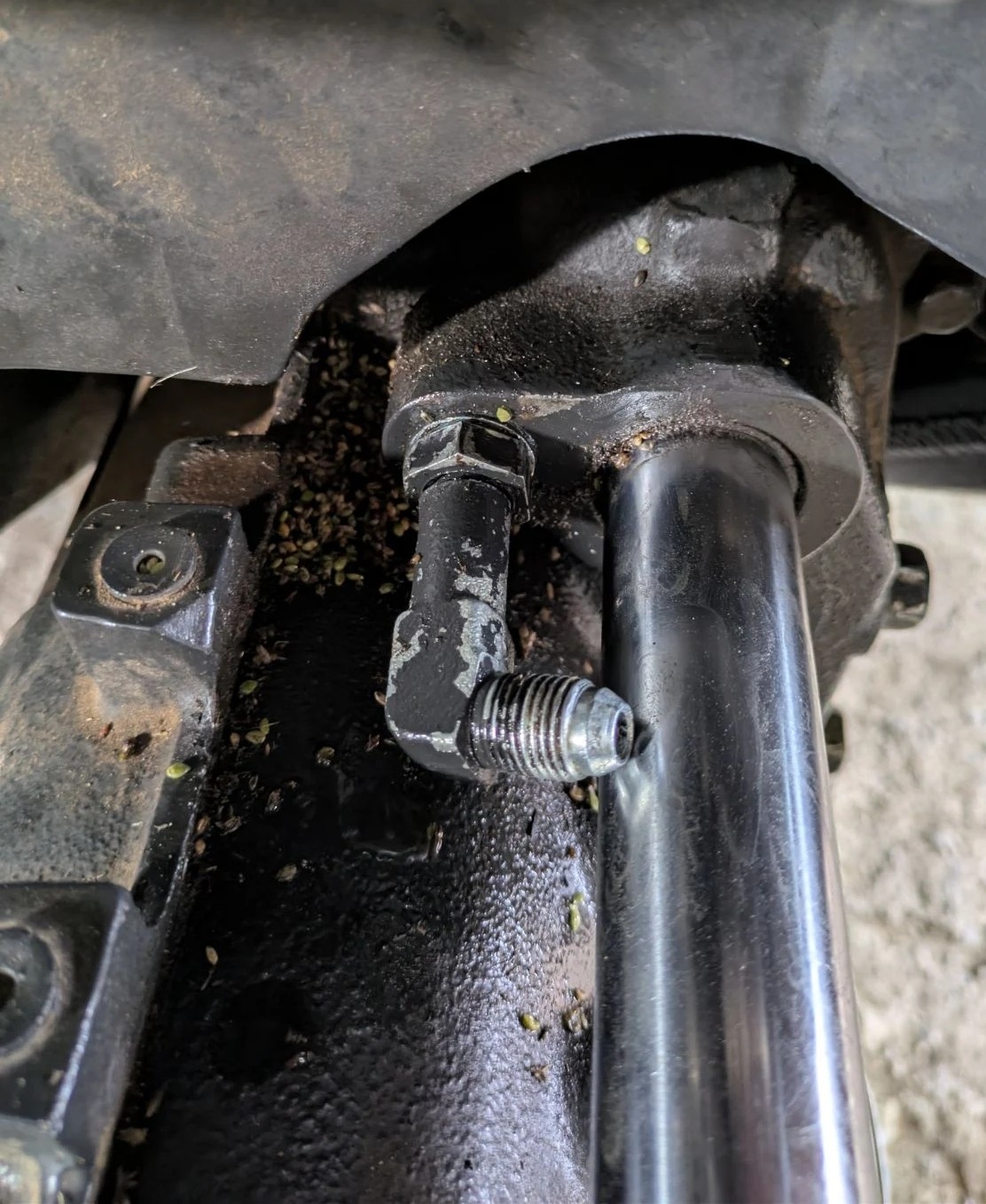

I have a leak coming from an o ring at an elbow joint in the power steering assembly. It should be an easy fix, but I can't seem to figure out how to remove the elbow without removing the whole assembly. The elbow can't turn to loosen without hitting the cylinder one way and the axel turning the other way. Any tricks or advice?

Can you share a picture?
If it's like mine, I'm pretty sure the end cap of the cylinder has to come out or at least slide out so the fitting can spin around, but I need to double check that on mine.
