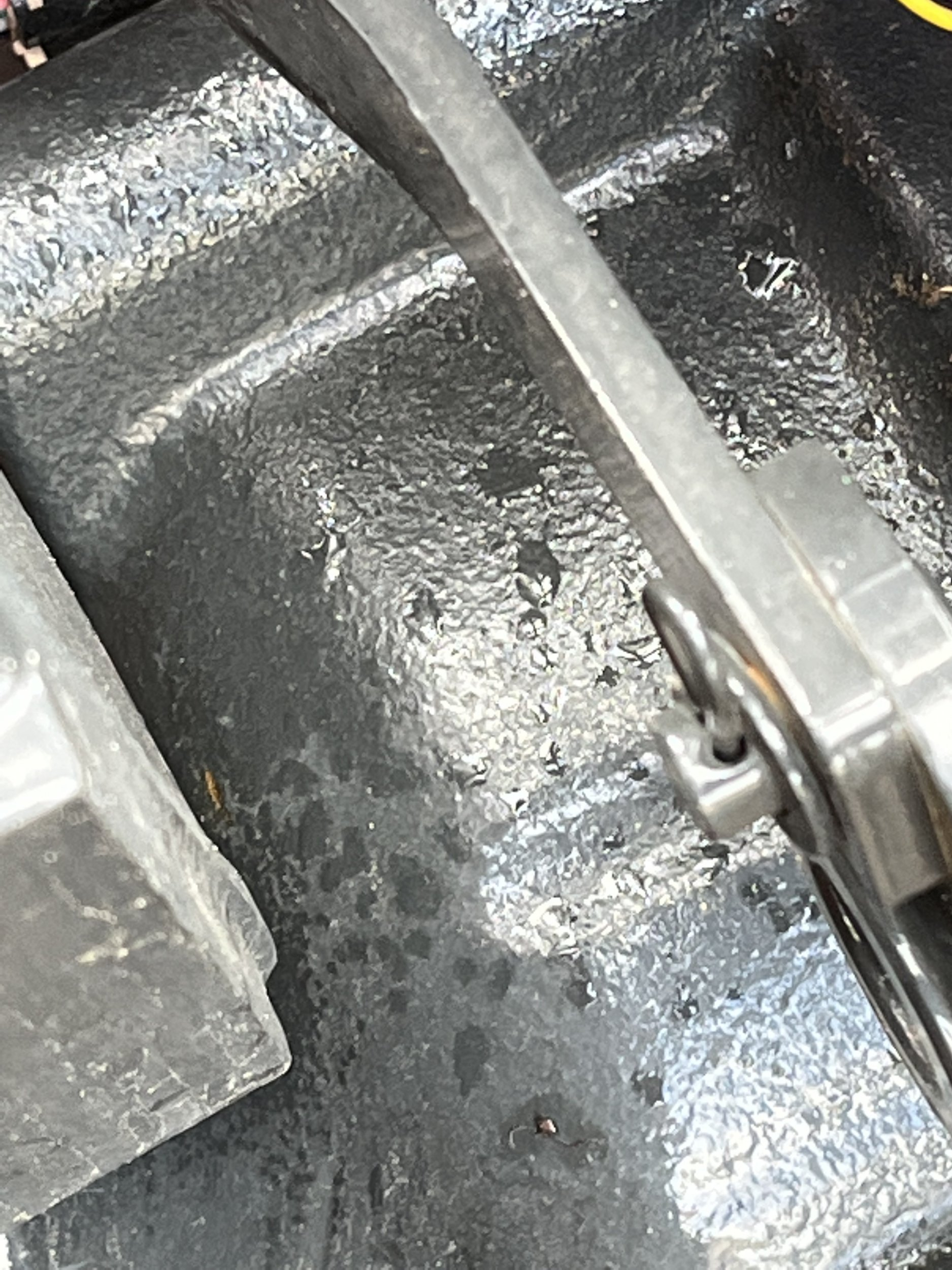

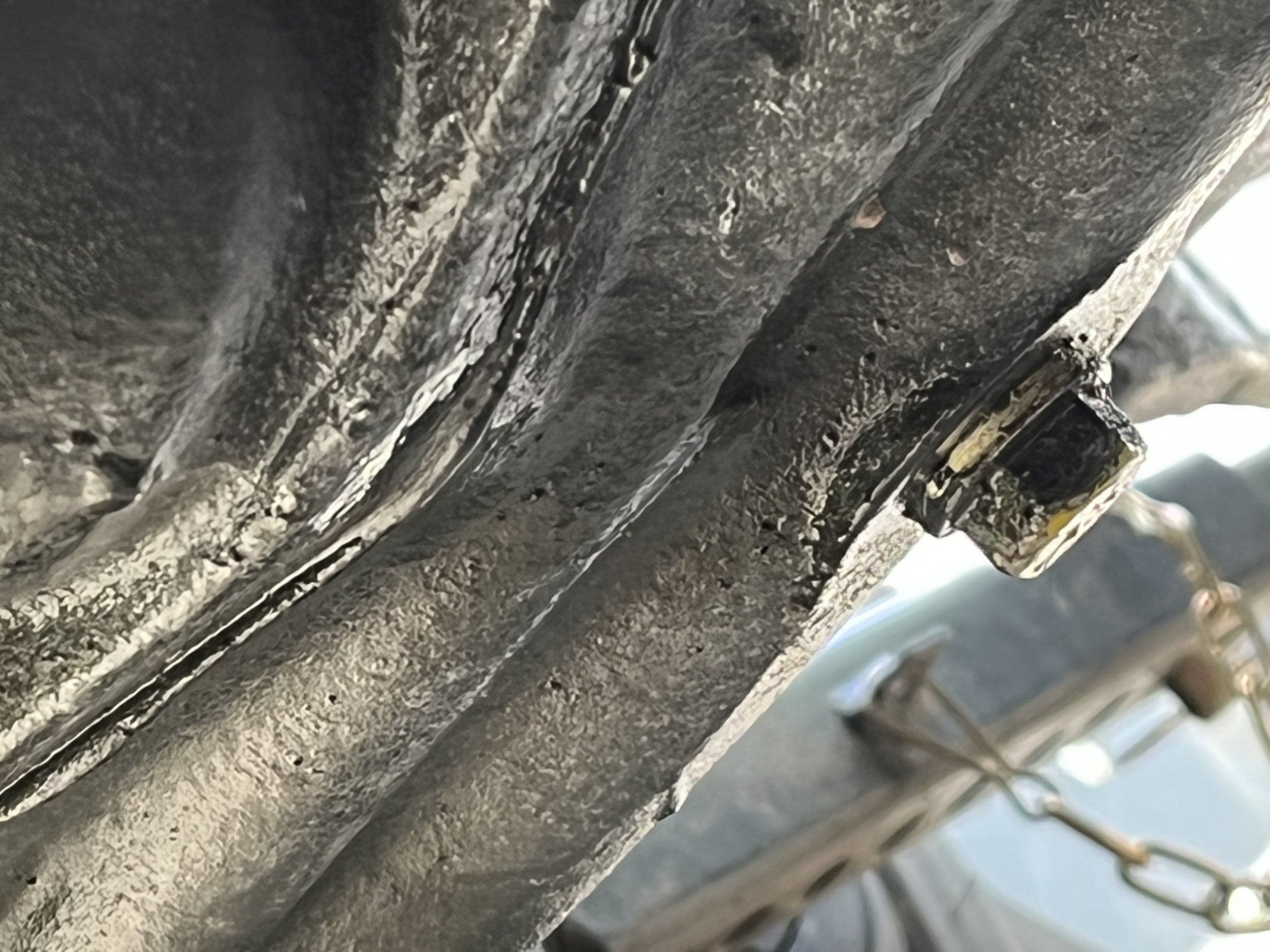

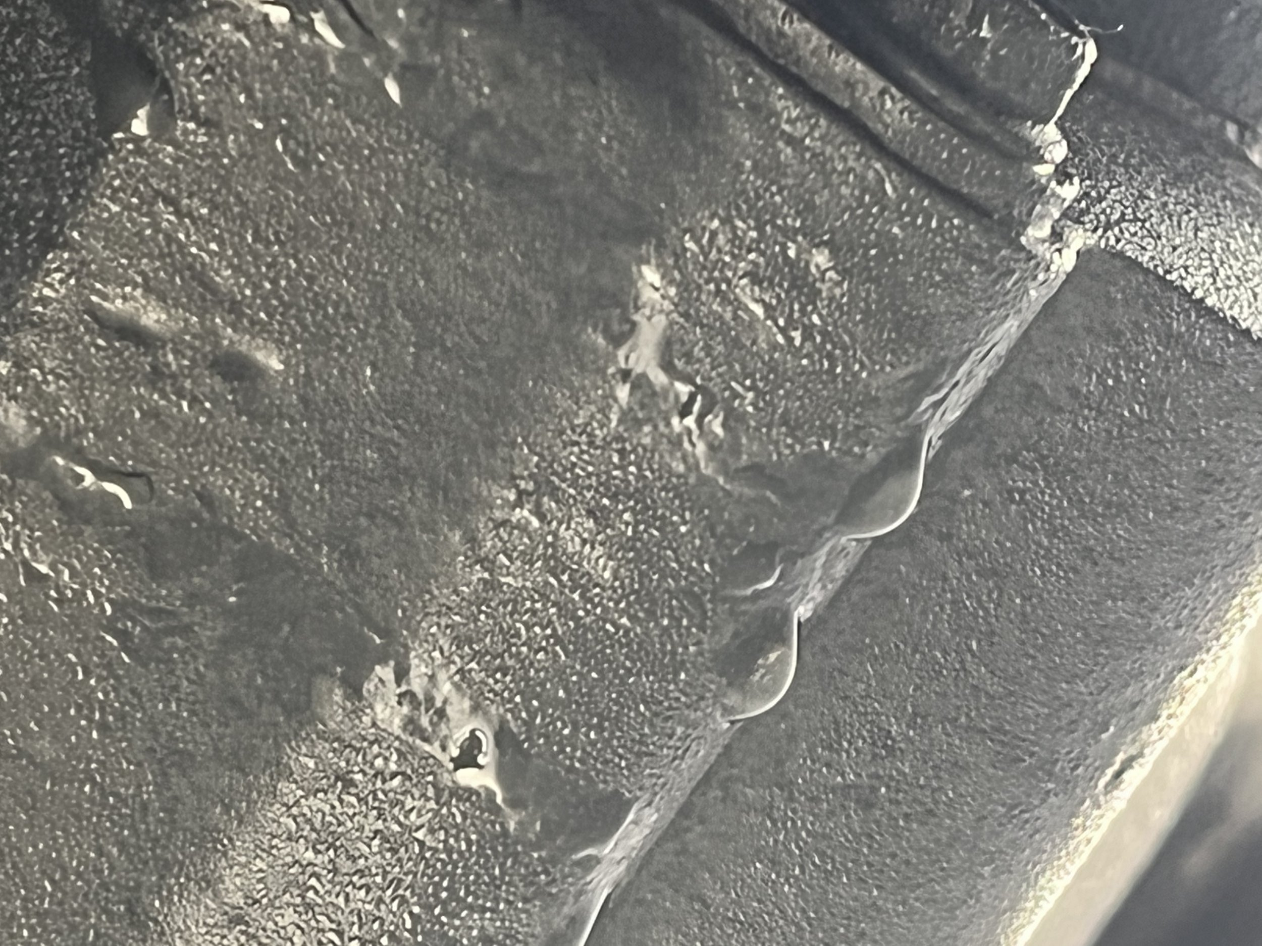

2020 Branson 2515H is going to the Dealer for an oil leak. I had the tractor warming up and I was going to hit the grease zerts underneath and there on the back axle was drips . Then I found droplets on top of the axle. I will up date when I hear what’s wrong .
I checked the dip stick and it was barely on the end but below the hash marks. When the tractor got warm the dripping stopped . I moved the one tree that was down and put the tractor away . Everything seemed to run perfect.

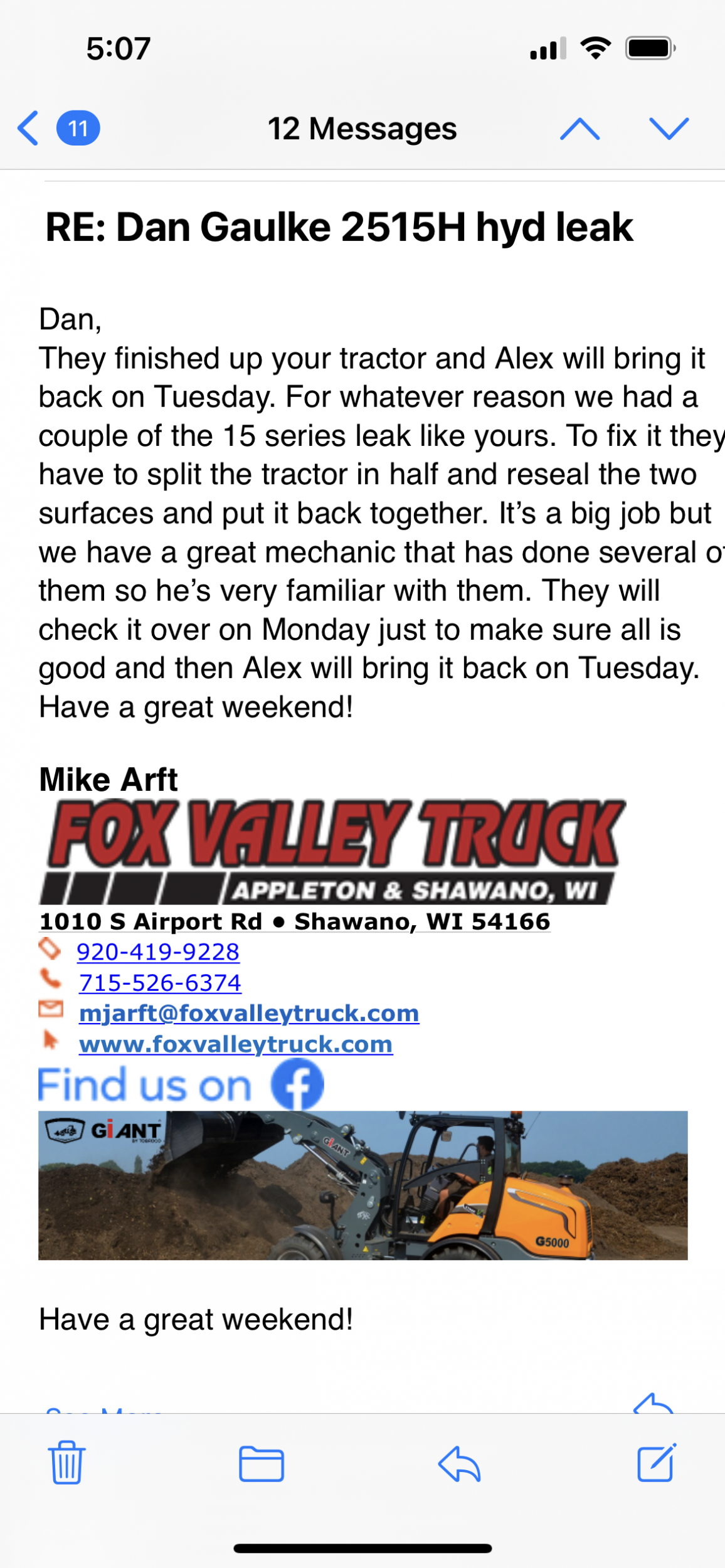

Well good news the Tractor is back and working great . I have to give a big shoutout to Mike at Fox Valley Truck in Shawano Wi 👍👍 they went above and beyond to pick it up and get it done . Excellent Dealer and would recommend them to anyone . This was the response below .
