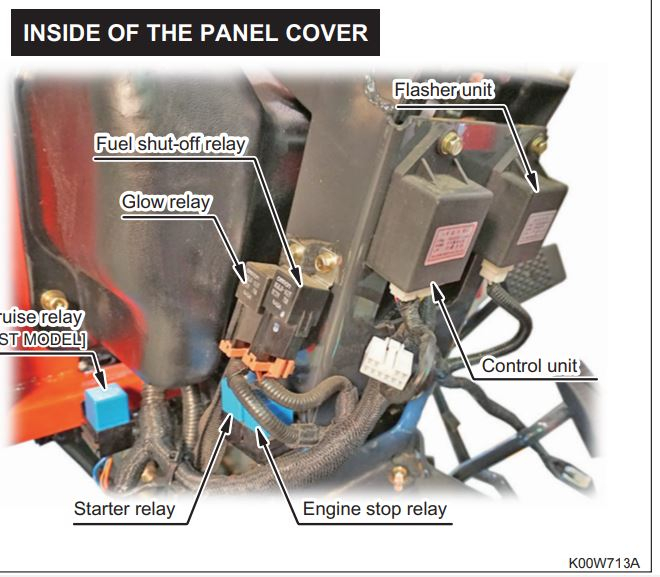

As you can see from the picture of the back side of the panel, it is hard to determine which is the ground connection (or any connection). With the wire harness exposed, I have tried to cause the panel to fail by force. I can't replicate the issue. Without a wiring diagram it is hard to guess. Perhaps the panel is powered through one of the relays. There is a panel fuse, but it only affects the lights for the battery, oil, glow-plug, and break indicators. Why are there three wires to the fuel solenoid? I could try pulling the relays one at a time to figure out what they control.

@Asteral just posted a link to a service manual that has a component layout and wiring diagrams. This will take some time to study. Here is the link to the Google drive document: 24002510 service manual.pdf
   / Branson 2610H second gauge panel to fail
#14
This is interesting, there is a Fuel shut-off relay and an Engine stop relay. What does the Engine stop relay control?

The three wires going to fuel solenoid are ground, one for main start pull-in power and 3rd wire is lower voltage- amperage hold or run circuit. This reduces the temperature rise in the solenoid and reduces premature failure.
Without studying wiring diagram not sure why have both fuel shut off relay engine shut off relay. Possibly a fail safe where two components must fail to prevent engine shutdown

Thanks @oldnslo, The service manual (with wiring diagrams) that @Asteral provided helped me to figure some things out, like the difference between the Pull and Hold circuits to the fuel solenoid. So, the engine stall issue could be caused by the engine stop relay as suggested by @Number15. I'm still unsure of what causes the gauge panel to fail periodically. The indicator lights are controlled through the Control unit, but the gauges and engine clock are controlled by a microprocessor in the gauge assembly. Any interruption of ground or Vcc to the microprocessor could cause the gauges to fail. Time to check all the ground points as @Asteral suggested.

The engine stop relay may also be part of an interlock system to shut the off engine if the operator leaves the seat while the PTO is engaged (or something like that). The wiring diagram I have is for the 2400(h)/2510(h) series, and not specifically for the 2610H. There is an odd looking (inductive?) sensor next to a sliding metal plate actuated by the forward/revers pedals. It seems like the engine stalls only when I am backing up. Perhaps this is an interlock issue with this sensor. I will take a picture of it when I get home from work. Maybe someone can tell me what it is.
