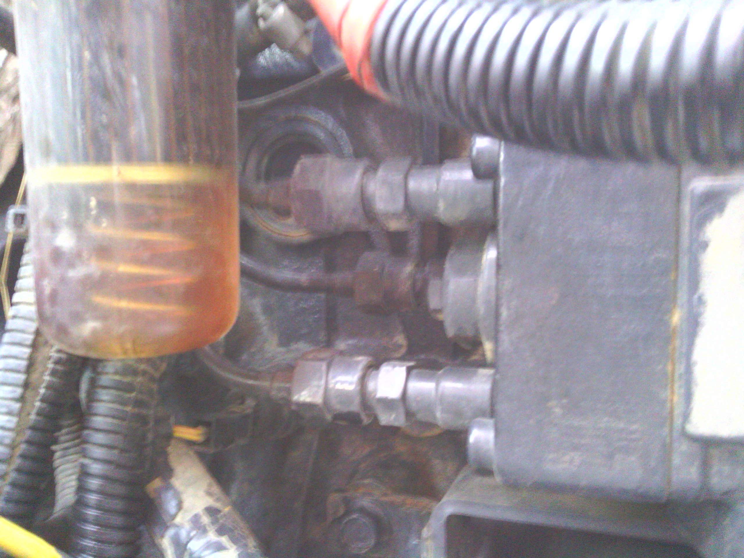

Could someone possible post a pic of the valve. I can't seem to locate it.
thanks
   / Branson 2910 warranty work #12
thanks
I know this is an old thread, but if anyone still has a problem finding this;
Look at the line of injectors.
Find a tube that links them together, this is close to the cylinder head.
Follow it from the forward cylinder down to the top of the injector pump, where the check valve is mounted.
The other tube from that valve goes back toward the firewall to the tank.
Doubtful that anyone still needs pictures, but I will take some if anyone wants them.

My question is do you take it out completely or do you put it in the return line. Both lines have the same looking check valve. No one has said if you remove it completely or move it to return line. I also would like to picture of before and after. The Branson 2910 I have is used so I'm new to this tractor.

This true about a pic. I can find the valve; but do I take it out and reconnect the line. Discarding the valve completely. It appears to have same check valve in return line so I would not need another one in return......Help me get rid of the excessive smoke on startup.......Thanks

Picture posted on 2910 warranty thread..Page 2...Need clarification on procedure
