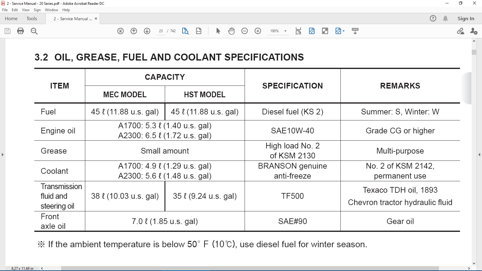

Have to replace some oil in my Branson 4020. Hard to tell on the sight glass but had a leak on my backhoe
Most of the oils I see online don't really give the specs. Saw some posts on here but cant find them now
The manual I found wasn't really any help. I remember seeing what to look for on here.

main thing is to NOT use 303 fluid, it's for old pre-1970's or so tractors. otherwise the relatively cheap tractor supply branded fluid works. I would suggest to put some in to get you back to the garage, then drain it and replace it with a suitable fluid if needed.

I saw the chevron and Texaco oil in the pic. No Tractor supply around here. I cant tell how much I need By the sight glass. looks oily inside and I see in posts it hard to tell if you put to much in. I have a cut in my hydrophilic line that goes to the top vertical hydrophilic unit on the boom of my backhoe. Thinking it might be a return line as my outriggers are still up. Don't know the ramification of that if its a return line. Need a splice kit for that. I had a spare but it turned out to be for the ends. Nothing is going right. Might just fill the fluid up and move it.

When I look for a hydraulic/transmission fluid two of the specs that I most closely check out are the IH hytran (Case MS 1206, MS 1207, HY-TRAN ULTRA) and JD "C" or "D" specs.
If the fluid is from a major manufacture and is labeled to meet or exceed the specs for these oils especially the hy tran ultra I have no issue with using it.
If you are a green user the JD "C" or "D" is the spec to meet or exceed.
