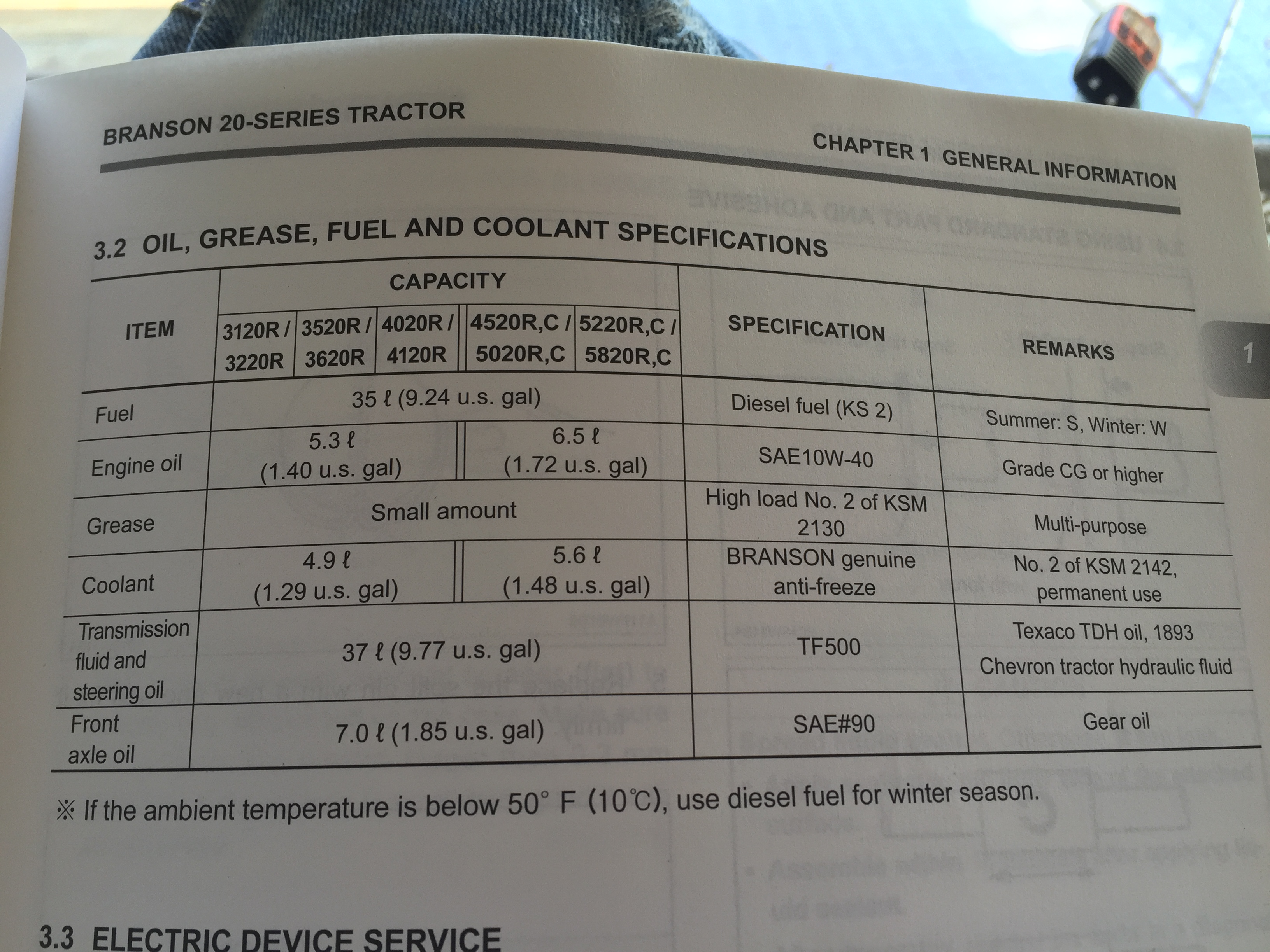

So I was changing my hydraulic fluid today for the 50 hour service. I had the Branson dealer send me a few filters including some for future use.
I get underneath my 2016 3520H and lo and behold, there's 2 hydraulic filters even though the Service Manual makes no mention of this, nor did the parts guy at the dealership. There's the long light blue one shown in the manual and a shorter darker blue one directly underneath it. They're connected by (more or less) a cast T assembly.
Has anyone had this happen to them?
Thanks.
   / Branson 4020R 50 hr service #12
Bob, our parts guy should have told you that you needed both hydraulic filters. Order up the filter you missed and tell Dillon that Dave is paying the UPS on that filter. Sorry about that. Regarding the fluid, the Texaco or Chevron fluids mentioned above are just fine.

   / Branson 4020R 50 hr service #15
BB - which manual did this come out of?
I didn't seem to get this one with my tractor :/
This is the service manual that I asked the dealer to throw in when I was negotiating the purchase.
The retail price for the manual is $258.
