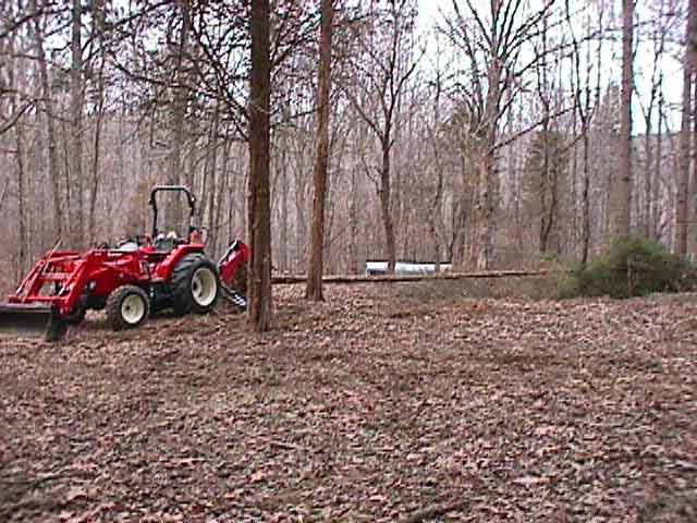

To Yooper Dave, I have a Branson 7620 BH (7 1/2 ft), made by ameriquip, running on my Branson 4020. I spent some time running it this weekend, and I would have to say it moves very quickly....I have to be careful not to bang my stops....( still learning). I am starting to prepare a wooded site for builing a barn. Today I brought down some 45-50 ft red cedars using the hoe. See attached picture.
