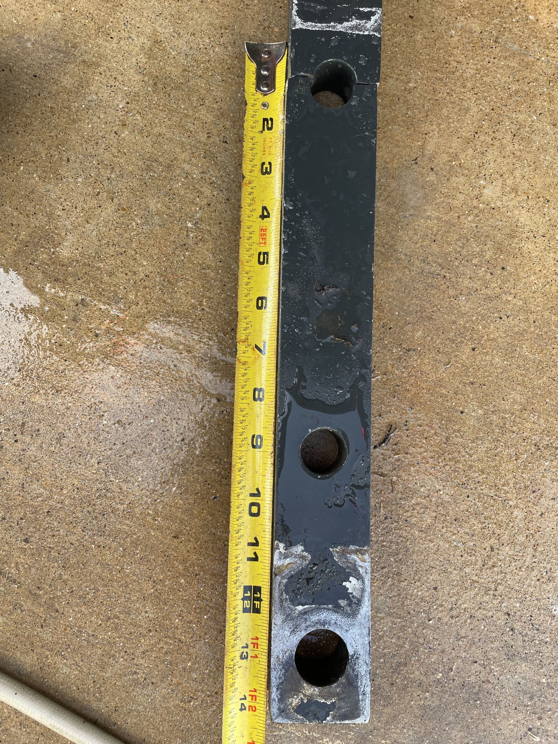

Hey Cougsfan, you're always the first to reply to my post! I was pulling an RC2512 land pride, rated for 40 to 100 horse power. It broke right where it meets the housing, you can see the grains of the metal where it sheared. It did bend a little before it broke, then suddenly I heard a loud pop, it bent my hydraulic remotes and ripped the hydraulic cable in the process. The tongue weight on mower says 793lbs and the mower is ~2500lbs. It was mowing and pulling extremely well until that point, but the terrain is a bit rough.

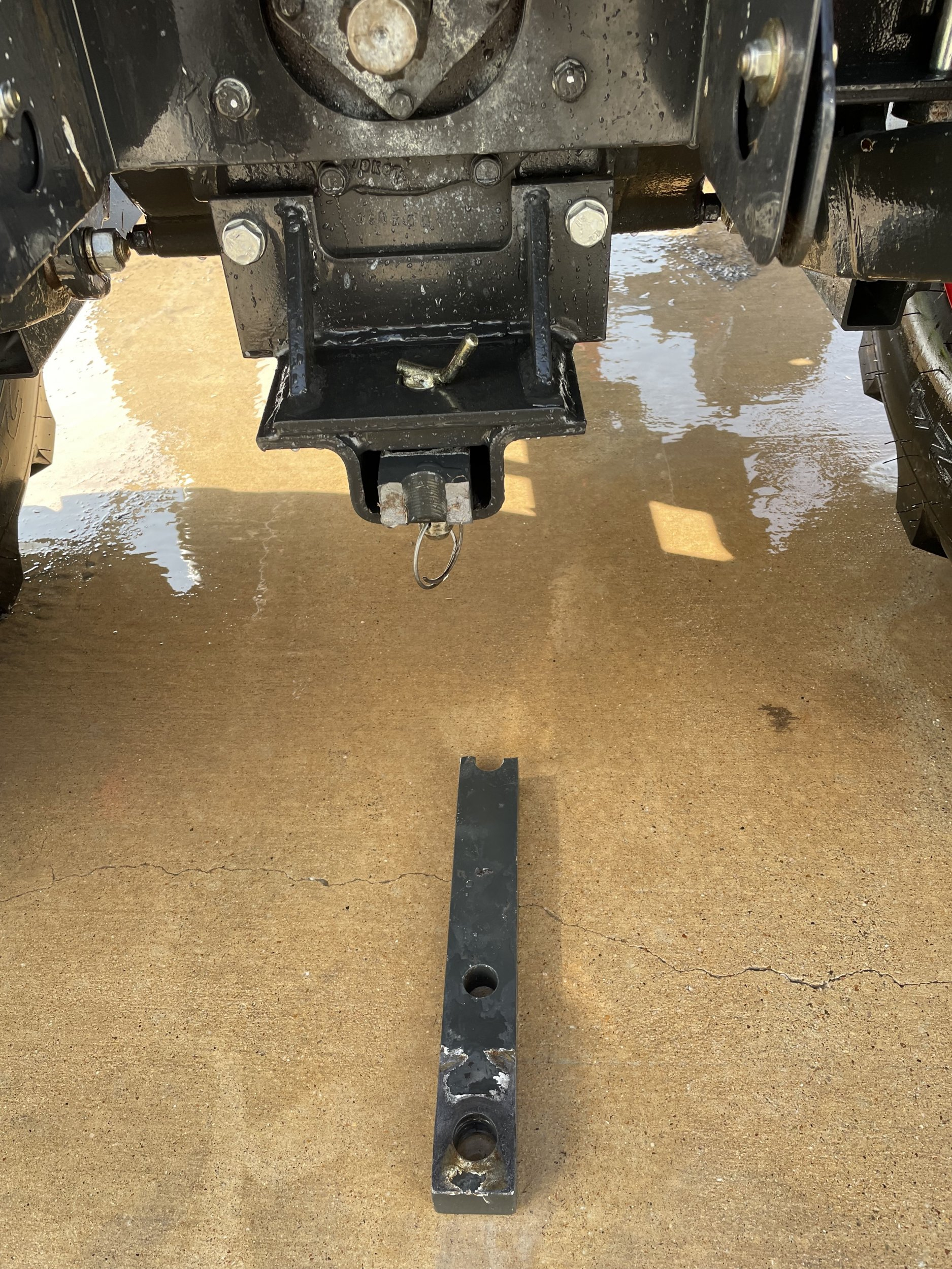

Those are good specs, I appreciate having something to generalize with. I did see that TTWT video, his problem was because he didn't extend the drawbar out 14" inches from what I remember, so the PTO travels too far into the case.

Thanks for the replies. After getting back to my tractor and examining it, it looks like as called out in this thread, the weak point is at the hitch pin hole that comes out right at the carriage where the 14 inch clearance is required.

Their appears to be some strange grain structure in the steel on the left side. Is that from being cracked for a period of time or a possible defect - imperfection in the steel?
I ended up making length of log chain that connected to the 3PH lift arms that supports the draw bar when 3PH is fully raised. This prevented all future broken draw bars. Do the same thing today with 1100 bushel grain cart on 8520 Deere.
I think it's dirty from hyrdaulic fluid getting on it after the remote got ripped up, I was spraying everything off. Do you have a picture you could share of how you support it? I'm curious how it clears the PTO shaft when making turns.
