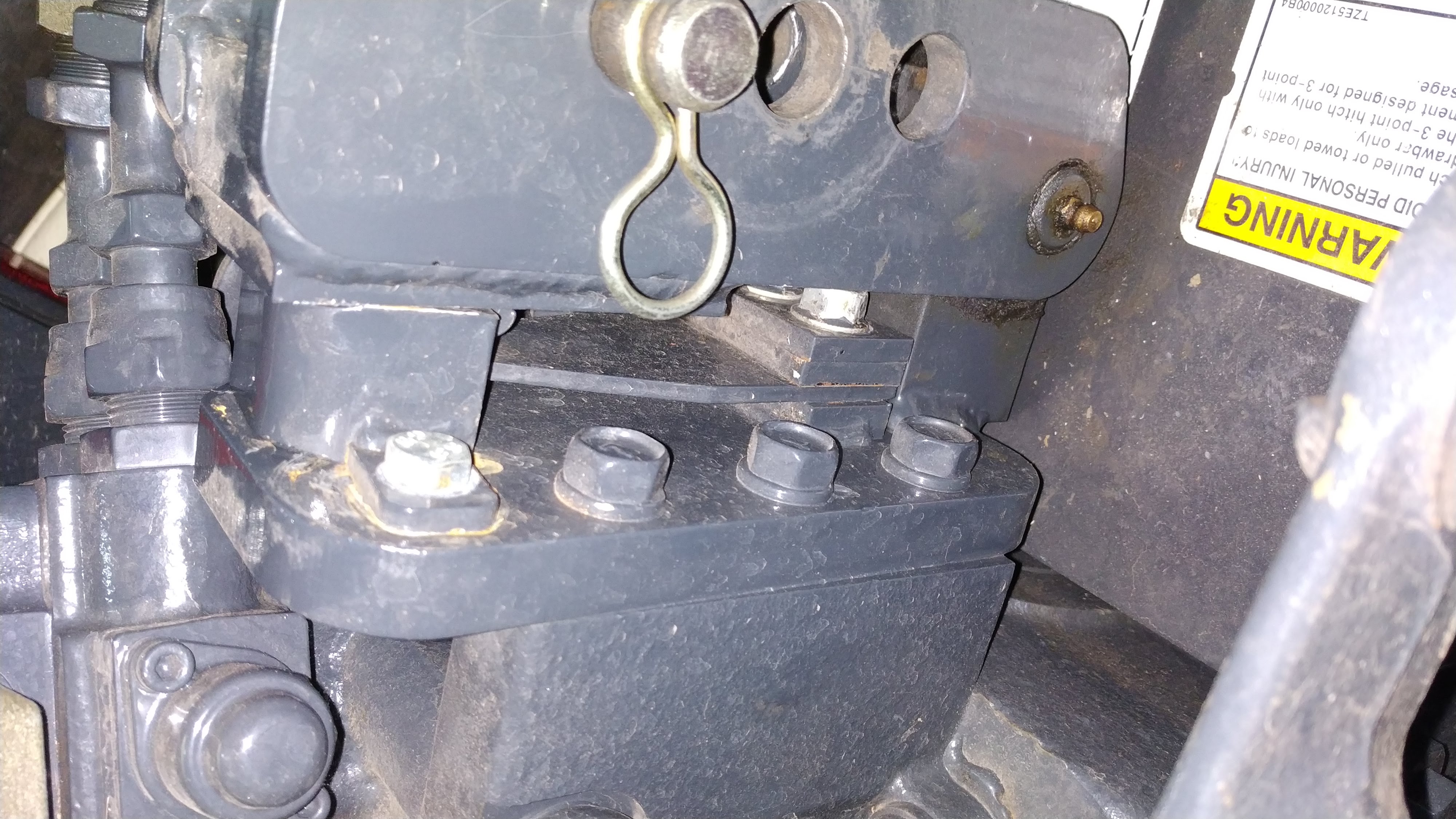

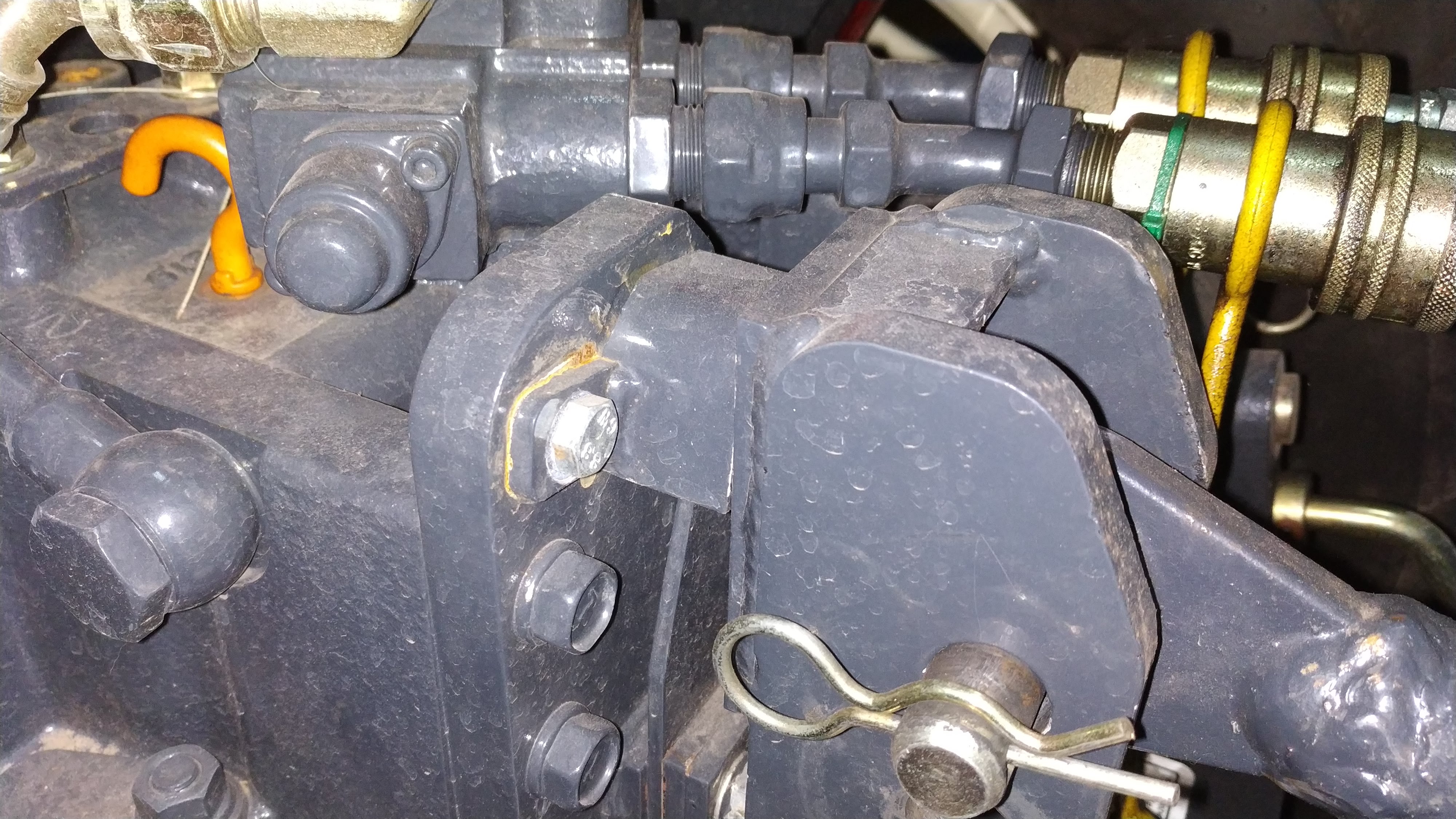

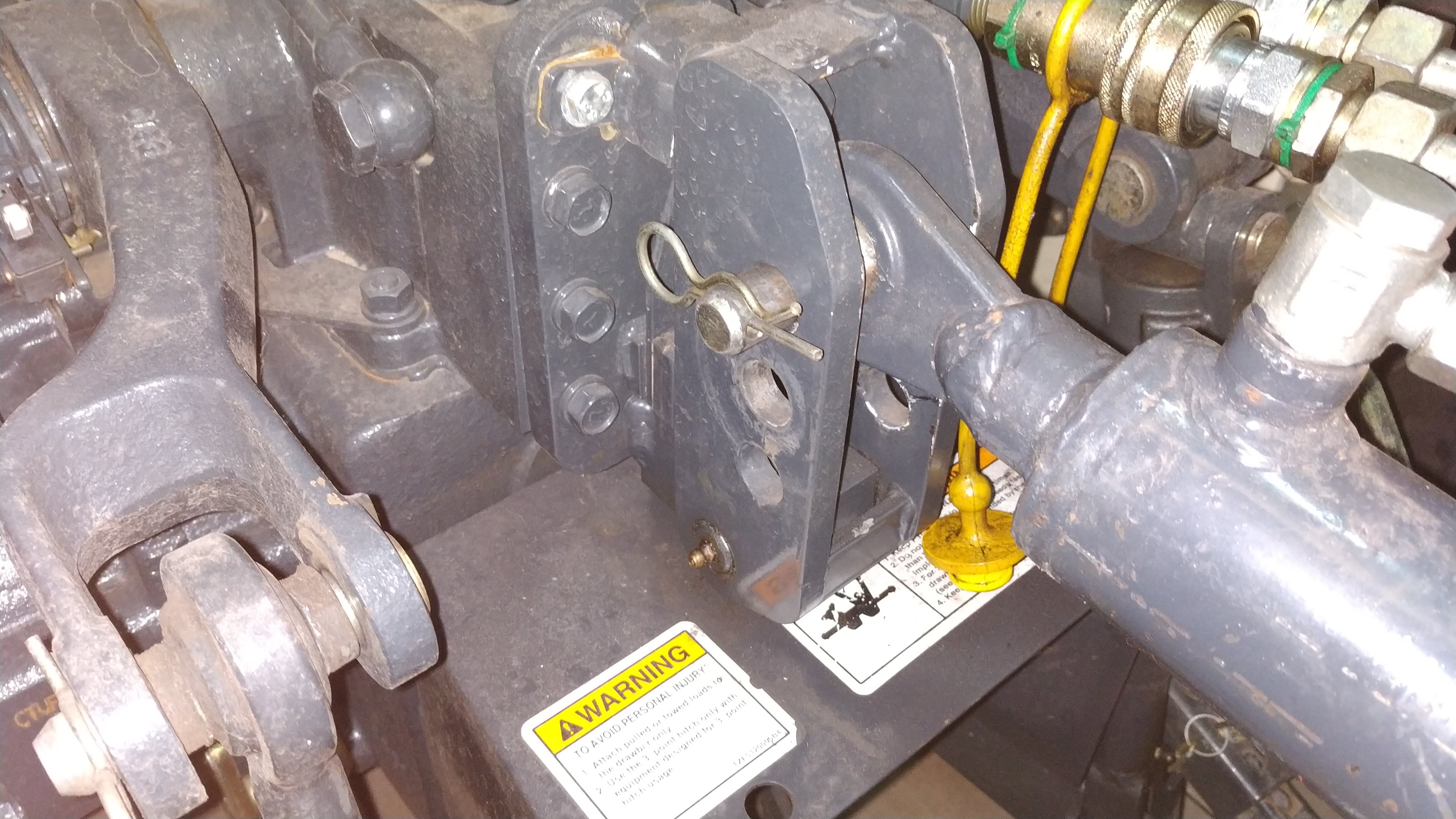

Took a couple of pictures of my tractor draft control. I think the 25 series is similar.
So the only thing I've found about how to properly get the draft control working, was on the 25 series service manual.
Overview of the whole top link mount:
This the locking tab that you flip either out or in, in order to allow the draft control to work:
This is the tricky part that has little to no info at at all. Behind the top link bracket (the one with the 3 holes), there is a two shims and a longer piece of flat bar. The tractor comes from factory with those 3 pieces in this order: Shim - longer piece - shim. At first, I thought it worked as a spring, turns out that it's an additional lock of the draft control.
So on the little info I found on the 25 series service manual, they say to remove all 3 pieces (shims and longer piece). After I played with the a little bit, I have those three pieces in the following order: longer piece - shim - shim. This allows for the draft control to work. By the way, those two little bolts holding these small pieces are REALLY tight. It's a 12 mm wrench but a socket with and extension works better. This is the picture:
Another thing to consider. On the top link bracket, there is 3 holes. The top hole won't allow the draft control to work also, because the top link end will hit a big M20 bolt inside. It's supposed to be that way. The middle and bottom holes allow for two different sensitivities on the draft control. Middle hole = more sensitive. Bottom hole = less sensitive.
