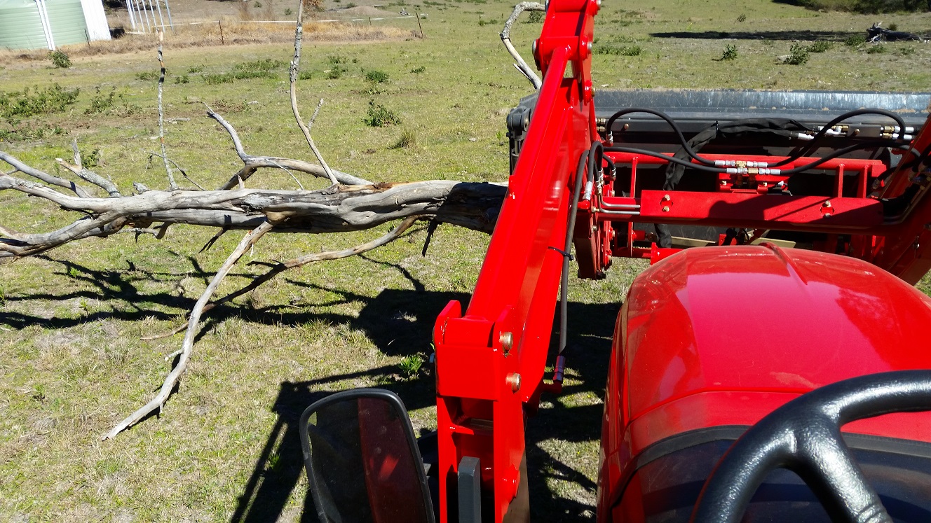

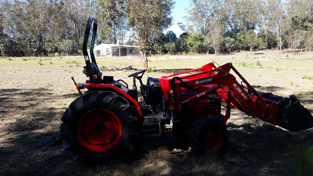

Slowpoke: Have only put a few hours on it so far practicing but no significant issues so far...few little niggly things (brake pedals unlock and separate...will need to shim\bend the latch to fix it, key hard to remove from ignition...graphite?) Transmission noisy in 3 but that is normal I think till it gets up to speed...manual rev adjustment a possible fix...other than that it seems fine.
