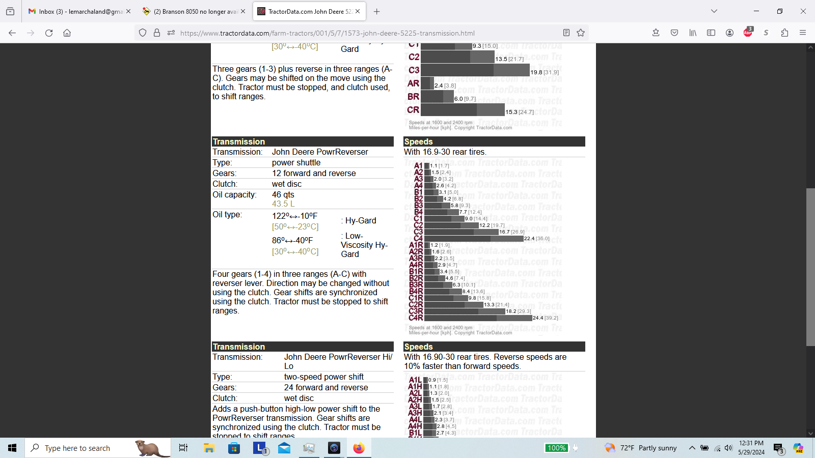

I have never figured it out for sure;
This is a possibility,
I don't recall were I found this info,
Branson 8050 to John Deere cross
The 8050 transmission, rear end, andfront end are identical design wise to a John Deere 5x25 series.
Model Engine HP PTO HP Engine Disp.Cylinders
5225 56 45 3.0L 5
5325 67 55 3.0L 5
5425 81 65 4.5L 4
5525 91 75 4.5L 4
5725 2006-2012???
