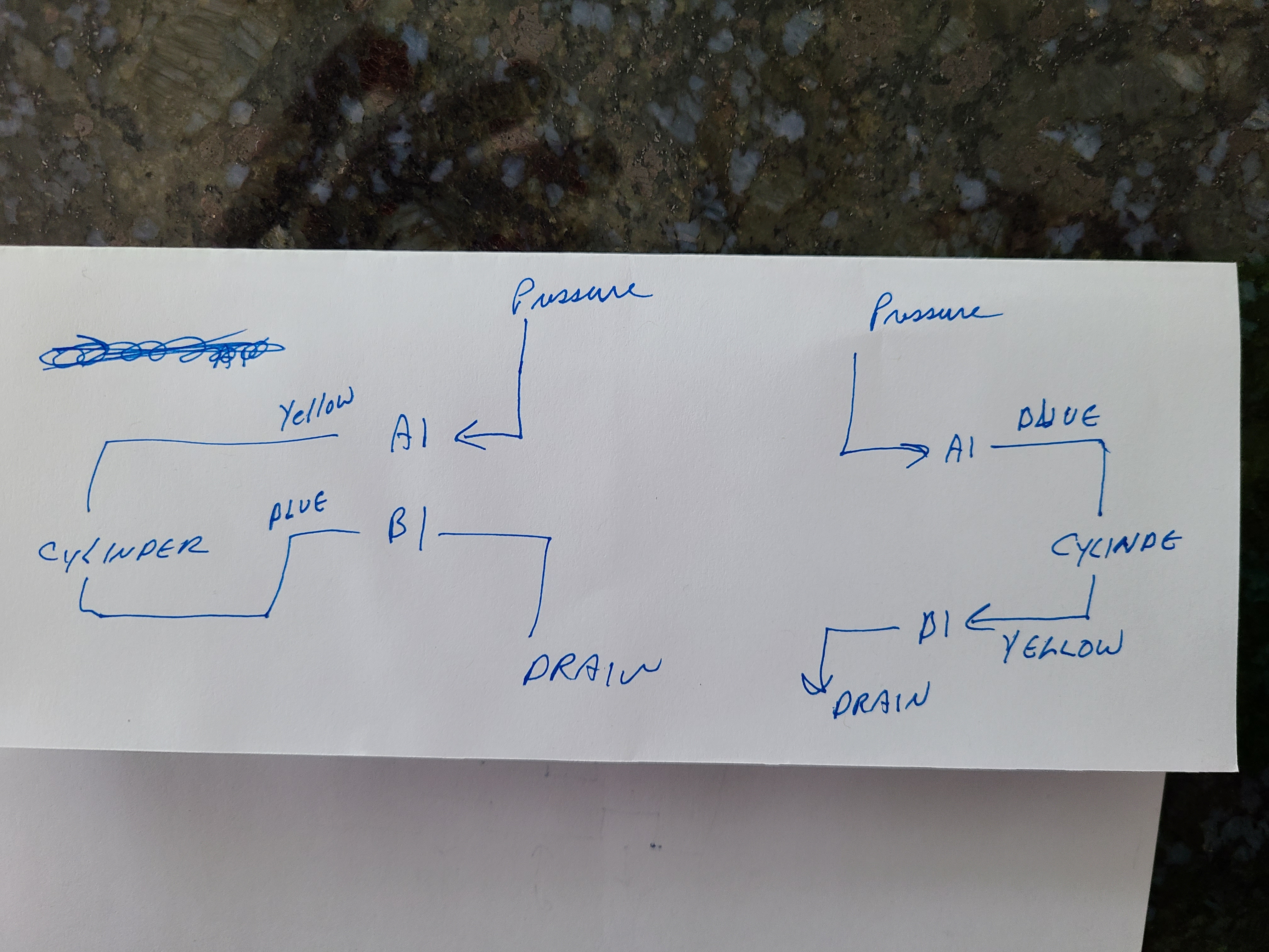

I don't see how.... So I've attached a drawing of how I see this working....excuse the crudeness of the drawing....
The hoses to the cylinder are color coded.... I swapped the curb and dump lines (blue and yellow) at the valve. In one config curb does not work but dump does. In the other config, curb works but dump doesn't....
Please explain to me where I have gone wrong here. Not being an a*** here - just looking to get educated. Last time I worked this kind of stuff I was in my teens and early twenties. Now I'm going in to my late 60's. :)
I do have a spare quick connect so once I get this put back together again and tried I'll swap it in on both sides one at a time and let y'all know what happens!!
Thanks!!
   / Branson BL25R control valve issue FEL / SCV valve #9
There is two quick connects for each port. A male and a female. When you swap the lines you are only testing one of the quick connects for each port. The other one is attached to your valve. This more than likely will be where your problem lies.
