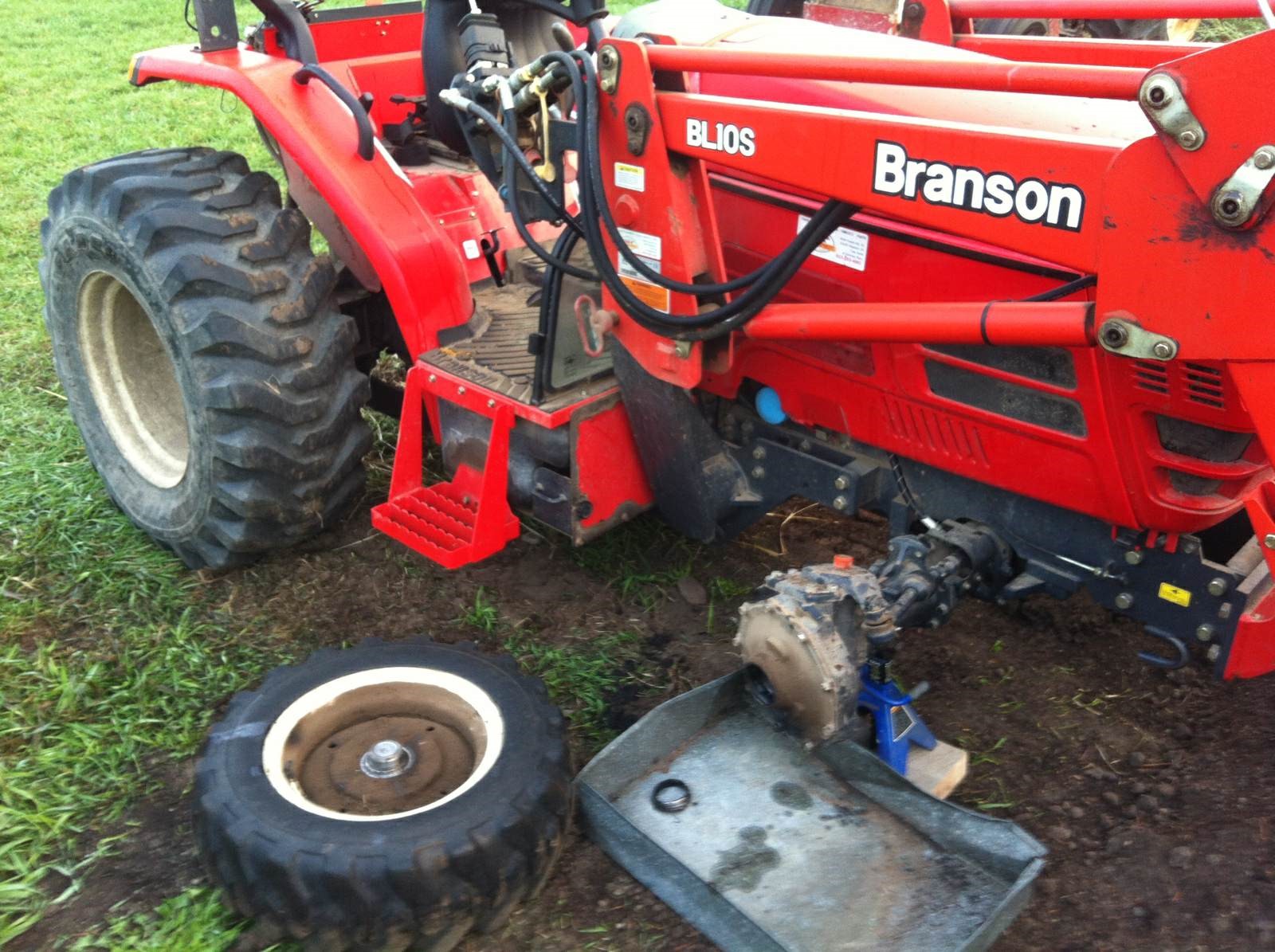

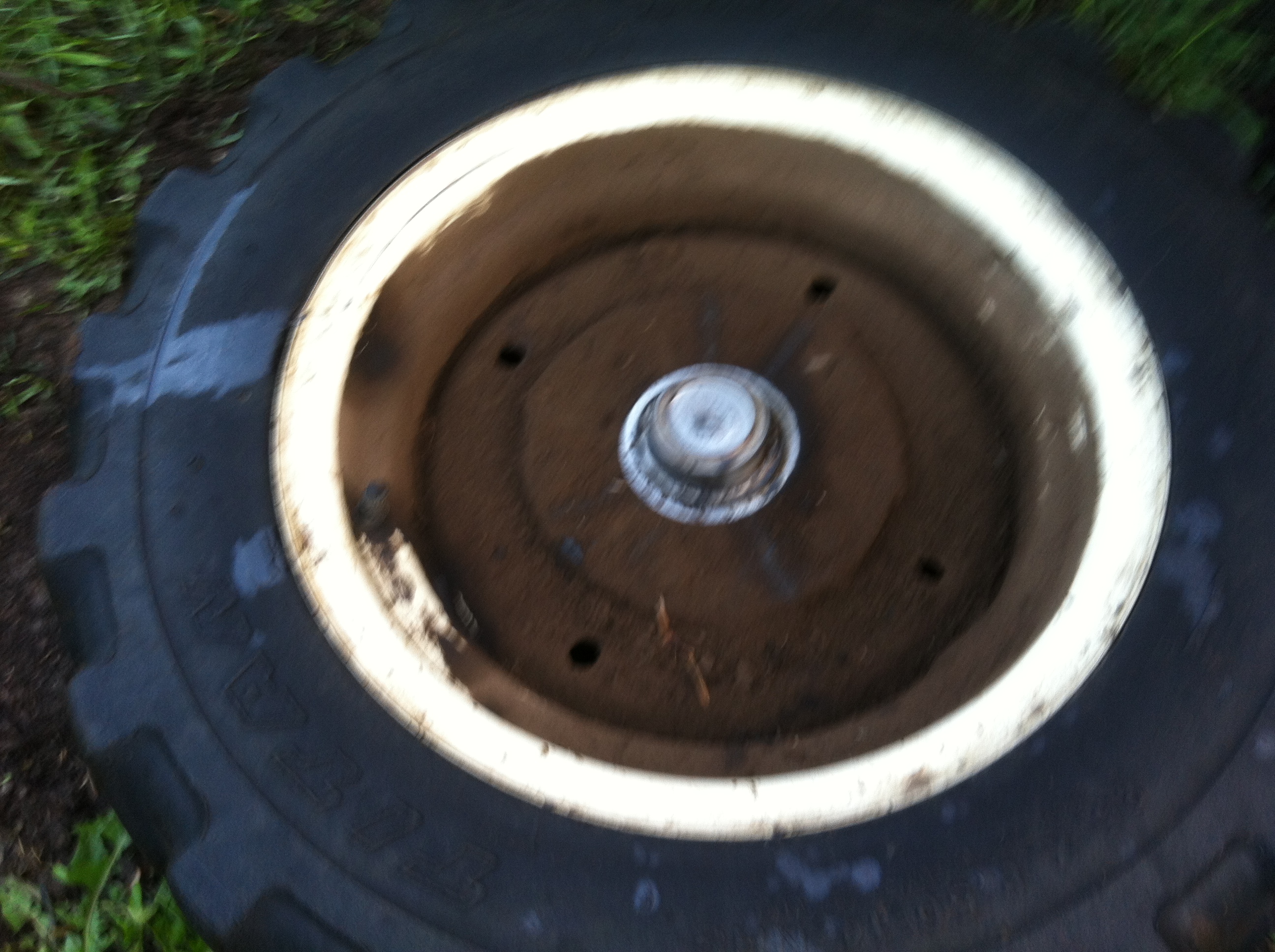

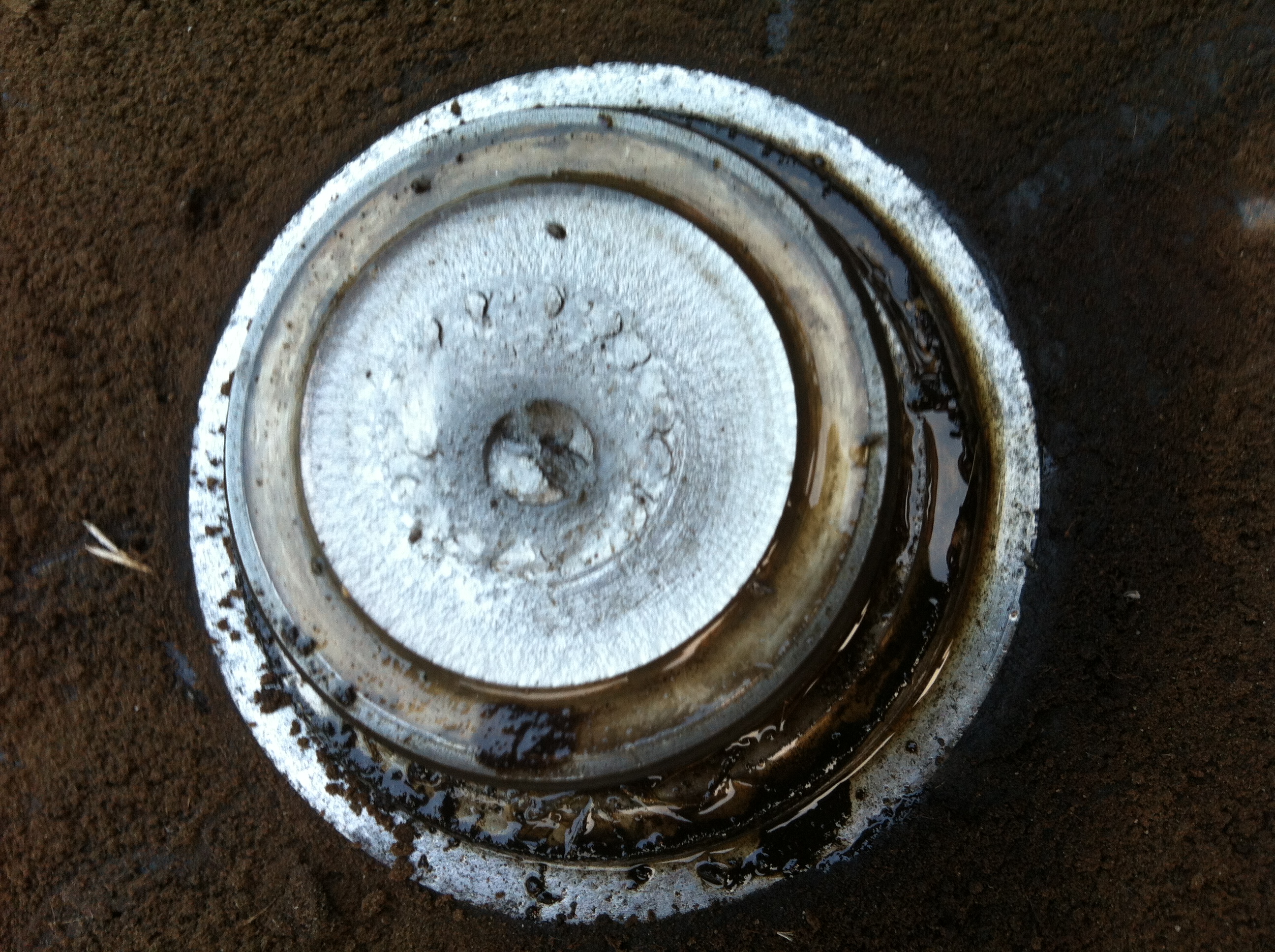

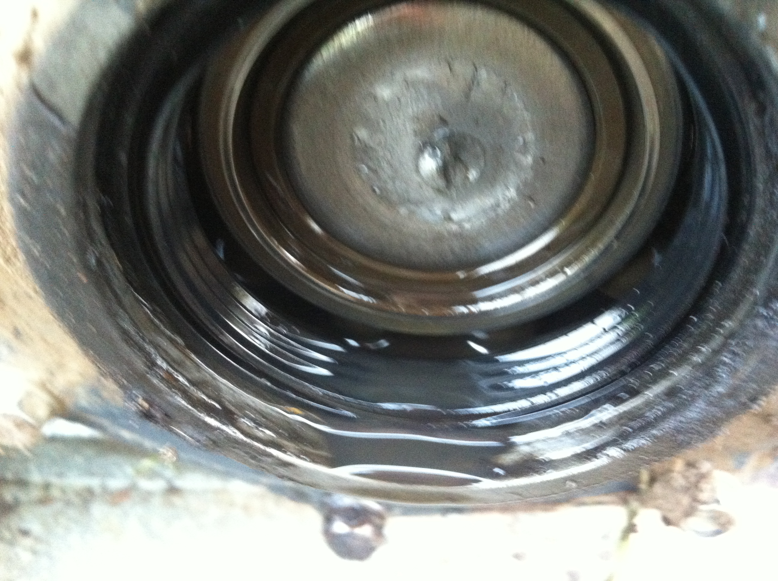

Hello
I am in need of help and advice from Branson operators.
Similar to BumpandNan on the "Branson Warranty Troubles" thread I have experienced a front axle break failure this past fall. The difference is that this is an out of warranty failure, my tractor is a 2009 3510H model. With it, the wheel assembly came clean off with no warning. Please see pictures attached. While I am not seeking warranty I am quite concerned that this type of failure represents a safety issue which should be the subject of a competent investigation and corrective action as found necessary. I would appreciate hearing from anybody who has experienced such a failure. Please share with me your experiences and concerns in this thread or by private email.
I believe this investigation should look into the manufacturing process of the axle, is it made of two pieces welded together? or, is it a single piece construction? I have concerns that this may have been a bad friction weld that has failed. So far Branson Tractor considers this failure closed because it is out of warranty.
I think that a failure investigation of this nature should be led by Kukje Machinery who are the designers and manufacturers of the product. They are the experts who would have the most knowledge and understanding of the axle manufacturing processes and the corresponding failure modes of the axle.
My tractor, as indeed are many tractors of this type, is often used on a public highway and on roadways, failure at such a time could lead to catastrophic results or on a side hill turn for that matter. In my case the wheel came off while turning over a compost pile. Hardly an excessive load. This leaves me with an uncertainty considering the LH front wheel axle which had not failed but which is of the same age in hours and calendar time as the axle that failed.
For those that are interested, I have attached some pictures of the tractor and wheel axle as failed. The wheel lies on the ground as it came to rest after departing the tractor.

Just for reference, i have broke a couple of axles over the years in a very similar manner. Once on a Ford 8N and again on a Ferguson TO35. They were 2wd and much easier to fix though. Replacements were readily available at tractor salvage yards. You won't be so lucky probably. Let us know how the repair goes.

Not trying to be critical,,, but,,, these tractors require some minimum ballast on the rear when using the loader.
Your pic does not show any ballast,, although, it may be hidden.
Do you use rear ballast?

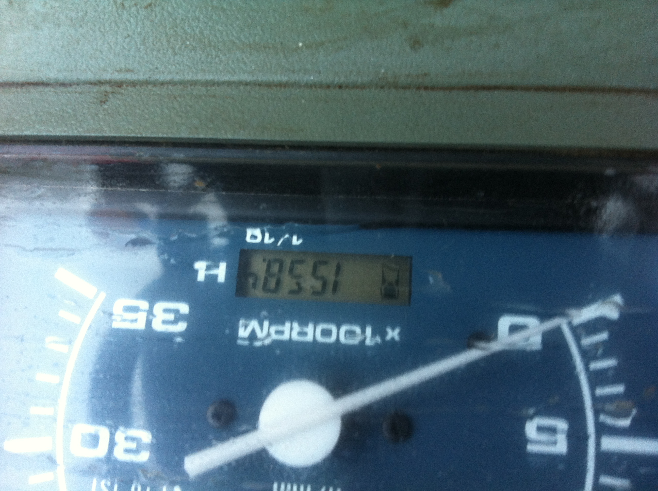

9 years old, 1558 hours, unknown history, not a regular occurrence
= Kukje won't investigate unless it becomes a COMMON problem, (which it isn't)

Cadplans, your observation is correct, I do not use balance weights or ballast as mentioned in the operators manual. For stability and control issues I have fluid in the wheels (supplied by the dealer), half full as the frost line showed me this morning.
Are you implying that weights are necessary to protect the axle from overload and failure? In reviewing the operators manual and the service manual for current versions of the tractor I can see no mention that the weights must be installed to protect the health of the axle. The only technical guidance or requirements that I see is that the operator is informed to increase the front wheel tire pressures by approx 50% when installing the loader. I do understand very well how aft applied weight will pull load from the front in operation but have never viewed it as a requirement to protect against functional failure of the axle. I would expect Kukje engineering to have designed into the axle strength the necessary contingency margins to address the operational loads developed using their loaders in typical farm operations. That axles are breaking remains a safety concern with me that has not been addressed by Kukje.
Again, thank you very much for you points they certainly causing me to more fully appreciate this issue.

We sell Branson, Mahindra and Deutz, and we work on all brands. There is not a single brand of compact tractor that does not deal with an occasional front axle failure. We have repaired broken front axles on what would be considered the very best most expensive brands. (Trying to not pick on any particular brand...but rest assured, it crosses all brands).
I can brake any compact front tractor axle if you give me a half hour or so. There are several methods. The common one we see is folks driving down a bank, like towards a creek, where they load the front bucket heavily and then aggressively try to back up the bank. Front tires have exceptional traction in this circumstance, rear tires have almost no traction, and a lot of tractive force is needed to get back up the hill. Now the front axle, which is designed to just assist traction, is trying to do much more than it's design spec. If you get a bit aggressive and the tires do not spin and the engine does not bog and the clutch does not slip...then you either are successful in the maneuver or you break a front axle, or side gear or ring and pinion.
There is another carnage method - if you use the front loader as a dozer or digger instead of as a loader, you can load the bucket up heavy and then lift the loader some (but remaining in the pile) and then drive forward and you are again putting huge loads on the front axle and nothing on the rear axle. The rear end is light, front traction is exceptional, all the work is being done by relative tiny front axles. This also happens pushing over trees or using the front bucket to lift a huge boulder out of a hole. Rest assured, there are many ways to break a tractor!
The front axle is tiny compared to the rear axle. It ought to just assist, not do all the work. It is my opinion that this is the cause of most front axle failures. Now if we go to a full size Cat tractor-loader, either a skip loader or a TLB, they use a pretty massive front axle, and you can get away with digging. Same with a skid-steer. But not a compact farm tractor that happens to have a loader installed.
Filling the rear tires to 75% with heavy liquid ballast and hanging a good size implement off the three-point will go a long ways toward saving a front axle, because it keeps the rear axle in the game as far as tractive force. That gives the front axle much less to do. And also, consider how you are using the tractor and if you are asking for more work from the tractor than for which it is designed - then do it seldom and do it gently.
I am sure there are other reasons front axles break, it isn't always due to what I described above. There can be faulty parts, or a leaky seal that drains away lubrication, or a failed bearing. These things happen, but far and away what I described above is the cause of the failure, and frankly an operator needs to understand the physics of it all well enough to be careful in certain situations. Repeat failures on a single tractor are generally more telling that the operator is repeating the same type of carnage inducing usage than is it telling us that the axle has issues. I am sure there are exceptions, I am speaking in general terms here.
Branson uses a good solid front axle, not any more prone to breakage than any of the better known brands. But it is not a $100k commercial skip loader with massive planetary front axles.
