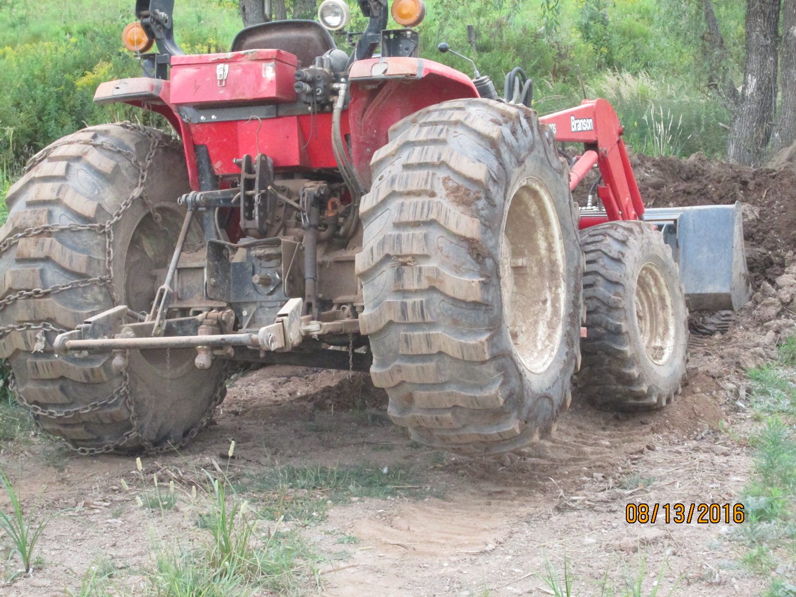

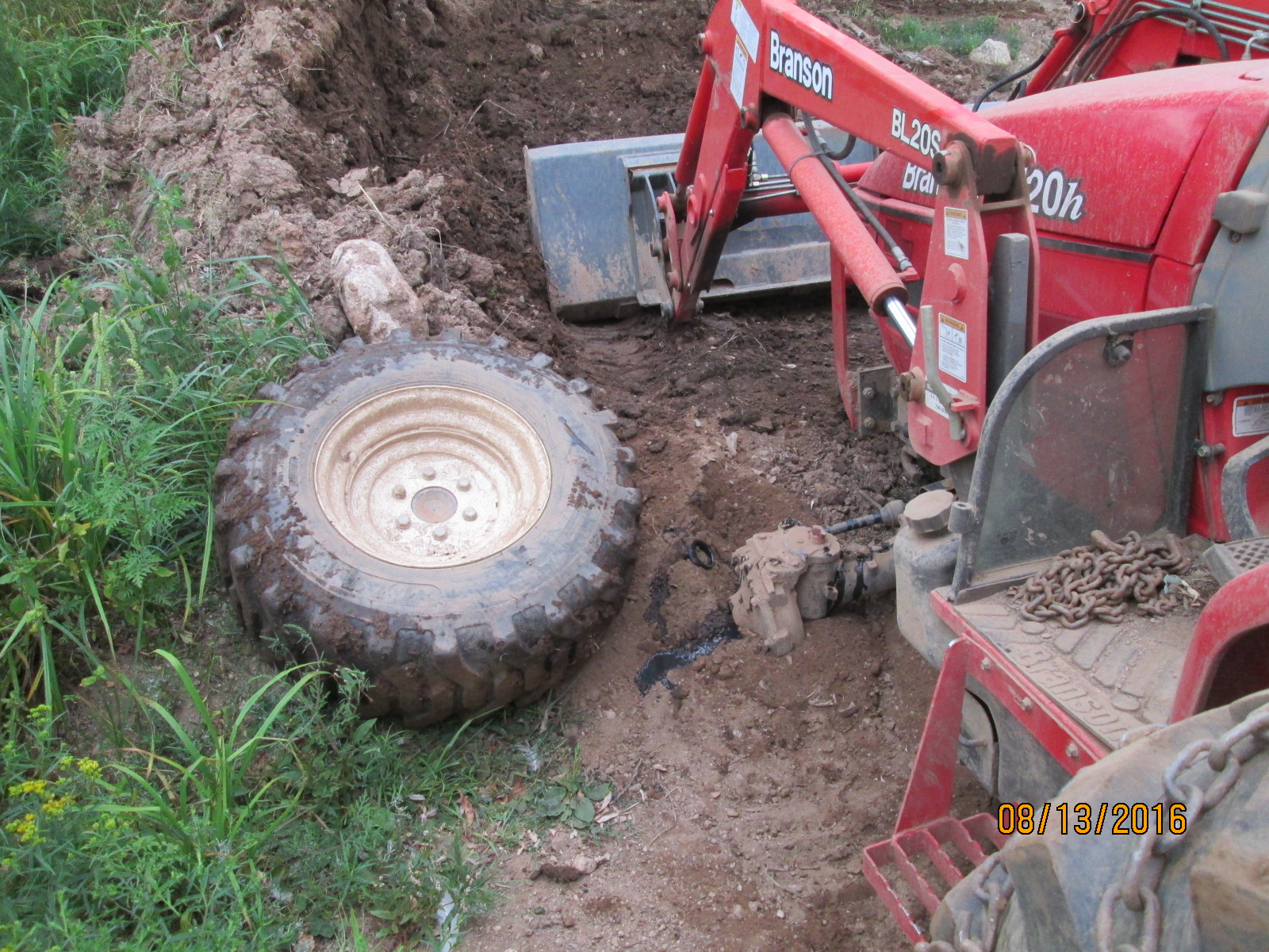

After a close look at the pics, the axle did not break. It was twisted off.
There are circular marks on the parts.

From what I have seen, most loaders lift the front end somewhat while digging down into the dirt. This movement actually takes pressure off the front axle. For level surface loaders working on concrete and asphalt, there is no need to dig below the surface, just scoop from the finished surface so there is a chance for more pressure and traction on the front end in this case. Barring abuse, the tire should be expendable, not the axle.

If used as a normal loader, I agree that you should get tire spin before axle breakage. But you can force the tractor in some situations to have tremendous traction for the front tires, at the same time having almost no traction to the rear tires (as they are in the air or nearly so). If you then proceed to push and the tires can't spin and the item you are pushing does not move and the clutch does not slip and the motor does not stall....then what? Snap. It is under difficult circumstances that these operator induced breakages occur. MFWA is to be used for traction, but not as the sole motivating force when the front axle is under extreme load. Using it to push into a pile for loading is proper. Just considering the physics of what all is happening can keep a guy out of trouble.
And I agree with you on the rear axles being more robust. A rear axle shaft on a (any brand) compact 4x4 tractor are several times larger than the front axle shafts. Some front axles shafts are only an inch or so, and on that same tractor the rear axle might be 2". Cross sectional area of a 1" shaft is 0.785 sq in. A 2" shaft is 3.14 sq in. 4 times stronger, given that everything else is equal.

I twisted my drive shaft "off" once. I was loading wet sand in a sand pit and the road (sand path) out of the hole was at least 30 degrees. 1979 International cab over combination, 35 ft end dump, 25 tons of slush, 800 cu. in. 400 hp Big Cam Cummins.......it can be done with an abusive operator.
   / Branson Front Wheel Axle Failures #74
I twisted my drive shaft "off" once. I was loading wet sand in a sand pit and the road (sand path) out of the hole was at least 30 degrees. 25 tons of slush, .......it can be done with an abusive operator.
Lots of traction + Lots of torque = something's gotta "give"

Yesterday I had a second stub axle twist off 8 years from new . Been working with the log winch now for a couple weeks and just dropped off a stick of fire wood maybe a 200 lbs . backed up a few feet and it let go. Drove 4 hrs round trip to get the part and repaired to find out the seal is shot this time too. Last time 1.5 yeras ago was the left front and this time its the right front.
I did buy 2 as it will be needed.

Yesterday I hauled apart the left side again to check if the crack has started . It has not after 1 . 5 years use. My new maintenance plan is with every front axle oil change both side are coming apart to see if the crack has started. Not going to take all that long with tire removal , 9 bolts out then 2 more inside and the stub axle pulls out for inspection.
The parts place tells me it has something to do with how far the wheels can turn left and right This tractor when turned all the way the wheels are almost 90 deg to the back . They say there needs to be a limit bar install inside the power steering assist tube to set the distance for turning.
