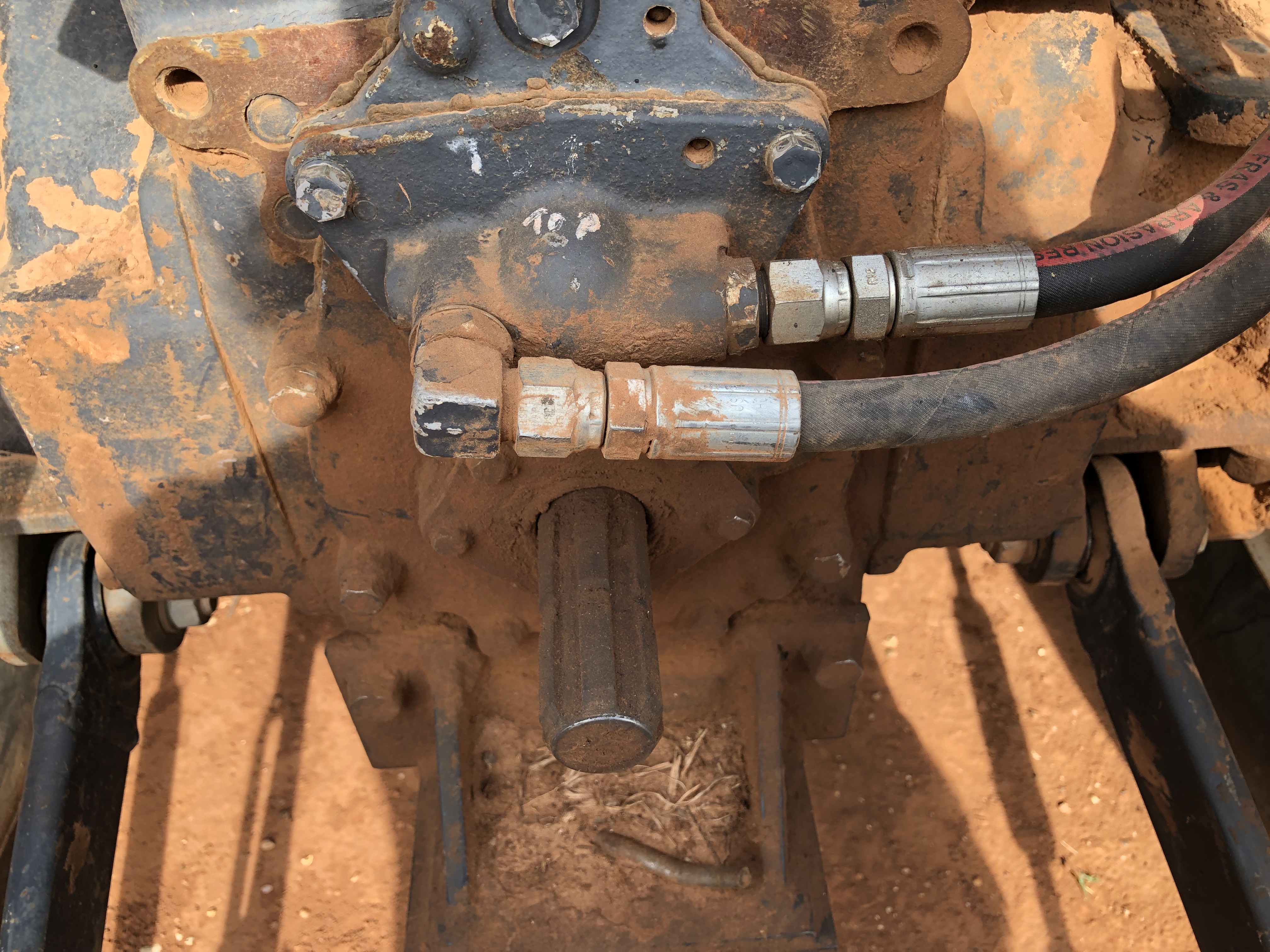

There are 2 hydraulic hoses going from back (they are side by side) they lead to a pump , it is shown in video. I would like to know their function. I have service manual for chassis and service manual for engine,neither show these hoses. On top above theses 2 hoses by the 3 point left arms there is another hydraulic hose going to FEL ,it is connected to FEL beside 4 hyd. hoses going to bucket and leads to return under seat of tractor (low side), from hyd. pump a hyd. hose leads to left side of FEL (High side). I have NO HYD. working on the 2910i Branson. Can some one tell me what the hoses in back leading to pump are used to operate what? Thank You

There's seven hoses connected to the FEL valve. Four are for the loader. One is the feed from the pump on the engine. One goes to the tank (transmission). On my 3725 that's under the seat somewhere. The last is the power beyond. It goes to the back of the transmission case to operate the 3pt hitch. Tank is low pressure, PB is high pressure.
If you want to ask about specific lines on your tractor, post pictures of them.
For your no hydraulic problem, check that there's not a valve that's stuck open (you'll hear a relief valve squealing if there is). Check the fluid level. And then check or replace the filter and intake screen.

Thank you , Yes it has 7 hoses , 4 for loader, one on left side to power beyond(hyd. pump) 2 on right side, one almost beside the 4 for the loader is going to back of tractor located above the two separate hoses that are going to a pump under right side of tractor (other side of hyd. power beyond and power steering pump),and one is on side going to port under seat from power beyond low side. hyd hose coming out back 2910i branson tractor.JPGIMG_0396.JPGTried post pictures. maybe will work this time. Thank You.

Those two hoses right above the PTO are going to what looks like a hyd. pump, can you tell me why or what they power? Thanks

Those two hoses on the back are used on the PTO clutch. One is high pressure, the other is return. It should however have 2 hard lines going to the PTO hydraulic block and not two hoses connecting to who knows what.

On my 3725 the two hoses just above the PTO shaft are hard lines like @ptsg noted. They come from the PTO valve on the right side of the transmission housing in front of the rear axle. The PTO valve is fed from the power steering circuit which is separate from the regular hydraulic circuit that runs the loader and 3pt. The line from the loader valve's PB port runs back to the rear and into a block just above the PTO clutch block in your picture.
Of course none of this helps to figure out why yours stopped working. Did everything stop working? Loader and 3pt? power steering too?

My brother came over, we changed hyd. oil and filter, it was bad , oil in filter milky, and no oil in tractor hydraulics. Brother cracked open high pressure side of pump, nothing came out, we increased rpms, still nothing, hyd. pump was pretty warm, and he opened several high pressure lines, nothing worked. brother seems to think it will need new pump. I replaced the 2 PTO lines half way with hyd. hose, because i sheared outter PTO shaft inside tractor, i was using nortrac roto tiller and it didn't have shear bolts, I tried to get hard lines built but hydraulic shop said they couldn't make them that small in diameter, so they made hyd.hose for me and i used adapters to connect to hard lines . I took roto tiller gearbox to machine had them smooth splines and drill hole so now it uses shear bolts. I bought this little tractor that had sat for about 3years in a field. Brother is diesel mechanic ,he put fuel pump, battery, bled fuel lines and it started. more in next post, Thank you

Ok, reading your description before, I thought those lines were going to the loader which would be a big problem. Since you just replace it with hoses and are still connected between the PTO block and the back of the tractor, it's all good.
