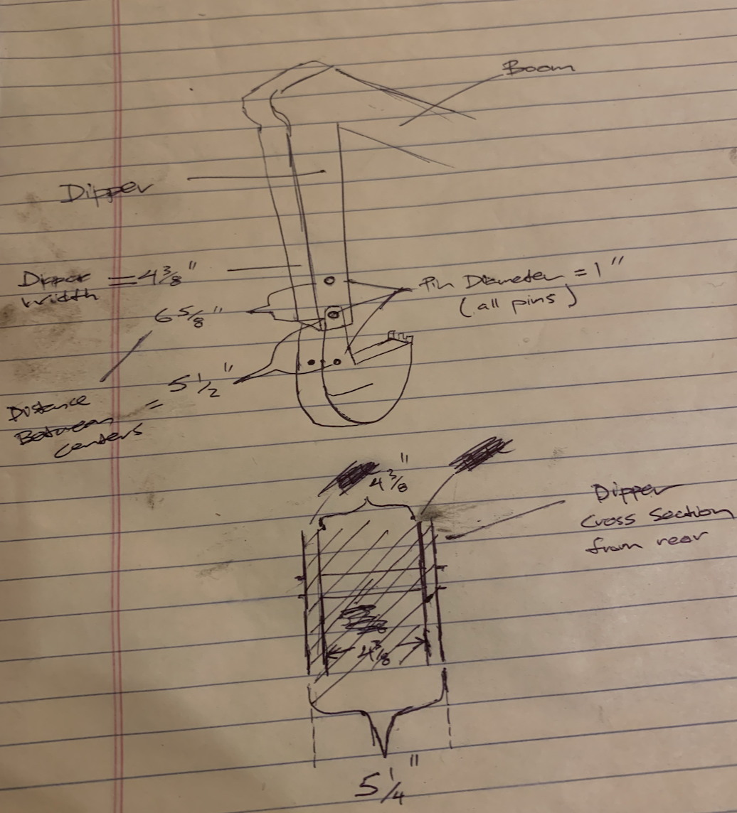

Dec 24, 2020 / Branson & Kubota BH76 backhoe ripper #14 Branson Bob Platinum Member Joined Nov 5, 2016 Messages 616 Location Sierra Foothills, CA Tractor 2016 Branson 3520H Here is a primitive dimensional drawings showing my Branson/Ansung BH76 bucket. Aquamoose, were you ever able to confirm that the BH76 on the Kubota is the same as the one on the Branson? I want to buy a 6" trenching bucket and want to make sure I'm buying one that fits. Thanks! p.s. - If the drawing isn't clear the distance between pins (centers) is 5.5", the pin diameter is 1", and the dipper width is 4.375"

Dec 24, 2020 / Branson & Kubota BH76 backhoe ripper Thread Starter #15 OP Aquamoose Platinum Member Joined Sep 16, 2011 Messages 940 Location Deer Park, WA Tractor Branson 3520h Never did hear if they would be compatible. I fabricated my own ripper.
Dec 24, 2020 / Branson & Kubota BH76 backhoe ripper #16 Branson Bob Platinum Member Joined Nov 5, 2016 Messages 616 Location Sierra Foothills, CA Tractor 2016 Branson 3520H Aquamoose said: Never did hear if they would be compatible. I fabricated my own ripper. Click to expand... Thanks for the quick reply Aquamoose. I'm gonna call Messick's and BXpanded to see if they have any information. I'll let everyone know what I find out.

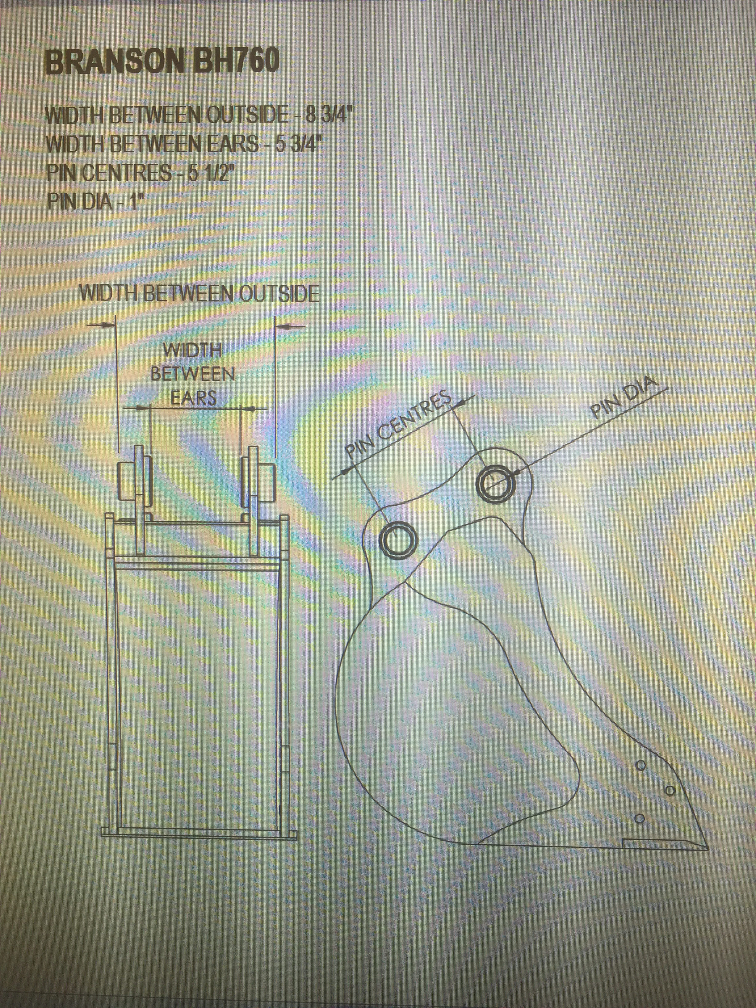

Dec 26, 2020 / Branson & Kubota BH76 backhoe ripper Thread Starter #18 OP Aquamoose Platinum Member Joined Sep 16, 2011 Messages 940 Location Deer Park, WA Tractor Branson 3520h Figured you can use this drawing with measurements when you communicate with BXpanded. Let me know how it goes!

Dec 27, 2020 / Branson & Kubota BH76 backhoe ripper #19 Branson Bob Platinum Member Joined Nov 5, 2016 Messages 616 Location Sierra Foothills, CA Tractor 2016 Branson 3520H Thanks Aquamoose. I have that same drawing! BTW earlier in this thread it seemed like someone was saying that the dimensions were on BXpanded's website but I couldn't find it. Anyways yes, I'll report back after I speak with them. :thumbsup:
