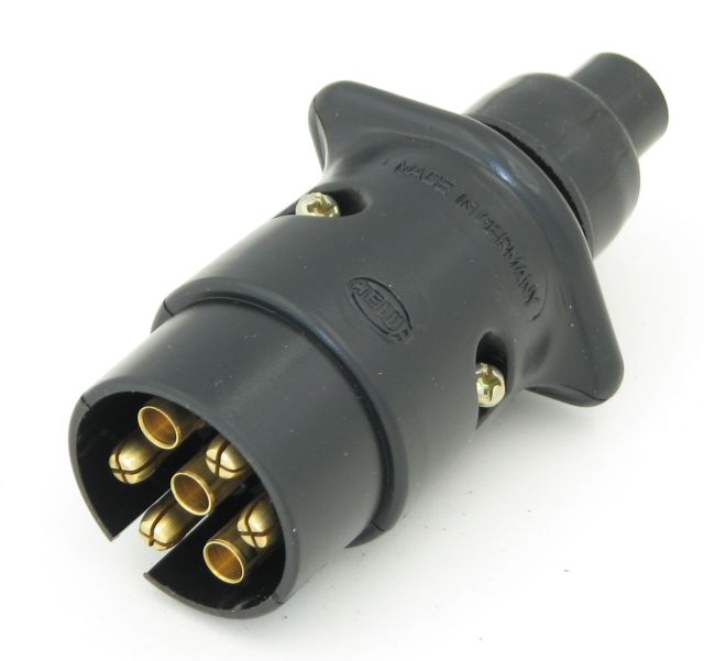

/ Branson Power Plug #9
That plug in your picture would not fit the one I cut off my 3510i. The one that was on mine was rectangle...looked like something under the dash of your car or truck to plug a diagnostic thningy into. I was told it was a foreign version of an RV plug they use overseas. Sure nuff the wiring matched up with the blinkers,taillights,etc. My dealer said that in Korea they use tractors like we do cars & truck...the family vehicle. After converting mine to American style recpt. I plug my sprayer and several things into it that require power on the tail end.
