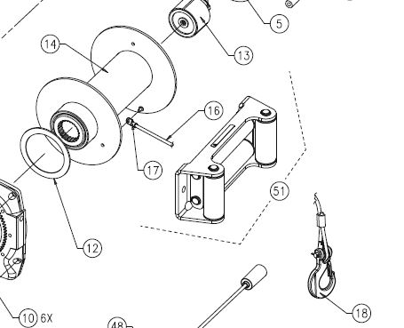

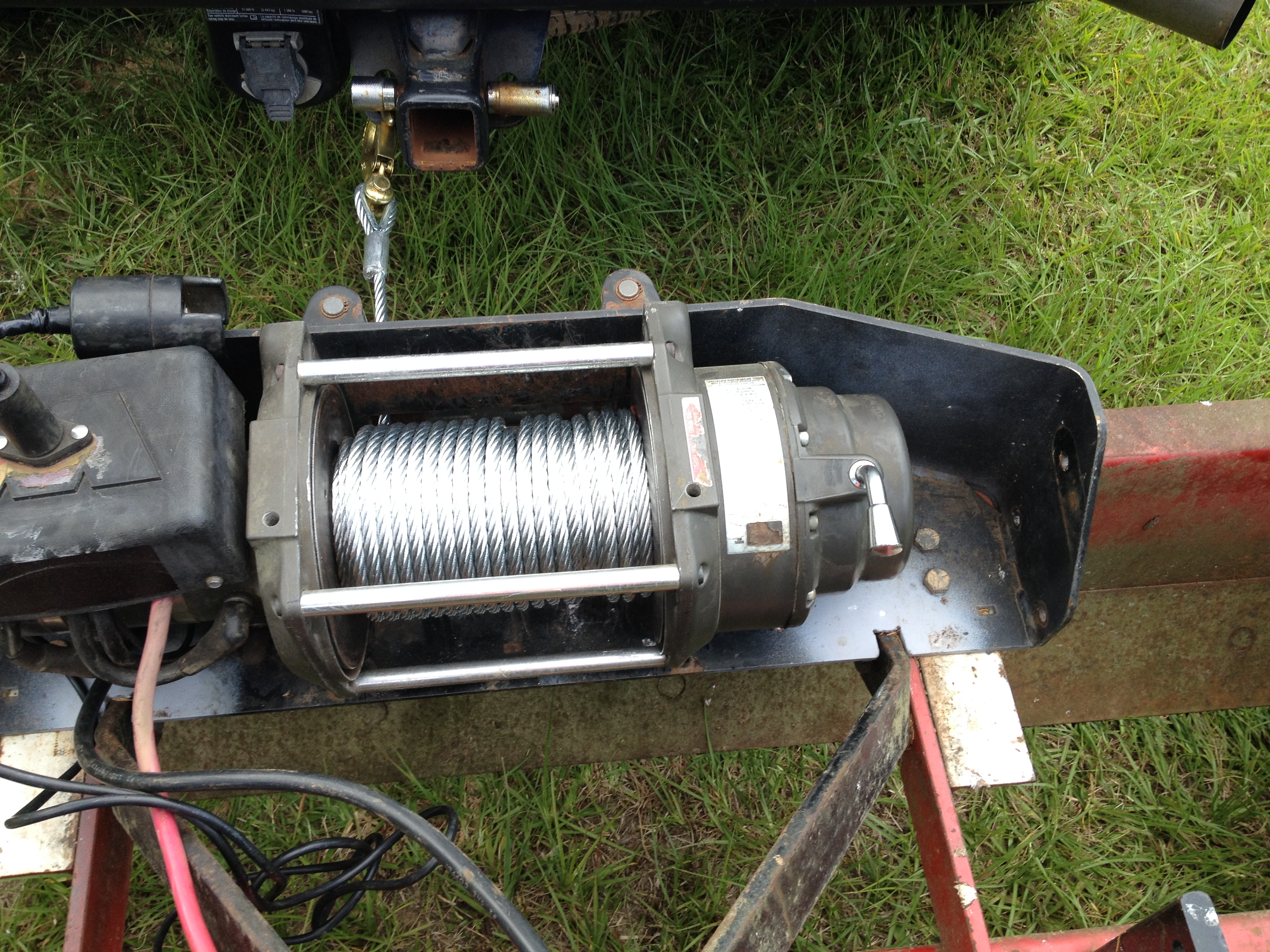

Used to attach the cable to the spool to start first wrap, the tension of the cable over the first wrap keeps the cable on the spool during a pull not the lug. Even so, I believe it will take a good connection to get that first wrap tight on the spool, it is 1/2" wire rope we are talking about.
I get that. But I doubt that that lug is the correct one. In fact, I doubt that the end connection is even simply bolted. My money is that there is a socket and a couple of set screws. Have a pic of the drum?
The cable pictured is stock WARN engineering, I believe they have been in business long enough to have developed a suitable solution. The cable I have is aftermarket and did not come with eyelet, I was hoping for some advise on an alternate solution to crimping an eye on the cable.
