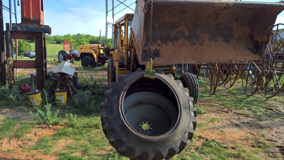

And then there is option C, there is always an option C isn't there? But option C can have several sub options within like option c1 leaving the assembly on the tractor and breaking down the tire and changing it that way. The tire service guys often will do this because it saves having to handle the heavy rim and tire as an assembly but they will have special powered break down tools to assist them.

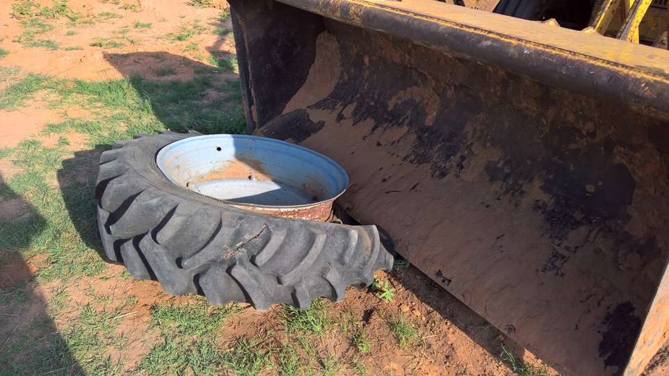

so this brings you to option c2 which is part of option B except you are not going to have to load it and haul it. you merely use your tire hammer to break down the bead then spoon the tire off and the new one back on the rim. Having swung my share of tire hammers over the years I find them laboriously boring tools to use. SO I created what I call option c2a where I toss the assembly on the ground and use the loader bucket of my backhoe to break the bead in just a few seconds it is time to flip the tire over and break the other side. then spoon off the one side and hang the tire from the bucket to spoon off the other side This saves me a lot of time and aggravation of having to swing a tire hammer which I hate with a purple passion anyway.

I use several methods. Last week when I swapped out tires, I used my backhoe, using the bucket to push down on the tire. But I have also used my outrigger to break down the bead on a tire. Incidentally I use the outrigger to hold the new tire, as I take the backhoe and push the new tire back onto the rim. I can only push about 3/4 of the tire on, but that only leaves me a stretch or two with tire irons to finish the job.
I have also used my log loader with great results, I just pinch the tire with log loader to break down the bead. I can either do the with the tire flat on the ground, or held vertically. Like the backhoe, I can also put most of the new tire on the rim the same way.

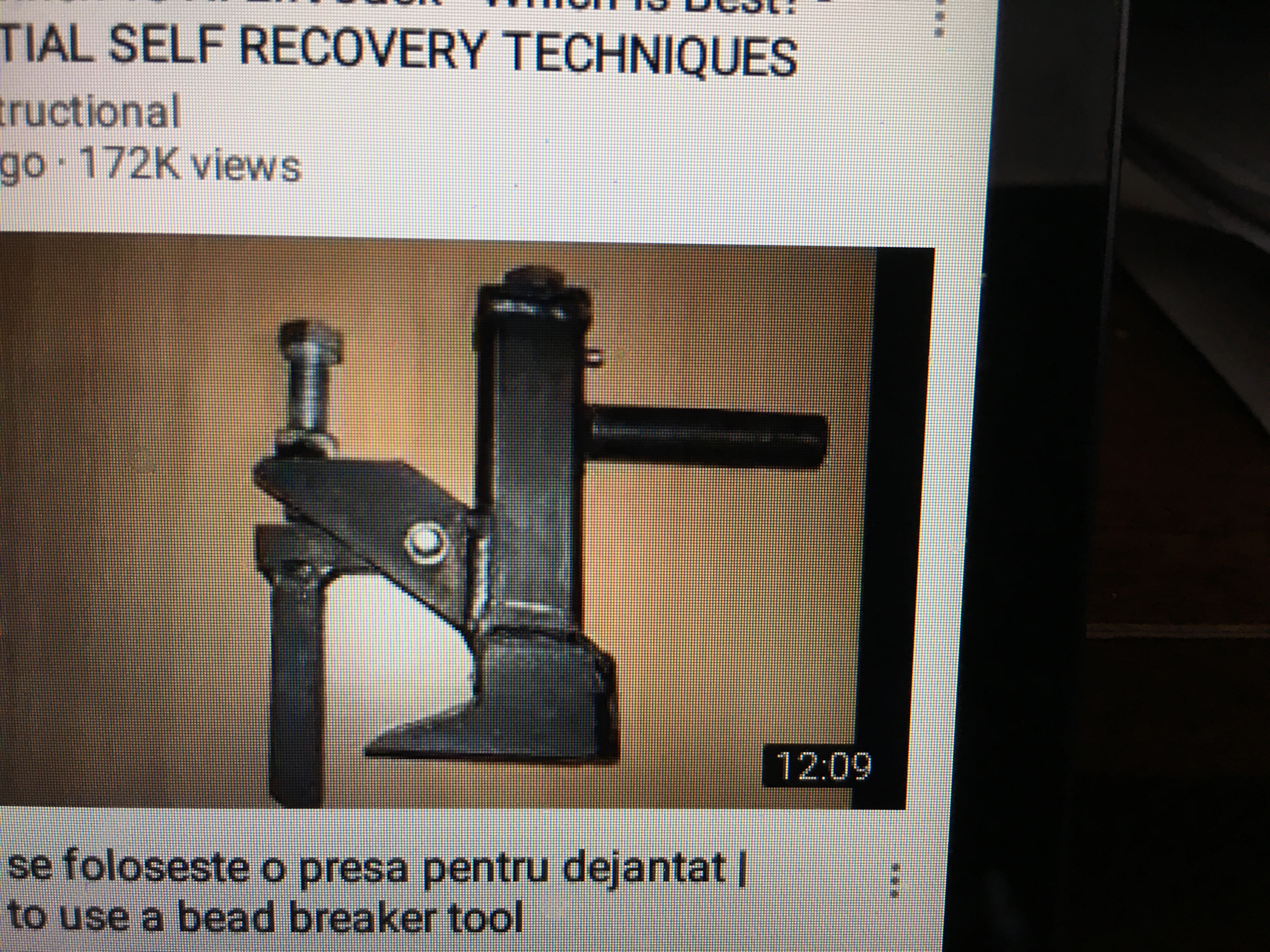

I got a screw type bead breaker several years ago and it is a very nice way to break beads especially for a larger tire that you wish to leave on a tractor or such.
It is similar to this one; BeadBuster XB-45 Motorcycle Bead Breaker
This one seems to be the same as I have; https://www.northerntool.com/shop/tools/product_200322827_200322827
They do make breaking beads much easier.

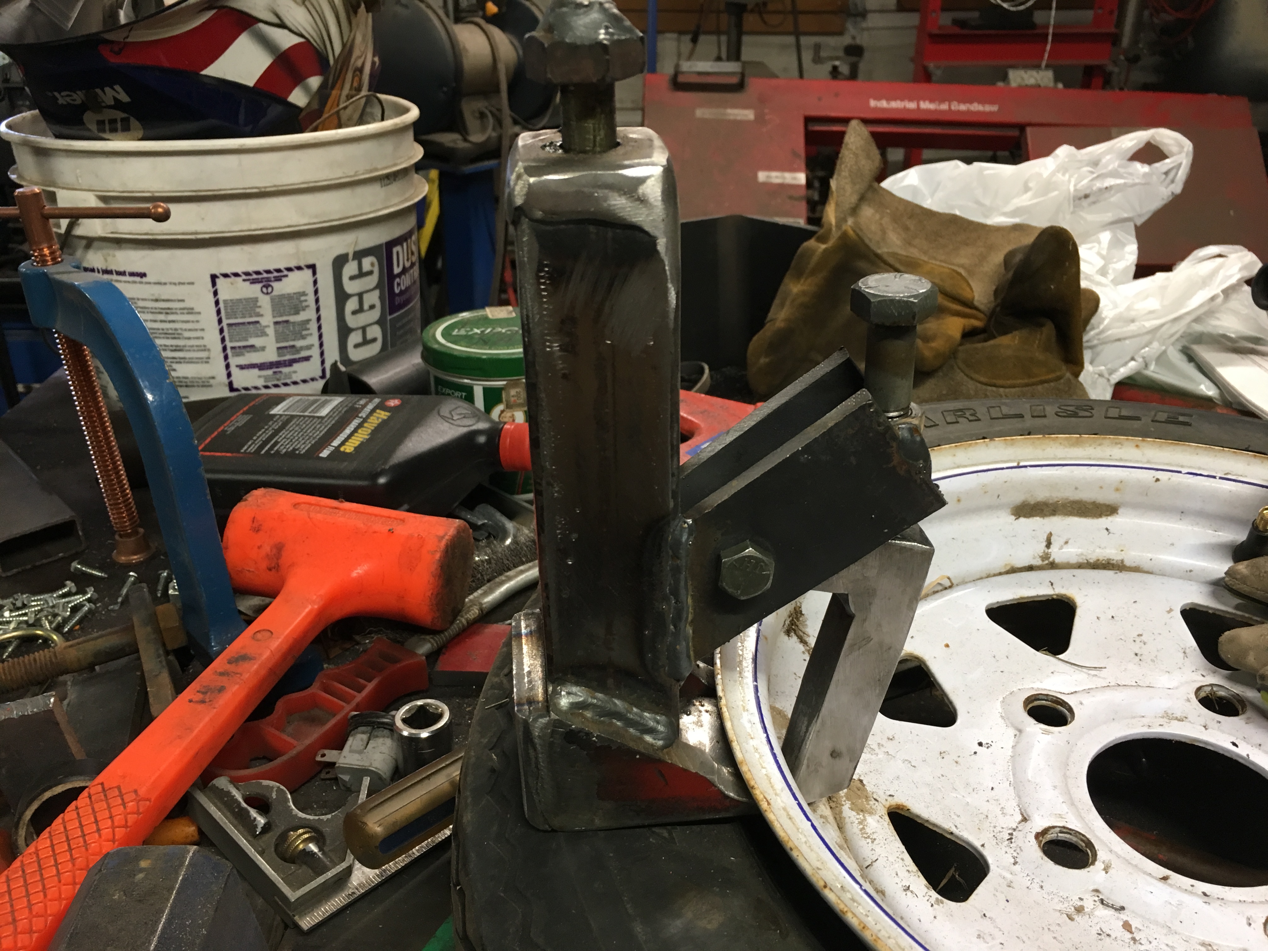

Fabbed up one of those screw type bead breakers last fall. Used it on a trailer tire, worked good. Need to try it on an atv tire as they羆*e tough D9318F77-687F-4410-B27A-3945C7DAC35D.jpegA367E80C-0423-41F5-BCFD-58D273491CED.jpeg

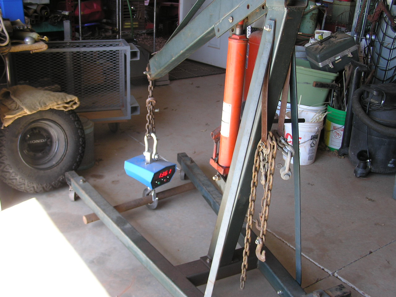

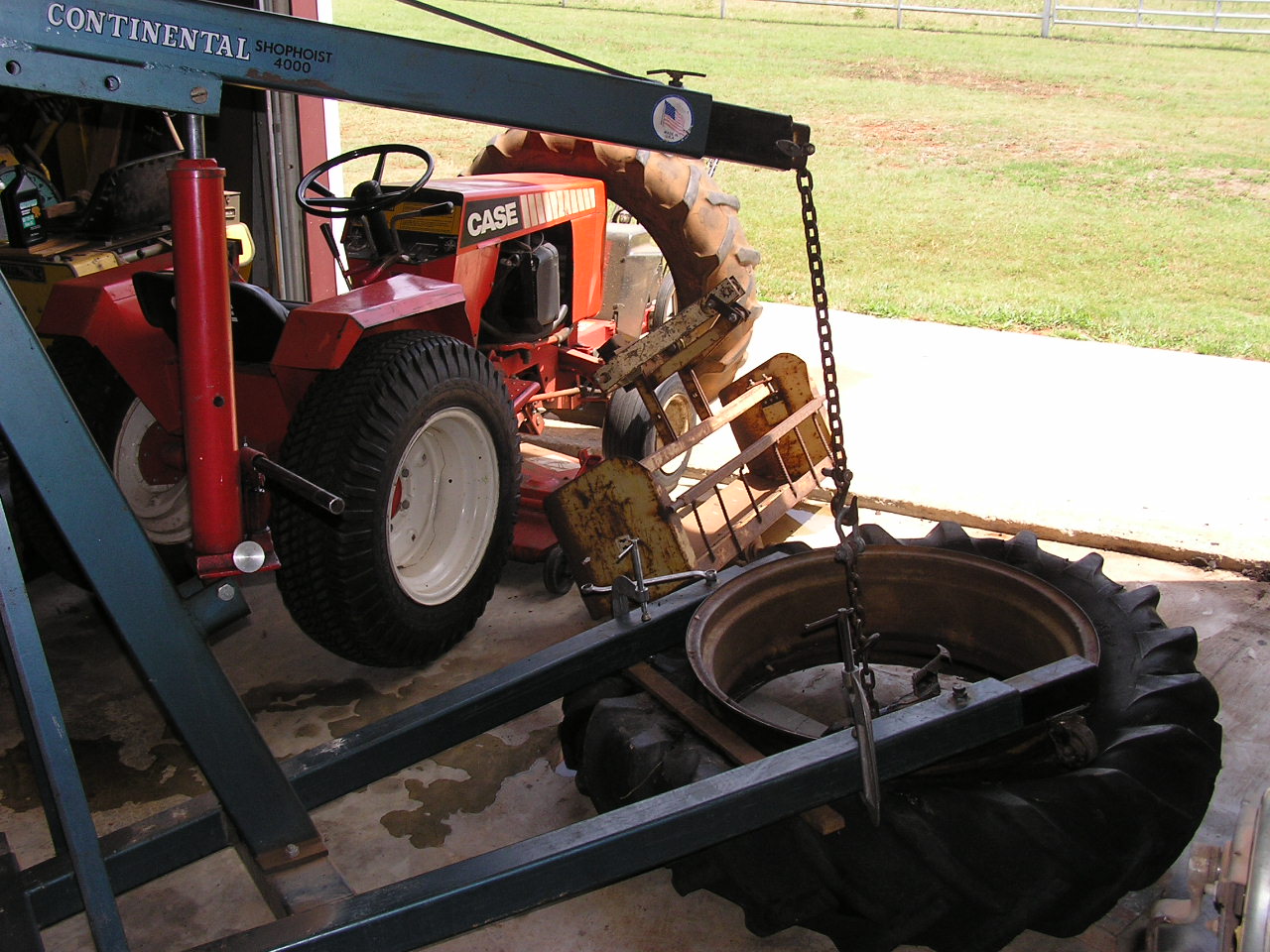

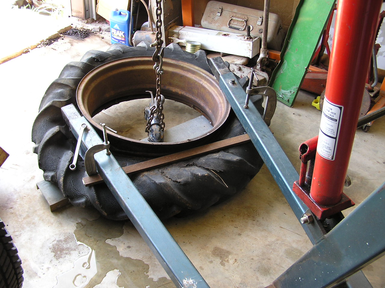

I have used my shop crane:
/ Breaking down tractor tires #10
I had to take paper and pencil to draw that out, before I could envision what you are doing.

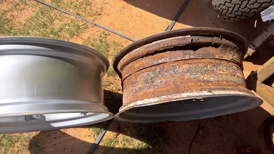

The old 8n rim was so far gone I decided to replace it rather than try and retain the original. Since my tractor is not something owned for the purpose of being used in shows and I need function over form. I ordered a pair of new more or less universal rims to mount on the center disks.
