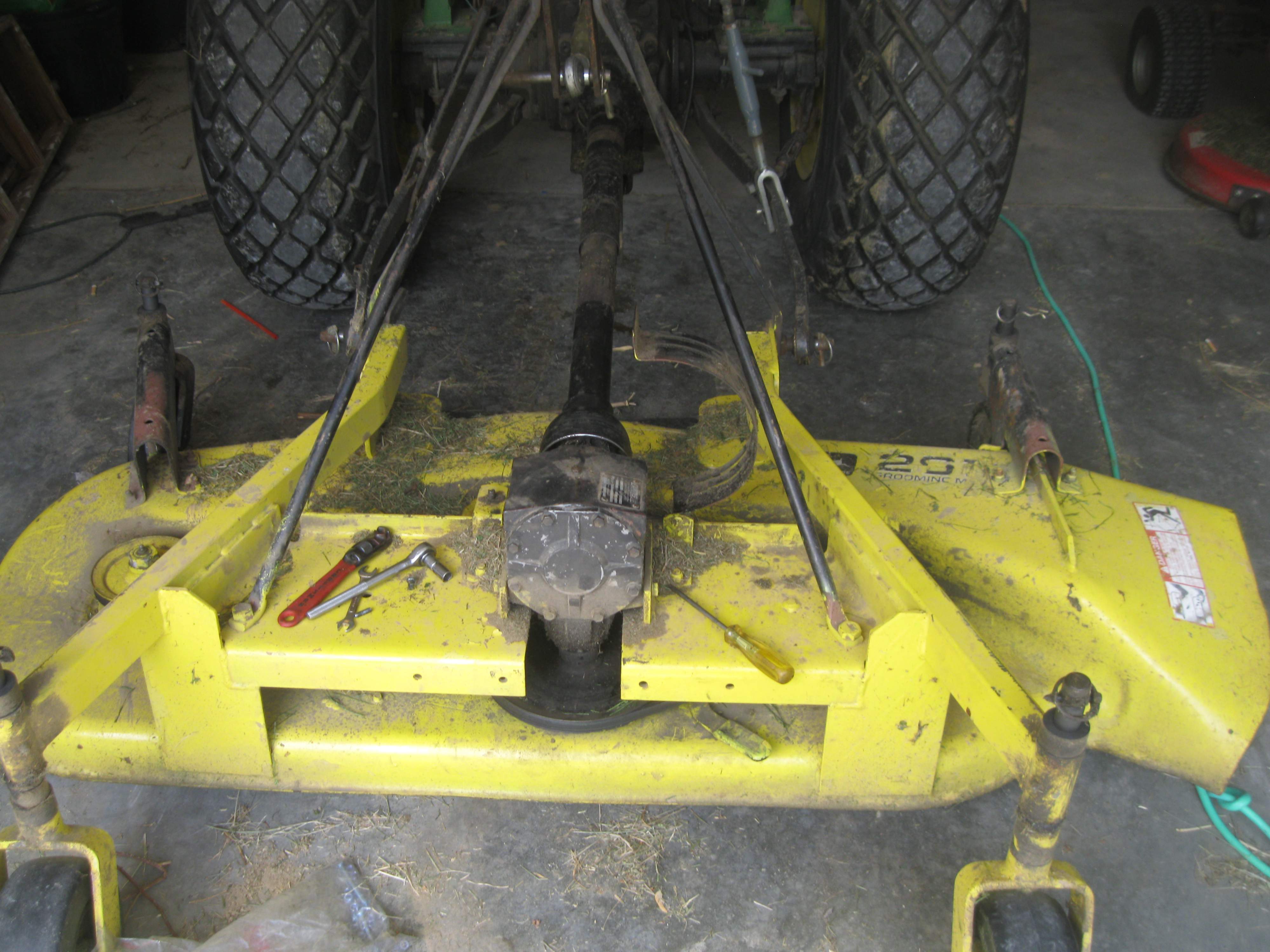

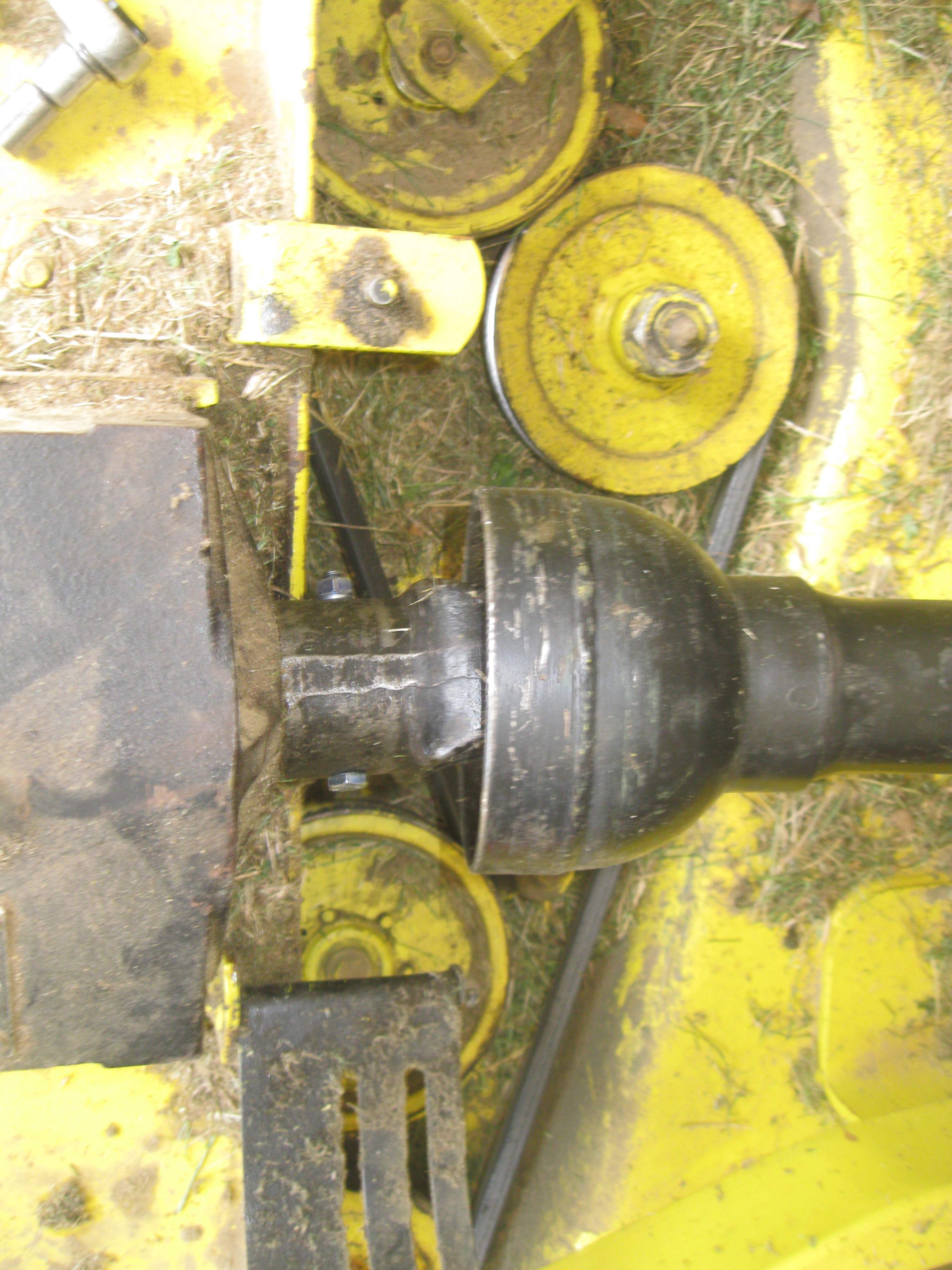

The mower is a JD 261 Grooming Mower, not a finish mower like I stated earlier, my bad. The shear pin breaks occur when I'm mowing and engage the clutch at normal cutting speed and release it without throttling down first and slowly re-engaging the clutch. It most often happens when I try to maintain my position on a hill by using the clutch rather than the brakes or when cutting in tight areas when I use the clutch rather than the throttle to slow down when turning. This is the first time I've used a tractor with a manual clutch and standard transmission so it may be user error, it may be that I'm releasing the clutch too fast and also that I shouldn't use the clutch for either of these circumstances. The mower belt and blades move freely and the belt does not appear to be too tight. I use the 540 rpm pto setting for mowing. The shear pin bolt is small, it's 1/4''x 2.5''. Thanks for all the great suggestion, it's not a huge deal and it is happening less often as I get more familiar with using it.

My YM240 came with a John Deere 260 5ft. Finish Mower that does a great job but every time I press on the clutch while the mower is running I have to throttle down and restart, slowly letting out the clutch or it snaps the shear pin (a nut, lock washer n bolt) and I have to shut it down and put another one in. It's getting better as I get used to using the tractor, last cut I only went through 3 and I'm getting pretty fast at installing them, but it's still a pain, any suggestions? I saw this over running clutch that Hoye offers could that help? Yanmar over running clutches
Is there any possibility there is a bind in the mowers right angle drive or the driveshaft u-joints are out of phase? I can see shearing bolts getting to quick on the clutch or trying to start the mower stuffed into tall grass but stalling the engine would be more what I would expect in that instance. I also wonder if the built in overrun clutch is working properly?
I am surprised they call for such a hard bolt as a sheer bolt? I have gone from grade 2 (no mark) to grade 5 (3 marks) on my mower and my post hole digger but that still doesn't make me feel like I did the "right" thing even though it has worked but a hard bolt I would never do it. my .002

The comment I made about the drive shaft out of phase is worth a look I hope he takes me serious on it. I agree it may be a shot in the dark but on rwd cars and trucks it happens on a regular basis not kidding a bit.
Some shafts are indexed where you cant put them together wrong but a 90 degree out of phase square shaft w/o an index will tear things up in a hurry due to the force that's being applied to the flange every time the u-joint is forced to "give" it will push back against the sheer bolt.
And it would have a significant vibration also. I have seen shafts repaired and re-welded flanges put on out of phase on indexed shafts so anything is possible fwtw.
I am like you guys I know other guys that put hard bolts in and if it says to do so then by all means it would be prudent and called for. Its my logical common sense side that tells me to be careful haha. :thumbsup:
(kind of defeats the sheer bolt purpose if the bolt is harder than the shaft or flange but I am not a certified enginer jmho) edit: I see now where the sheer bolt is 1/4" that is awful small imho and may be the design fault Clemson mentions? fwtw I think my 45hp gear boxes all had 3/8" #2 soft bolts as spec pretty sure that is it?

Thanks kenmac, The JD dealer says it calls for grade 9 bolt. I agree, I'd rather bust a shear pin than my tractor! I found plenty of choices in slip clutches, there are ones that fit on the pto at the tractor, some that are built into the drive shaft and ones that go right on the shear pin shaft at the mower gearbox, that one is about $70 (usd) plus shipping. I figure I'm just going to keep it as it is for now, this mower does a fantastic job other than that, it's a grooming mower maybe it's geared higher for more rpm's, who knows, but the only time it ever breaks the shear pin is when I'm doing something wrong with the clutch so it's a cheap but valuable way for my newbie self to learn to use it the right way. Thanks to everyone for the helpful posts, I will never use my clutch like I'm driving a car again! ;)
