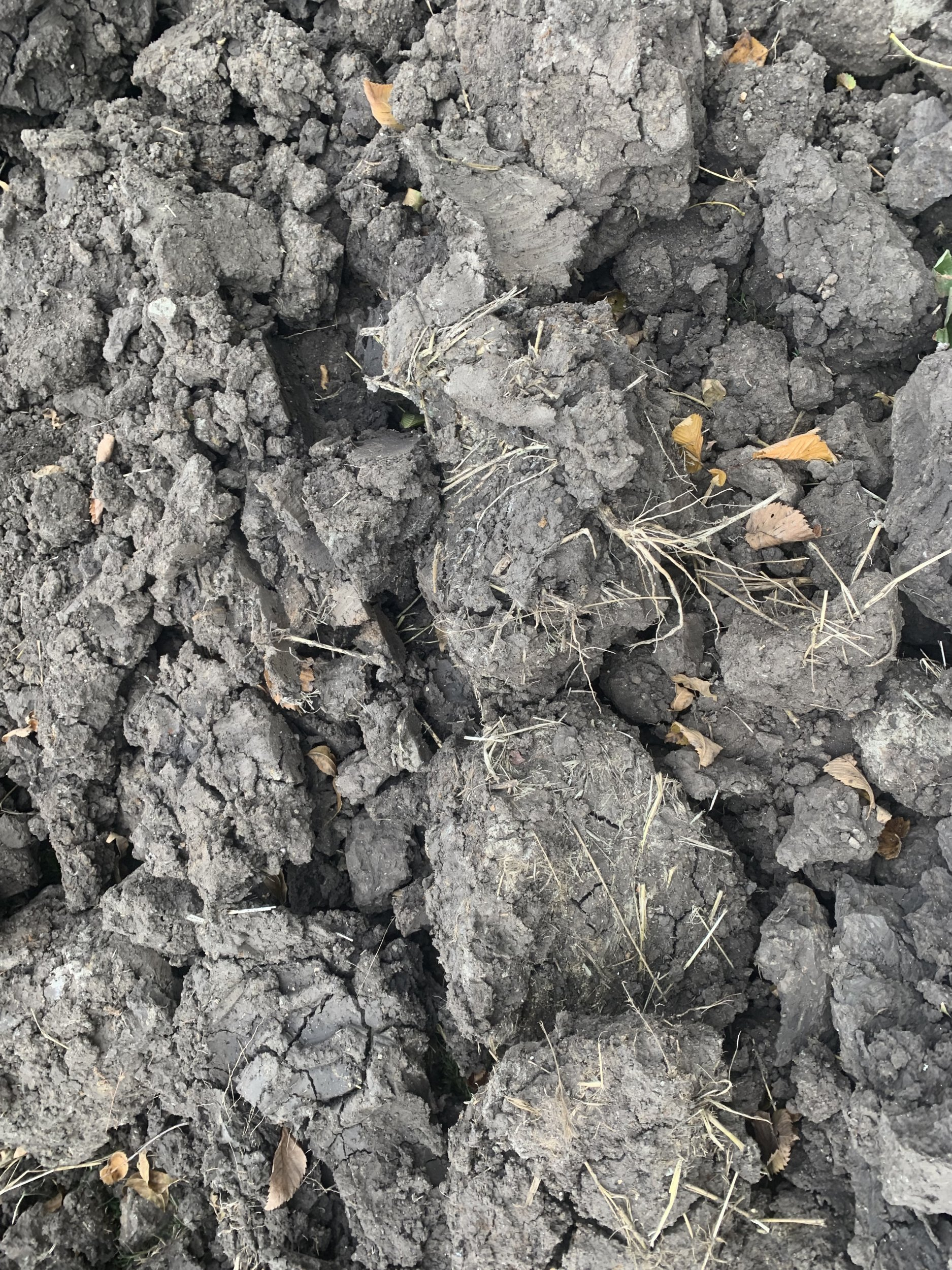

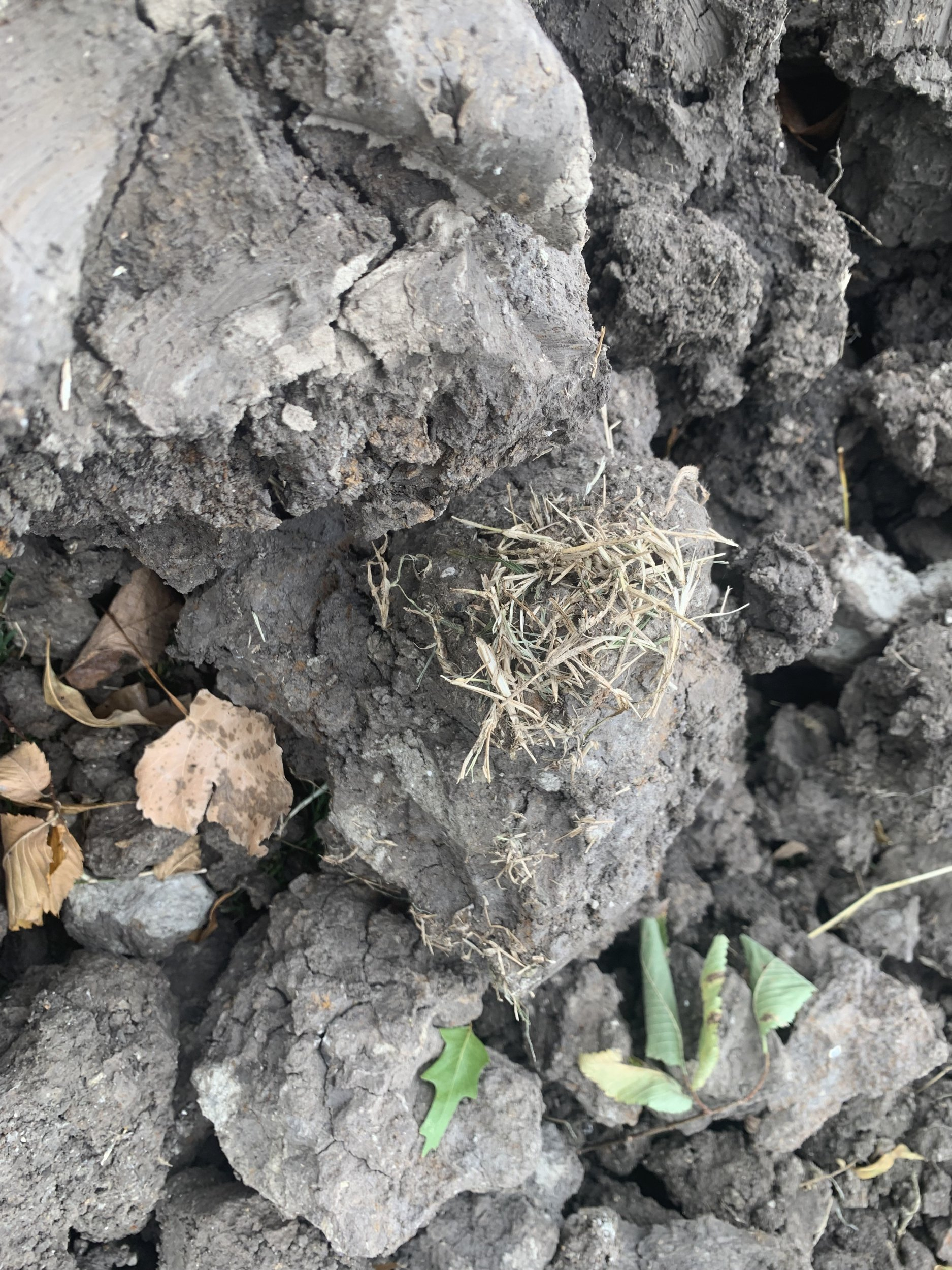

In my area, good black dirt has been hard to come by, the last few years. I was able to get a few loads, free. It is not ideal, but will work. However, it was pushed up with a large dozer and the chunks are quite large. Some are so heavily compacted my Kubota BX (with MMM and backhoe attached) bucket edge can’t cut into them. I just lift my tractor up, on top.
I have a rear mount reverse spin tiller, but I’m concerned about the logistics of safety keeping the machine on top of the large clods. I think I’m going to try it, but thought I would see what other plans I should make.
One of my thoughts is to water it, heavily, but I don’t know if it’s the best way.

Anybody close to you have a big AG tractor? A few minutes driving back/forth over that oughta fix it to the point you could work it easily with your tiller.

Thanks, for the replies. It’s supposed to rain, tonight, and the next few days. I’ll see what it looks like, after that.
There is some clay, in it, but there is a lot of topsoil. It’s just new topsoil that hadn’t been exposed to sunlight, in at least 100 years. The part of the pile I pulled from is the first parts that were stripped off, to make a pond. The further to the right (in my picture, in the loader), the more clay it was, as they got deeper. I didn’t take a picture, but I delivered two loads to a house demo I worked on. Putting this dirt on top of all clay was a huge difference.
Here are some closer pictures, you can see the grass, from the pasture it once was:

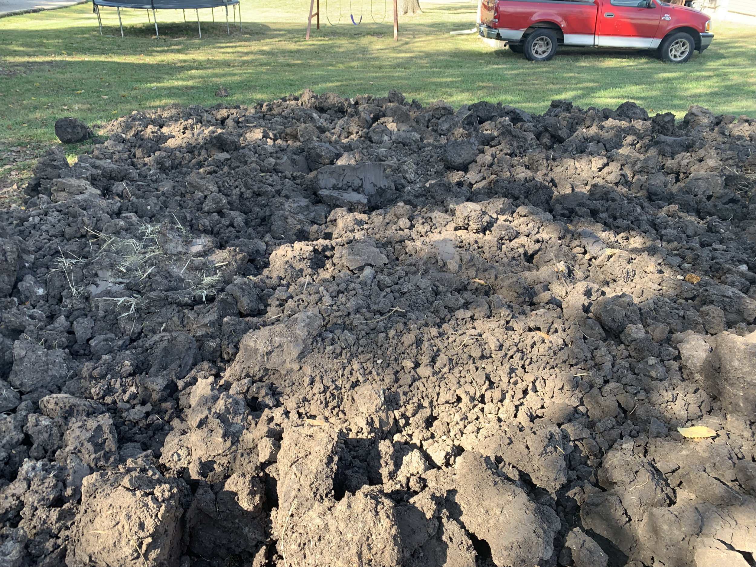

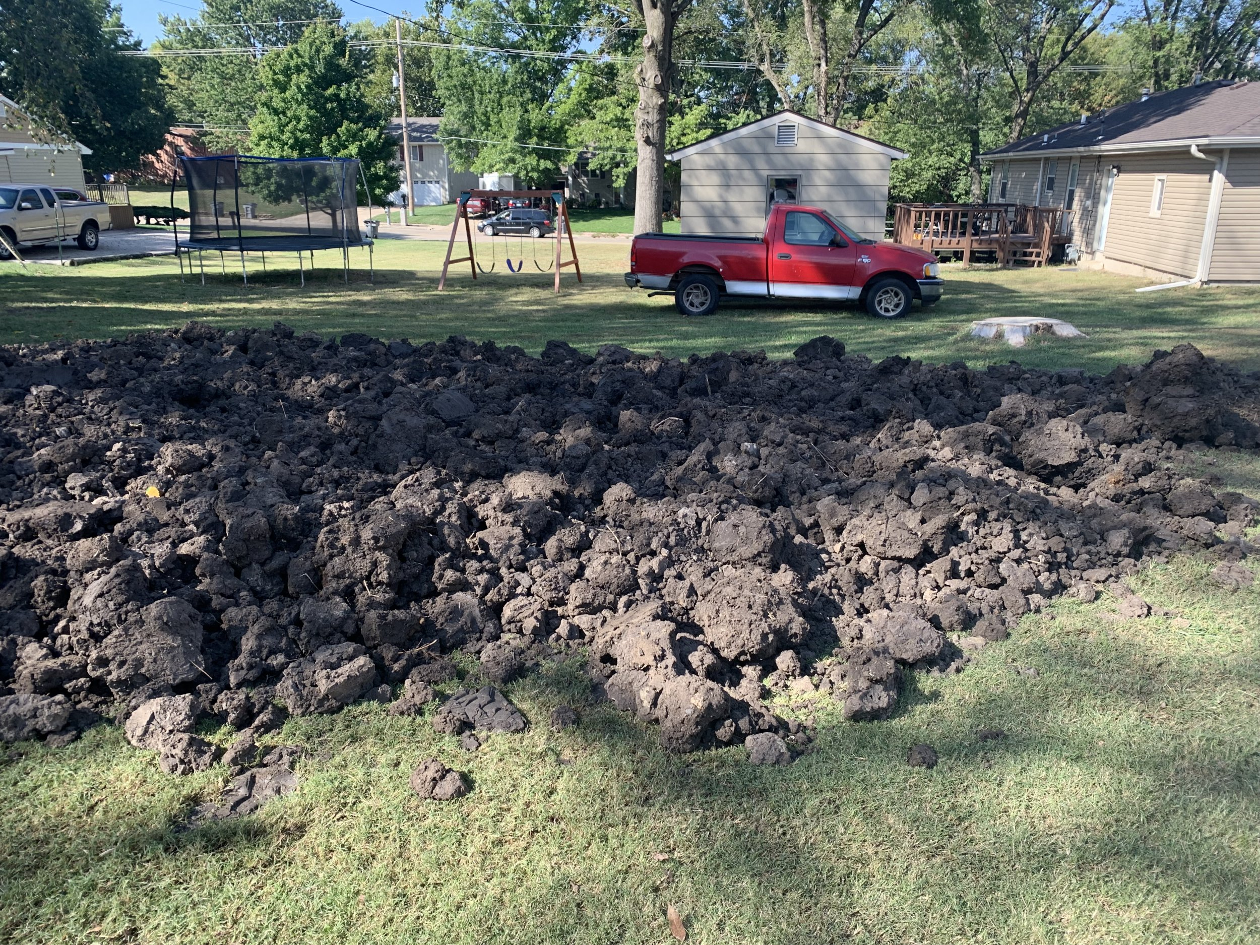

Is it ugly? Yes. For my application, it should be perfect. I’m using it to fix the drainage, around my house. After I get that graded out, I will put a liner over it and some nice white (is actually got multiple colors) rock over it. What I have left over I’m going to use to regrade parts of my yard where grass will be grown. The main focus, though, is around the house.
I finally had to just do it. I do dump trailer and tractor work commercially. Until now, every time I could get dirt I sold it. I’ve done drainage work at a lot of houses, but without the dirt, there is no job.

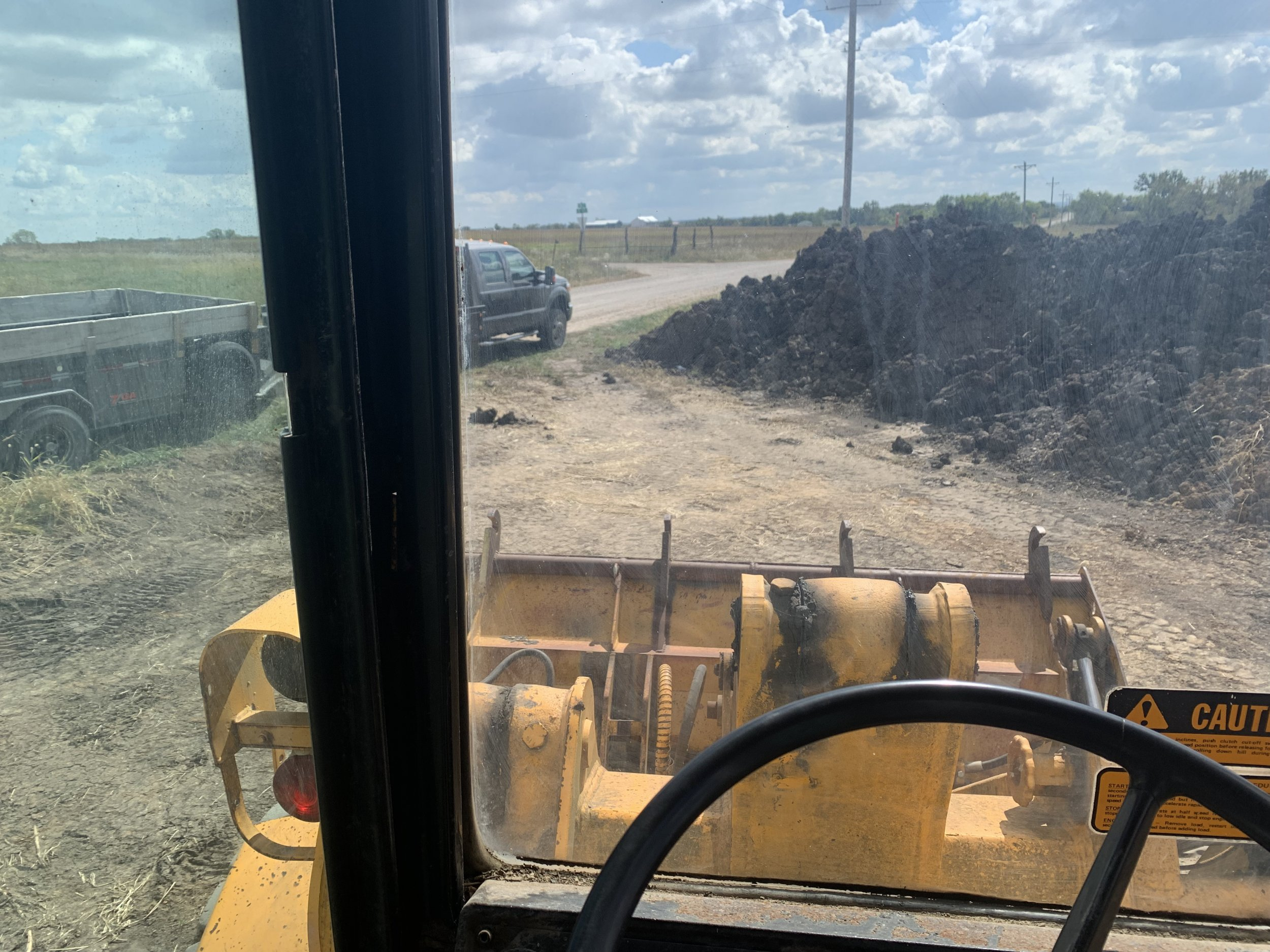

That looks like a good sized loader. I believe I'd have asked the operator if they could back drag off the pile, or get a few small bucket loads, then back drag with the bucket, breaking it up into more managable sized material you would be able to handle. If you would have offered an extra $10 to do that, more then likely they would have done it anyway, just for asking/offering.
The operator is an idiot who doesn’t know what he is doing. I was the operator. The loader was a John Deere 444C that has more hours on it than most of the parts have life. A few days prior to this, was my first time using it. It was also my first time in articulating equipment. Getting the dirt in my trailer and not breaking anything was all I hoped to accomplish.
