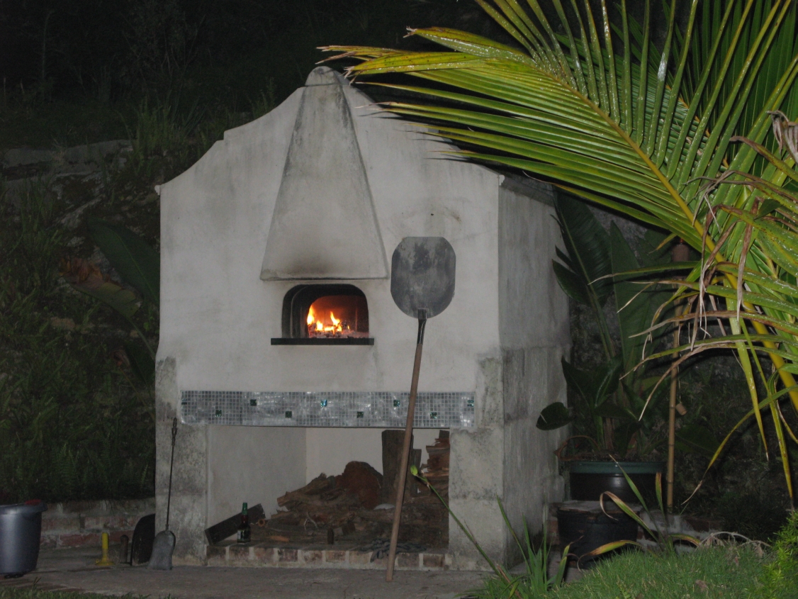

Hello Prokop,
Great job on your oven, it looks like it does what it is supposed to do!
I have also built one, but not entirely from scratch, as I used the kit from LePanyol.
Have you enclosed the dome yet? If not, are you planning on it? The cracks in the dome are only superficial as you probably already know, but over time could potentially allow water to penetrate into the oven interior.
I have attached a pic of my completed oven. Nothing tastes quite a good as food cooked the 'old-fashioned' way.
Dale

Dale, You oven looks great and nicely finished, congrats.
The pizza paddle you use is metal or wood? I have to admit, I never placed anything directly on the firebrick bottom, what is your experience?
The plan for the cracks is to seal them with cement and eventually put a roof over the whole area - like an outdoor living room, since I would much prefer the rain not to touch the oven.

Hi Prokop,
The paddle (aka peel) is stainless-steel with a wood handle.
The LePanyol ovens have food-grade clay 'tiles' on the base. For cooking pizza, once the oven as reached a high temp I move the remaining embers and fire over to the rear. I keep a small fire going to keep the temp up so that I don't have to use the door.
Traditionally, a clean mop or rag wrapped around a stick slightly damp with clean water is used to clean the ash from the cooking area. A little corn meal is sprinkled on the cooking surface and the pizza or bread can be placed directly on the oven floor. This method has not always worked for me when making pizza, but the challenges are more than likely due to my inexperience. Occasionally I will use a flat baking sheet or pizza pan to cook the pizza on, which eliminates any sticking of the pizza to the oven floor.
Until next,
Dale

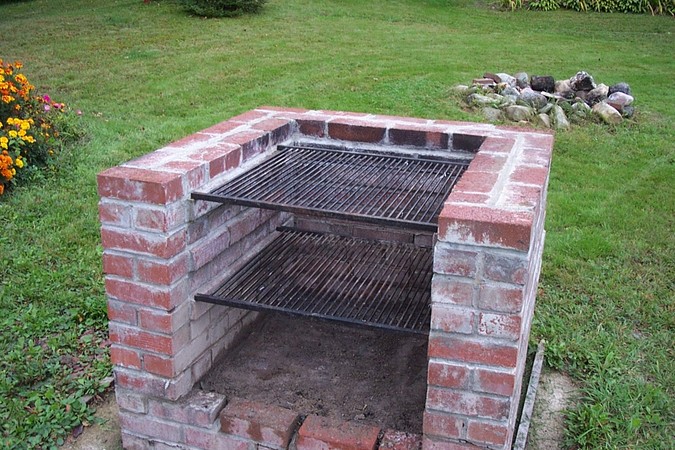

Dale
Good Mornin Dale,
Wow that is really nice !!! You guys are makin me awful jealous I dont have one ! ;)
BTW I did make an outdoor barbeque a few years back but nothing like what you guys have done !
