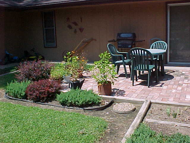

Doc, here is a pic of the patio that my wife built all by herself. used treated 4x4 to suround the bricks, drilled 1/2" holes and drove rebar 18" lond theough the 4x4 and into the ground, nothing has moved in over a year.
jim

I bet your wife is one of those women who thinks she can do anything she wants...and she's absolutely right!/w3tcompact/icons/shocked.gif Nice job!
