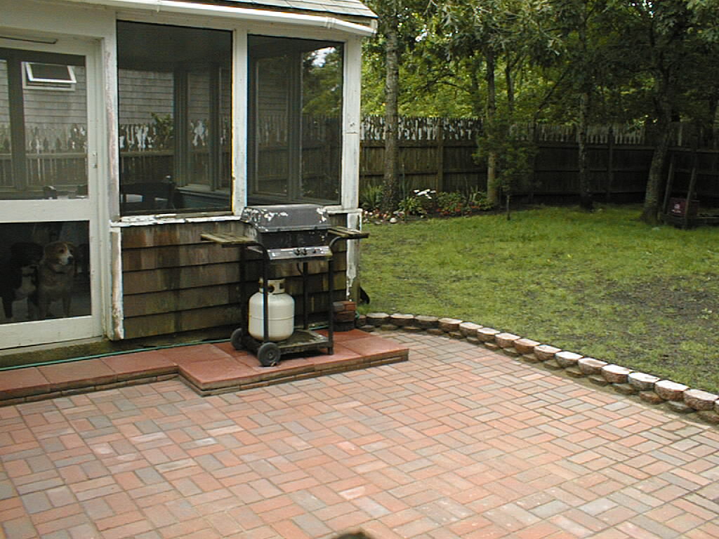

This is the patio we put in at our house at cape cod. We just used sand under it[that’s all we have SAND,] I was glad to see that it made it through the winter.

Looks nice! How long has it been in?

We put it in last spring. Used it all summer with no problem. We do not live there, it is just a summer home, and so we did not know how it would look come spring, after its first winter. No problem. Looked good as new. I thought for shore that there would be some heaving. I guess all that sand is good for something, water just drains out. No water= no frost heaves.
