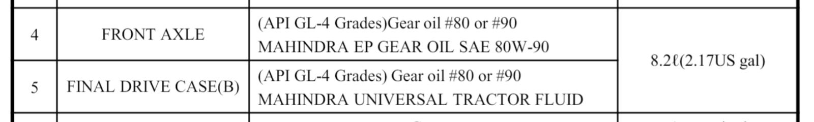

In my manual, it has the final drives and the front axle sort of together. See attached photo
So am I right to understand the final drive cases are the boxes right by the wheels people talk about making sure are filled up? But I also think they get the oil from and fill at the same point as the front axle?
So it lists the Hydraulic fluid and Gear oil as an option.
Or am I WAY off and these are two totally separate systems?
If they are 1 system basically, then I would go hydraulic fluid for the cold months with everything.
As far as plowing in the cold weather, I will have to test it out and see how the temperatures hold, might have to block some parts off if it can't keep warm on it's own.
Thanks in advance.

The final drives are on the axle ends and are tied to the axle fluid. The fluid flows down the axle tubes, across the ring and pinion gears and into the final drives. Their should be drain plugs (bolts?) on both final drives and the axle housing itself. Mine also has a plug that sets full level- this is in the final drive. I fill into the axle and stop when fluid comes out the plug mentioned above.
I get the diligence but this axle will be just fine with about anything. No need to fret over it!

Thanks for the explanation, I thought that was pretty much how it worked. I am just worried the first time I do anything like this and don't want to mess it up. I am going to go for some hydraulic fluid to replace it all.
